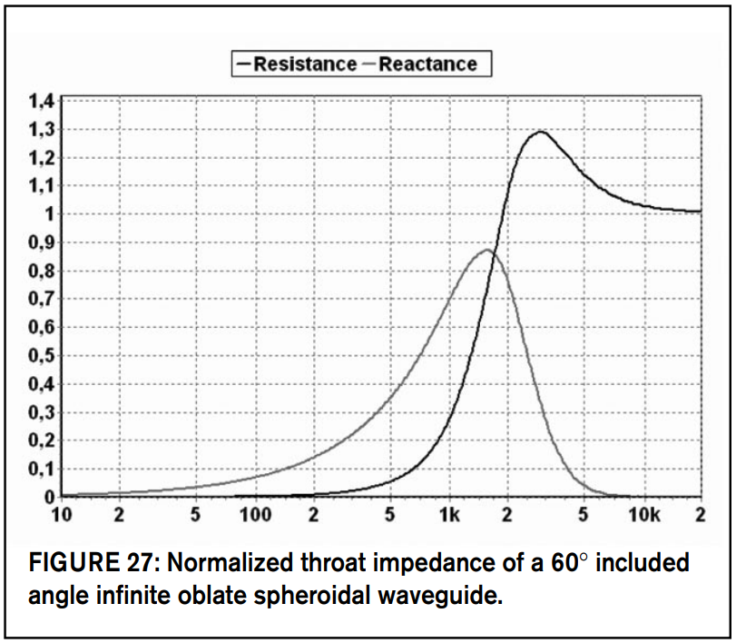

To quote Bjørn Kolbrek:
"The OS waveguide does not have a sharp cutoff like the exponential or hyperbolic horns, but it is useful to be able to predict at what frequency the throat impedance of the waveguide becomes too low to be useful. If you set this frequency at the point where the throat resistance is 0.2 times its asymptotic value, so that the meaning of the cutoff frequency becomes similar to the meaning of the term as used with exponential horns."
You 'could' use an OSWG in '(mass) reactive mode' and push the driver below its comfort zone, but it won't sound particularly nice and you risk frying 'phrams at higher SPL, as Geddes found out when some of his speakers were used in a club.
No, again you're trying to make this about driver excursion.
I'm talking about the waveguide alone used down through the reactive region. No driver limitations. What does it sound like?

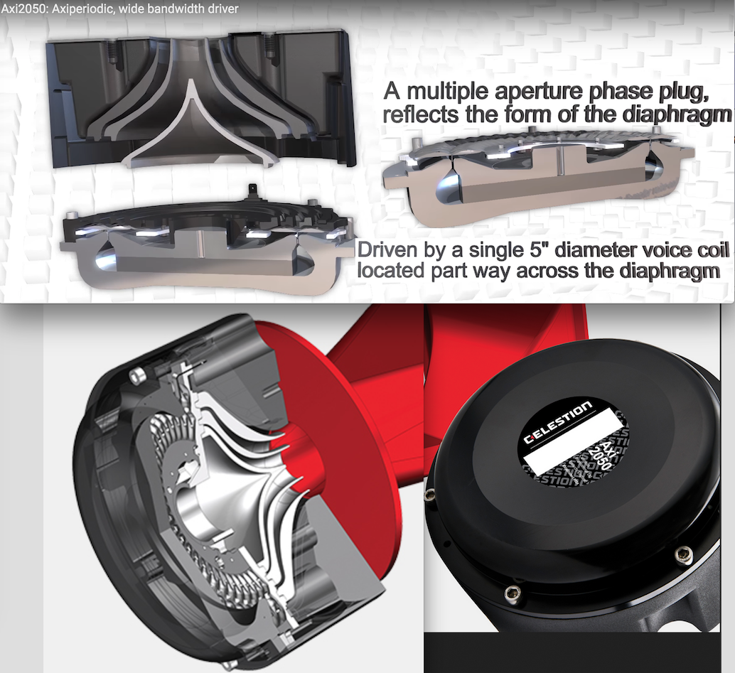

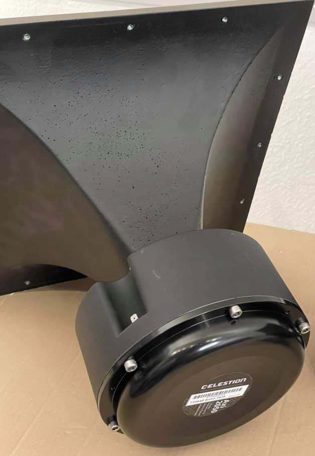

Of course, with a powerful driver, e.g. the Axi2050, an OSWG could also be crossed lower, but still not as low as with a classic horn.

Here's an example of someone who swapped the BMS 4592ND for the Axi2050, actively crossed at 300 Hz, but using the BD-Design Oris horns (150 Hz cutoff).
You could get away with a huge OSWG (40 or 60° included angle) and the same XO, but I doubt it would yield satisfactory results.

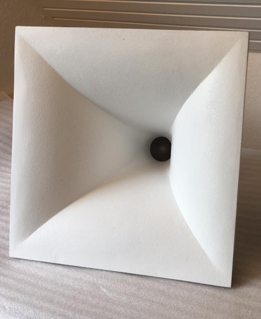

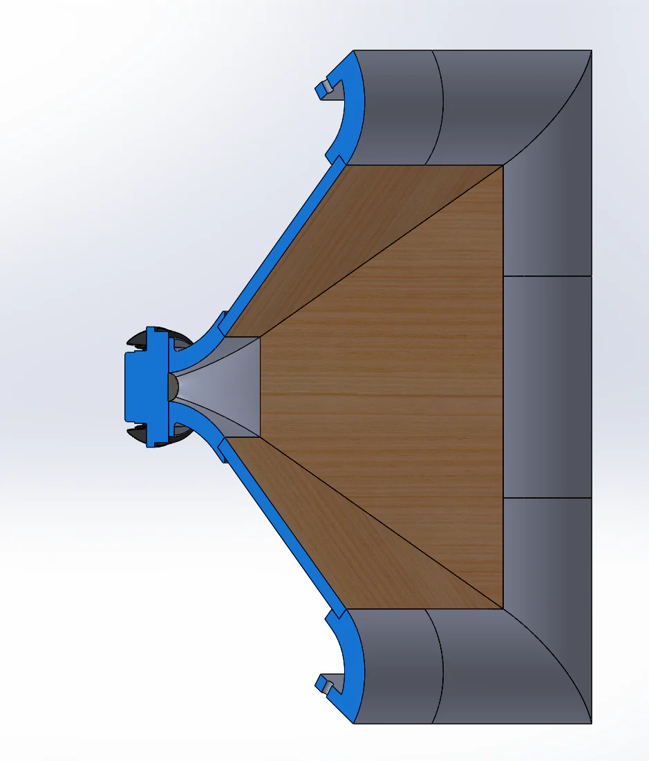

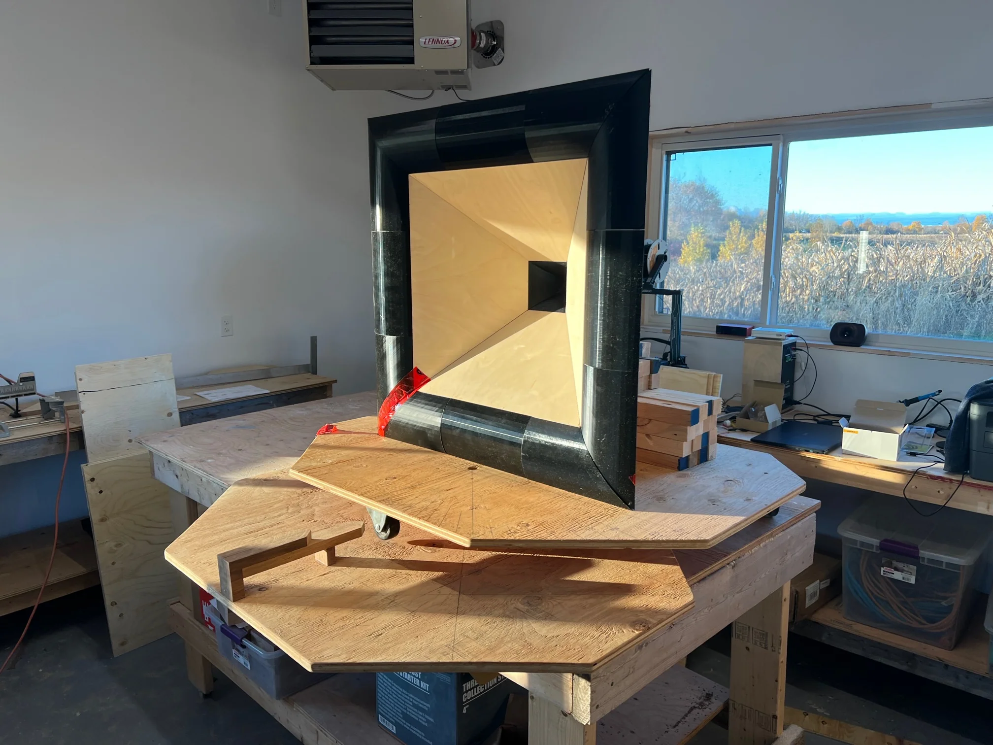

Troy Crowe designed a large OSWG.
Specification
" The idea is to provide a large format oblate spheroidal horn flare which is characterized as a conical horn with a smooth throat transition.
Design Goals

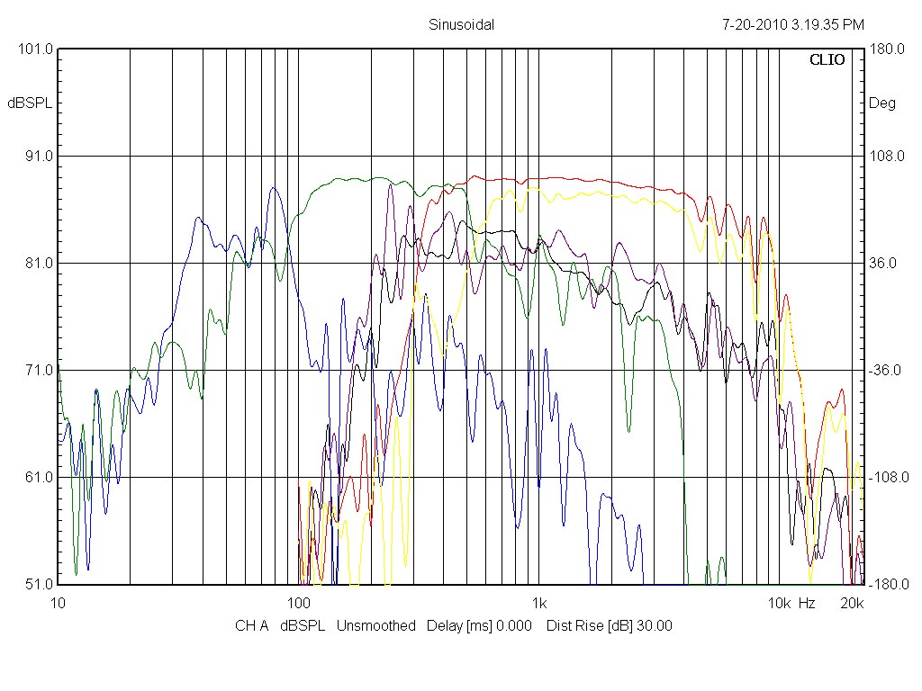

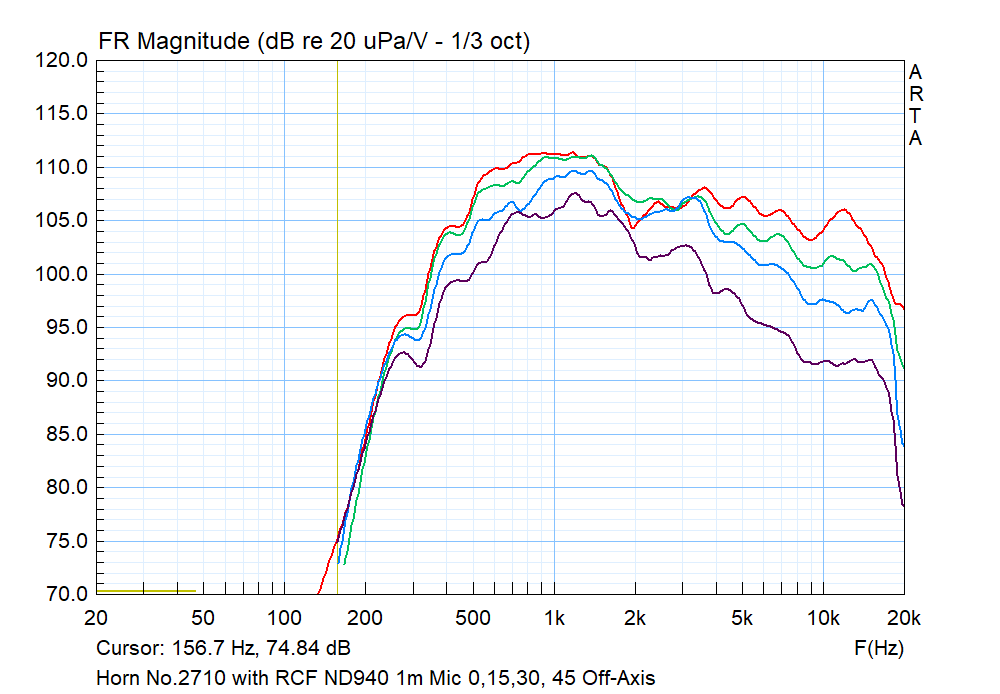

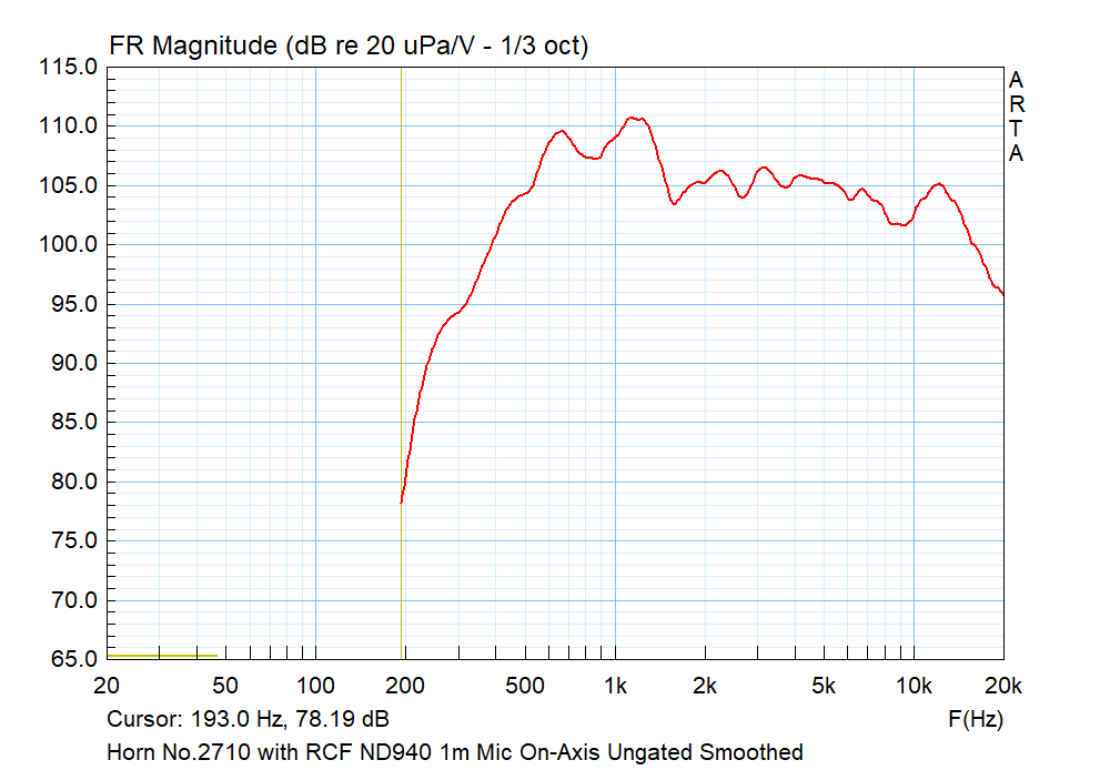

By moving the mic away to 1m, removing the gate, and applying some smoothing,
we get a better sense on what happens near the cutoff frequency of the horn:
Response at 0,15,30, & 45 degrees off-axis:

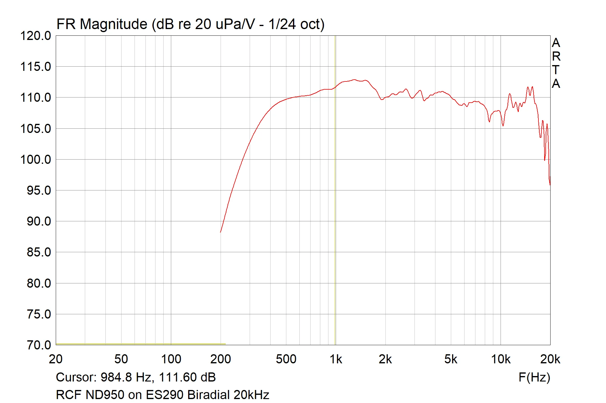

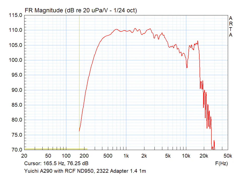

Below is the response of the Yuichi A290 with the RCF ND940/950.
Please note that the ND940 is simply the ND950 with the conical adapter removed. So we are using the same driver between tests:
For additional comparison data I've shown the ES-290 biradial with the same RCF compression driver:"
Considering the 35cm depth it's respectable, but the loading characteristics are certainly not in the same ballpark as the Yuichi, let alone the Oris horn.
600 Hz seems to be the lowest usable frequency.
But this should come as no surprise.
Specification
- Horn mouth 85cm x 85cm (with mouth flares)
- Horn mouth 58cm x 58cm (without flares)
- Cutoff Frequency 300Hz (Fc)
- Coverage 90 degrees.
Design Goals
- Easy to construct for DIY enthusiasts
- Horn throat can be 3D printed
- Horn petals are easy to construct especially compared to the Sabourin horn which consists of three flare segments. This Oblate Spheroidal (OS) consists of a single horn flare segment.
- The horn mouth flares are optional (see test data to compare with and without mouth flare pieces)
- Suitable for home theater, home hifi, and PA applications
- Provides constant directivity for use in PA
- Attempts low coloration sound
- Most Constant Directivity (CD) horns have high coloration due to abrupt physical horn flare geometry
- Provide reasonable falling response
- Most CD horns have significant falling response requiring EQ to flatten. This raises distortion in the treble region since the driver is having to work hard to reproduce those frequencies compared to an exponential horn flare.
View attachment 1430624View attachment 1430625
Specification
Design Goals
Troy's own conclusion:
"While the horn sounded dynamic, intelligible, and coherent, it lacked the last little bit of clarity I've come to expect. This limitation reduced overall soundstage depth and smoothness, having some mild horn coloration. As a result the 2710 horn is perfectly suitable for PA applications or for home theater applications where dynamics and intelligibly are of primary concern. I would not use the 2710 horn in two channel music applications."
"This limitation reduced overall soundstage depth and smoothness, having some mild horn coloration."

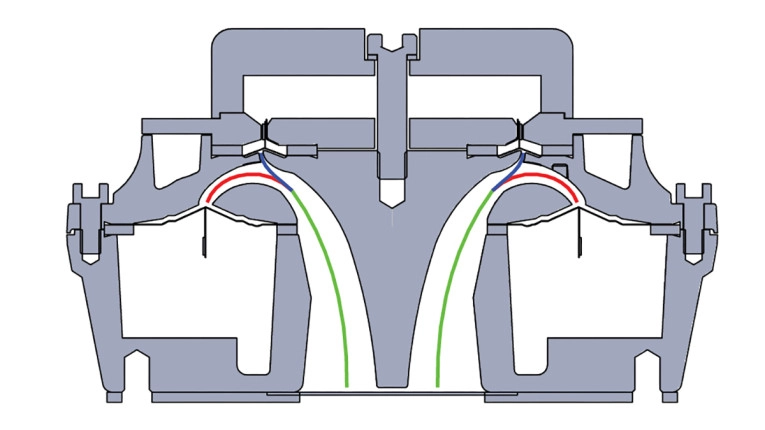

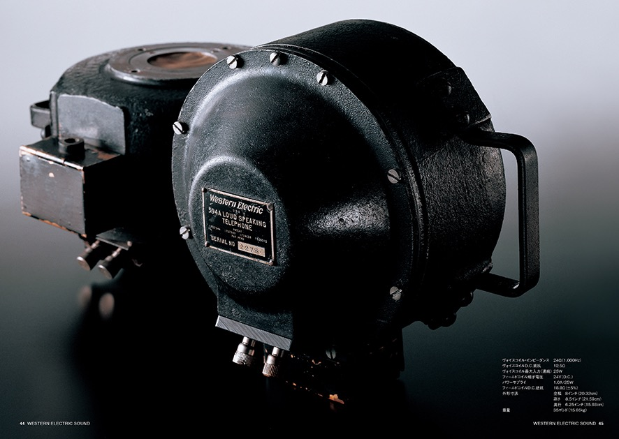

The Western Electric 555W is generally considered the first high frequency compression driver, it used a 3.3" (84mm) dome diaphragm with a phase plug using four annular rings in 1926.
Most HF compression drivers still use very similar phase plug designs.

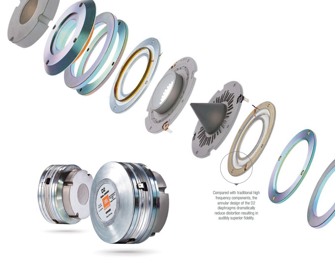

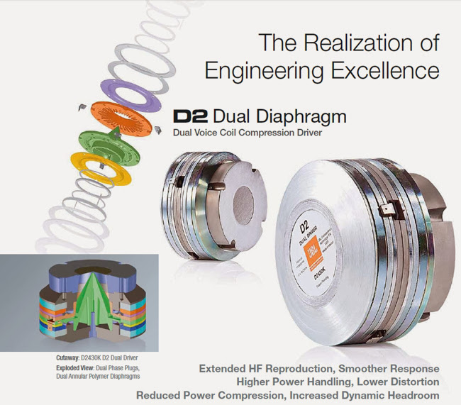

About 29 years later, JBL released the annular diaphragm ("ring radiator") 075 "bullet tweeter" in 1955, 70 years ago.
The tiny annular diaphragms of the 075 (or 2402, 2404, 2405 etc.) could "get by" with a single annular ring phase plug/horn.
Larger annular ring diaphragms with diaphragm area (Sd) approaching a 3" or 4" dome diaphragm may use two annular rings in the as in the BMS4592:
or three annular rings in the more recent Celestion Axi2050:
Anyway, the "30% more modern by age" annular diaphragms do have the advantage of requiring less of a span for the diaphragm material, but require two suspensions rather than one for a dome.
As usual, there are trade-offs in every design choice.

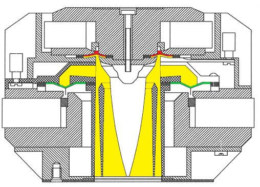

Tbh 'm not fond of annular diaphragms in general - this applies to tweeters and compression drivers.

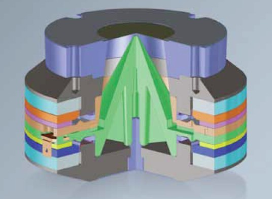

Inner workings of the 4592ND:
The channels in the B&C DCX354 seem to be optimized:

BMS uses 45 degree high frequency mirrors that reflect HF at 90 degree angles.The channels in the B&C DCX354 seem to be optimized:
B&C just tries to bend sound but sound is a wave not a metal rod. It doesn't bend - it reflects.
JBL has got it right with D2 in my opinion. But they just wire both voice coils in parallel ( or is it series ? ) They should have made it with a crossover like the others.
It is a push-push (cancellation) design, which can be connected in parallel or series:
- Series VC: 104 db on the M2 horn
- Parallel VC: 110 db on M2 horn.
It's an advanced driver, albeit very expensive, quite fragile and almost impossible to repair.
