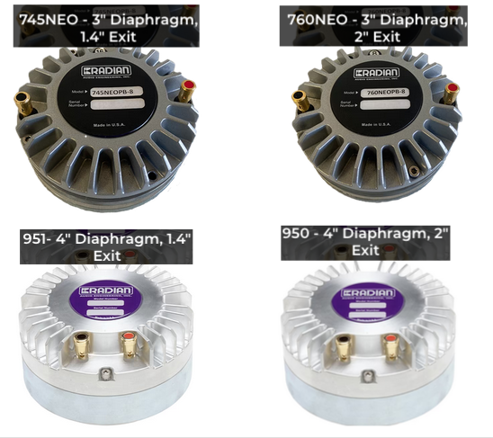

But I learned today that his Radians are the 950Be , so the larger 2" diaphragms (and maybe also the 4" voice coil??) likely account for the immensity of the 3D sound stage he raves about.
The 950 has a 2" diameter throat exit, and a 4" dome shaped diaphragm with a 4" voice coil.
The 745, 760, and 850 all use a 2" diameter throat exit, and a 3" dome shaped diaphragm with a 4" voice coil.
Be has better HF response than aluminum or titanium, so could improve sound stage detail by comparison.
The larger diaphragm is capable of more clean low frequency output than the smaller, but worse HF response.

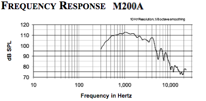

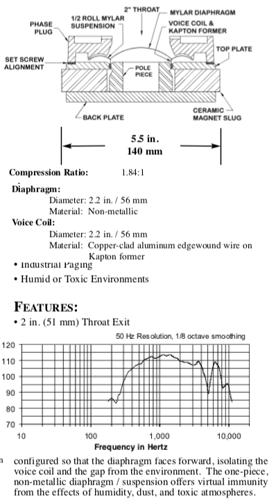

Alternatively, if I was going three-way in a biradial horn, how would that Community M200 midrange compare with the B&C DCM50?
The Community M200 has a 2" diameter throat exit, and a much smaller 2" dome shaped diaphragm with a 2" voice coil.
It has no phase plug, and it's compression ratio is only 1.84 /1, typical compression drivers have ratios more like 10/1.
Having no phase plug limiting excursion, and a much larger suspension, it's excursion can be greater than a typical 2" dome diaphragm high frequency compression driver.
The lack of phase plug creates a -20dB 2/3 octave wide cancellation dip centered at 5kHz, ~4kHz is its usable "Hi-Fi" limit.

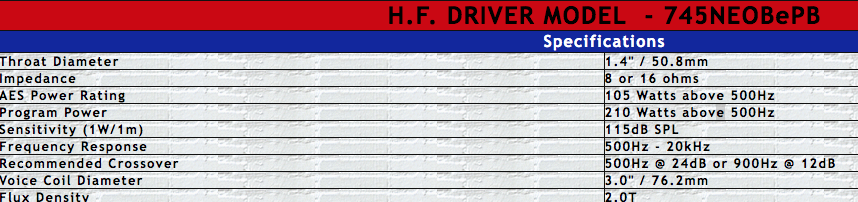

According to these specs the 745Be has a 1.4" diaphragm and a 3" voice coil. https://www.usspeaker.com/radian 745neoBepb-1.htm
No, it says the throat (the part that connects to the horn) diameter is 1.4", it's 3" dome diaphragm is surrounded by a 3" voice coil.
Generally, one chooses a driver horn that matches the horn's throat diameter to avoid using throat adapters.
The driver's throat diameter won't describe what is behind the throat any more than a car tire rim size determines the tire diameter or how the tire might handle with a particular suspension.

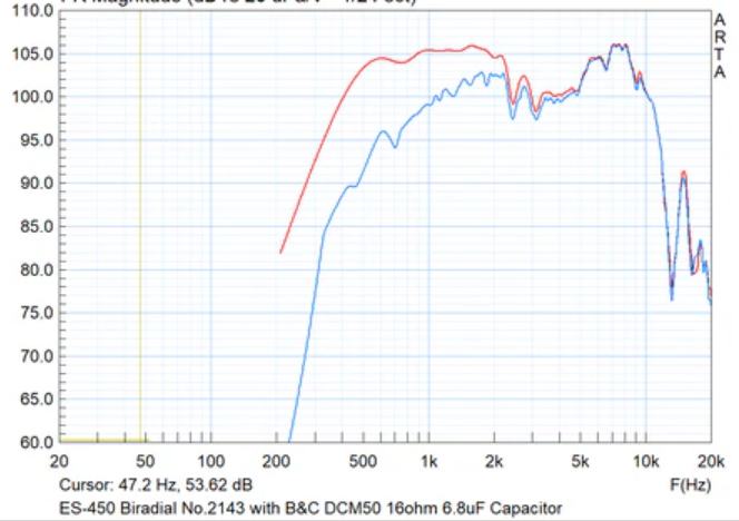

The DCM50 can be used almost an octave higher than the M200.
Pooh here referred to the Community M200A. How different is it from the M200, which Biamp told me today is still in production?
The M200A still dies at 4kHz, but response above is more attenuated than the M200, simplifying the filters required crossing over to a tweeter.
Without filters, the reduction of the 7kHz peak would make it sound a bit more "dull" when used as a paging (public address) driver.

Regarding driver tonality, how much or in what way does "voicing" (?? what kind of EQ filter animal is that??) impact the sound of a driver in a system compared to its diaphragm material, structural design and/or Theil/Small parameters? And can voicing just as successfully be implemented via a Windows software plugin versus a hardware wired passive or active filter?
How much would this be an example of voicing: When Troy added that 6.8uf cap in the signal path (across the power amp inputs?) to change the response of the and somehow also the tonality of DCM50? https://josephcrowe.com/blogs/news/es-450-biradial-no-2143
Diaphragm materials and phase plug designs are a "means to an end".
T/S parameters are a measurement of the driver.
Only sweeping generalities can be made as to the impact of each aspect of design.
"Voicing" is a general trend of upward, flat or downward on axis response.
The filters used to voice depend on the corrections the horn and driver require, and what is possible to do- a passive approach could use 30 pounds of components to do what a postage stamp sized chip could do.
With the same "voicing" achieved with EQ , either passive, active analog or digital filters, any driver that covers the bandwidth without gross problems can be made to sound nearly the same.
You can listen to a wide variety of drivers "voiced" the same in this evaluation, the HF is a recording of the horn driver mixed with the original signal below the crossover point.
Best to use headphones to eliminate the room response.
The capacitor is simply put in series with the "+" or "-" terminal of the driver, a passive "single pole" filter.
With:without Cap.png
The capacitor reduced output by -10dB, half as loud as the red raw response from 600Hz and below, tapering off to no change in the upper response.
That single pole filter results in an upward rising voicing, which might be called "forward". If the curve looked the opposite, "relaxed".
To address the upper peaks to provide a "flat" voicing would require another four poles or so.
On a horn/ driver combination like your AH425/Radian which has smoother response, a simple cap on the HF and coil on the LF might get it near flat.
A "hardwired" passive or active filter implements only one choice in voicing (equalization).
DSP (digital signal processing) is just manipulation of binary code, the operating system used to manipulate it does not affect the end result.
If DSP is used in series with a simple crossover, any voicing can be achieved, and instant changes can be recalled to suit the program material, when, where and how you are listening.
