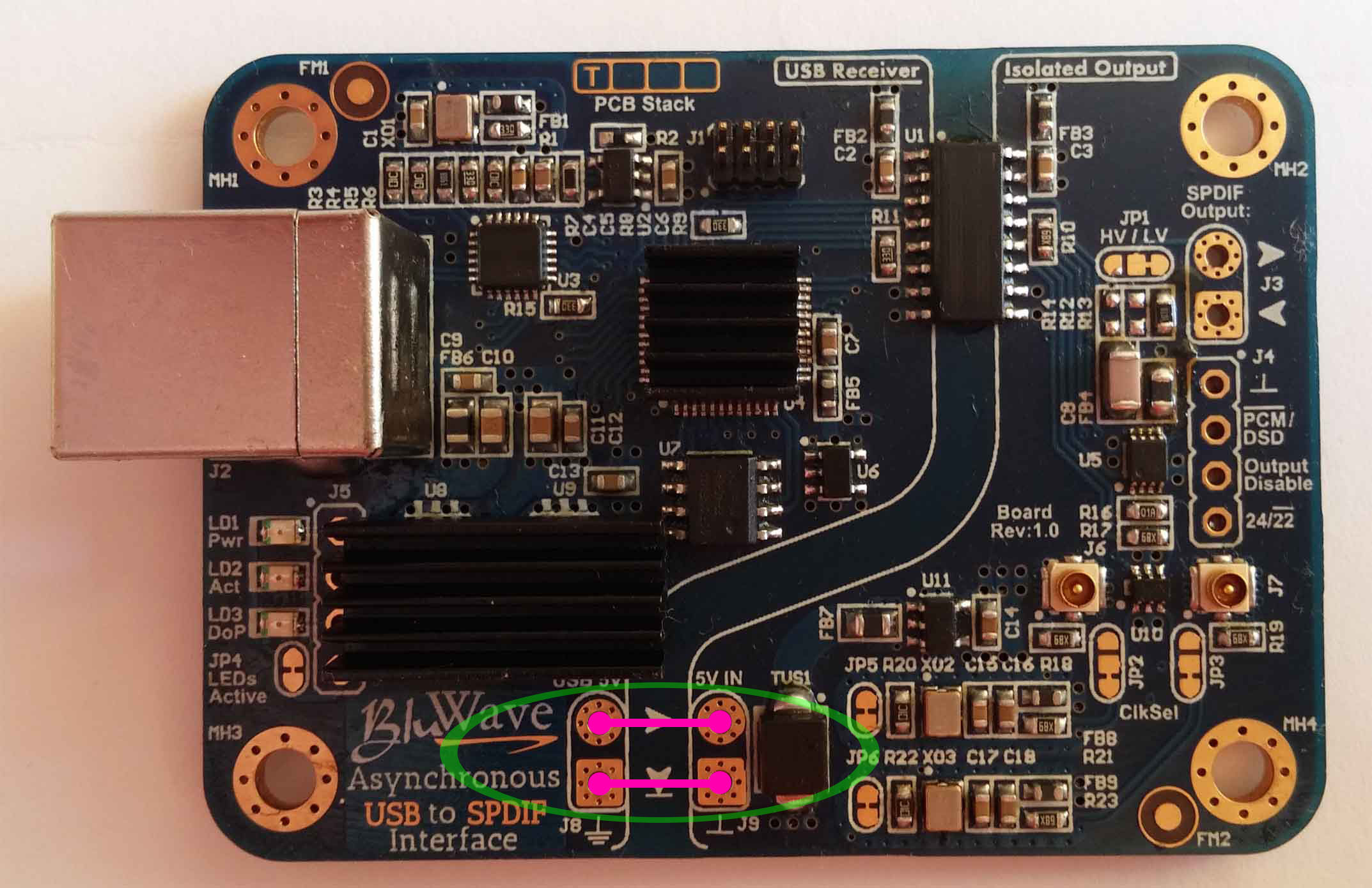

@ Northernwind:
For testing purposes, it would be nice to exclude that external PSU and join J8 and J9 together as you see in attached image.
I know this will defeat isolation but, as I said, it's for testing purposes! The gal is to have a clear, common ground with the USB path and see if the pops and clicks does still appear!
One side note (especially for Christoph): if you want to do this please remove any Earth or any other connections other than GND and active signals which can damage your BluWave board.

Have to correct that: Of course it were 264uA, not mA.When I measured ground pin of J8 against protection earth I noticed 264mA.
Lucian,
I listened now with bridged power as described above for about an hour now and had no noise at all.

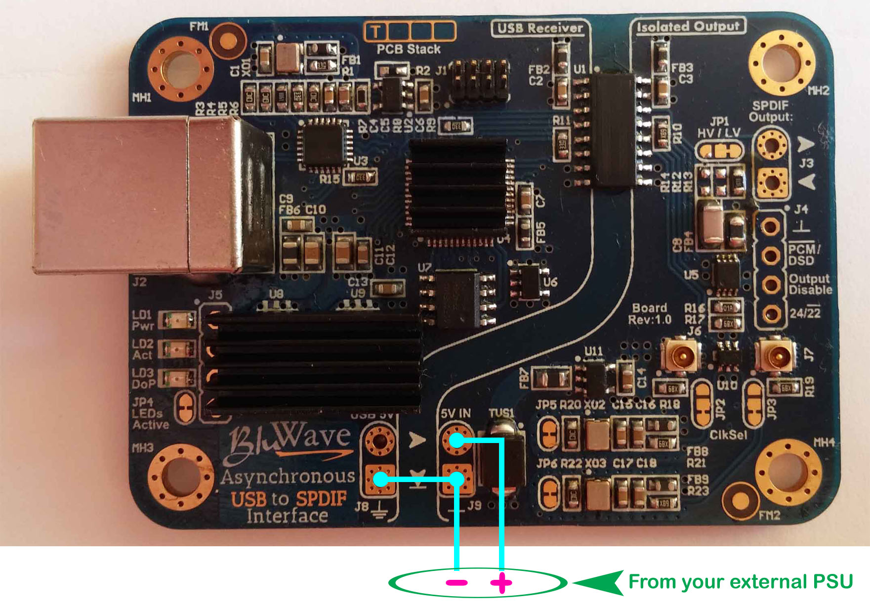

Hello Christoph,
thank you very much for helping me with this issue! So far so good! Now, can I ask you to do one more thing on your side? I wish you to remove the wire between rounded pads of J8 and J9 and power your BluWave from your external PSU but keeping the common ground with the USB side. Basically you should remove the wire between the rounded pads of J8 <=> J9 and connect the positive rail of your external PSU to rounded pad of J9. Leave the wire between square pads as it is right now. I attached a picture to clearly show you what should be done.
The goal is to keep common ground with the USB receiver while switching the power rail for the output side of BluWave.

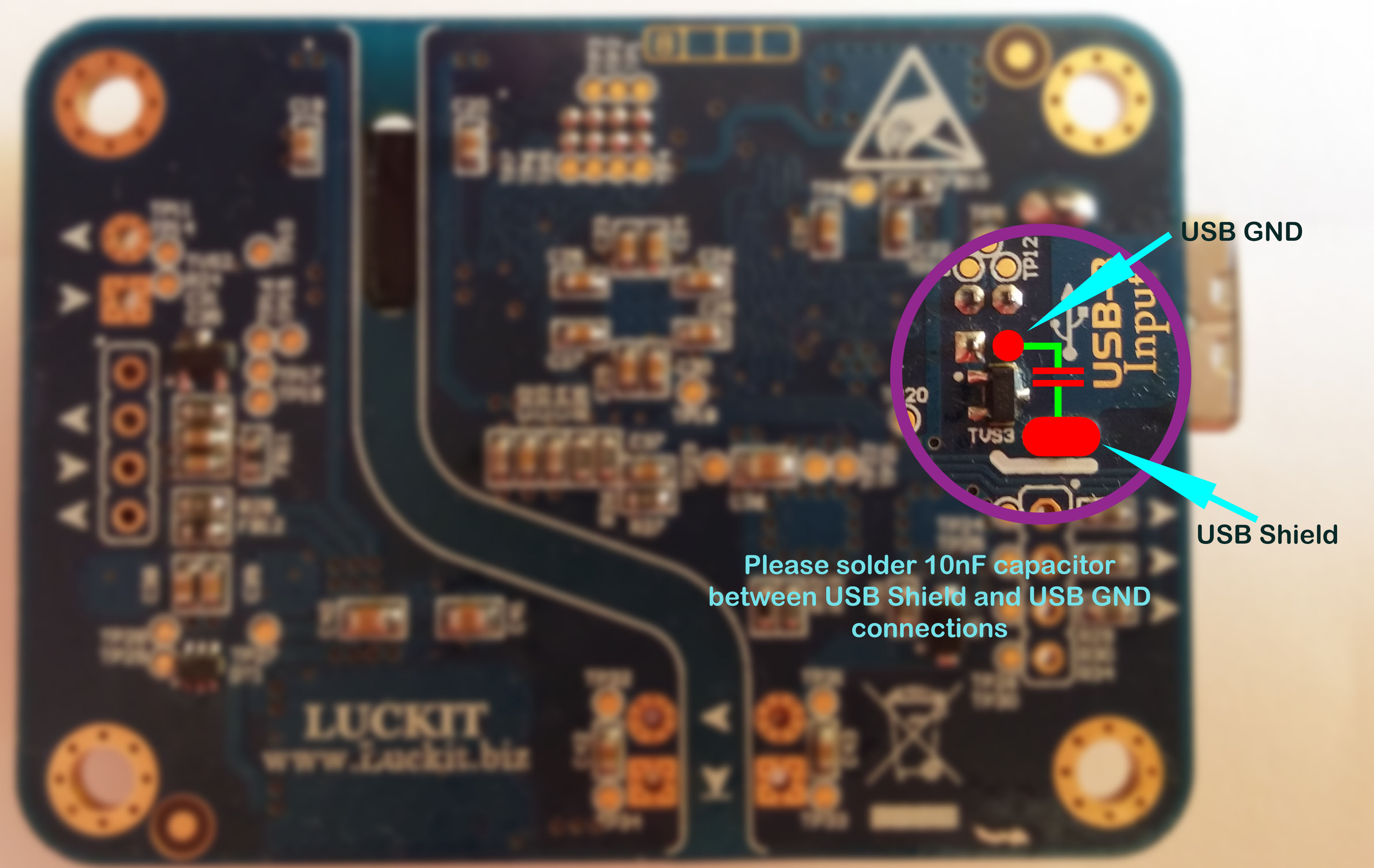

With help from taggart2 (Christoph), I managed to dig in more into the popping and clicking issue. Sadly, so far I don't have any clear solution to this since the power bridging option does not always work on his side! Sometimes there are no pops at all while other times there are some.
So, comparing with WaveIO USB input side, BluWave does not have the USB Shield connection tied to main USB ground by any means! That's because I wanted to offer a board having as less noise as possible, I decided to keep the USB shield connection away - well, it's connected to USB GND through a TVS protection diode. Either way, I asked Christoph to add a 10nF film cap between USB shield and USB ground connections.
On WaveIO there was a 10n/0603 (imperial) cap || FB of 330R @ 100MHz but here I would like to start only with the cap and them move on with FB or high value resistor.
Sadly I would choose the safest path on this but searching over interned does not bring me any clear solution - it seems that almost any manufacturer does adopt its own way in solving this USB shielding problem.
So, my request to those who have pops and clocking noises is to find a 10nF cap (value is not critical) and solder it between the USB Shield and USB GND points as it's show in attached picture.
