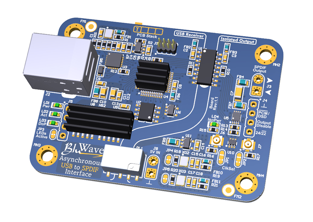

I didn't forget about firmware, I just really want to finish the new PCB for BluWave and give it a go. I'm already preparing all the technical stuff needed for PCB manufacturer hoping it will be done in this evening.
For all those interested, the 3D picture (TOP side) of the new BluWave is attached to this post.

Hello Carsten,
as it can be seen in my early post, I made a couple of small improvements to this board but nothing "special" or "mandatory" which your board should have.
The main reason for this small HW change was to add that relay which simply makes my life easier when it comes to testing boards. Not to mention that it will (hopefully) solve the startup problem when the SPDIF side is not powered and you are plugging in your BluWave into USB port... as been reported occasionally.
The rest of changes are rather minimal:
* one USB filter on data lines (since I put my eyes on it and wanted to do it for some time now)
* couple of additional resistors for LEDs on the board, including the 4-th green LED on the SPDIF side (to see if it's properly powered)
* small stability improvement for the XMOS processor (also I wanted to be there).
* and I have remove a couple of parts from the SPDIF output side which didn't worked as expected.
I'm sure that most of above changes can be implemented in your HW as well! For example, you can add your own LED on SPDIF power if you feel to do so. In addition, that USB filter might exist or not on your setup. If your BW can work without it then just ignore that filter.
If you want, for the relay I'll give you a small schematic which you can use to implement on your own board. Sadly you have to solder a couple of wires + parts off the board (due to limited PCB space on BluWave).
