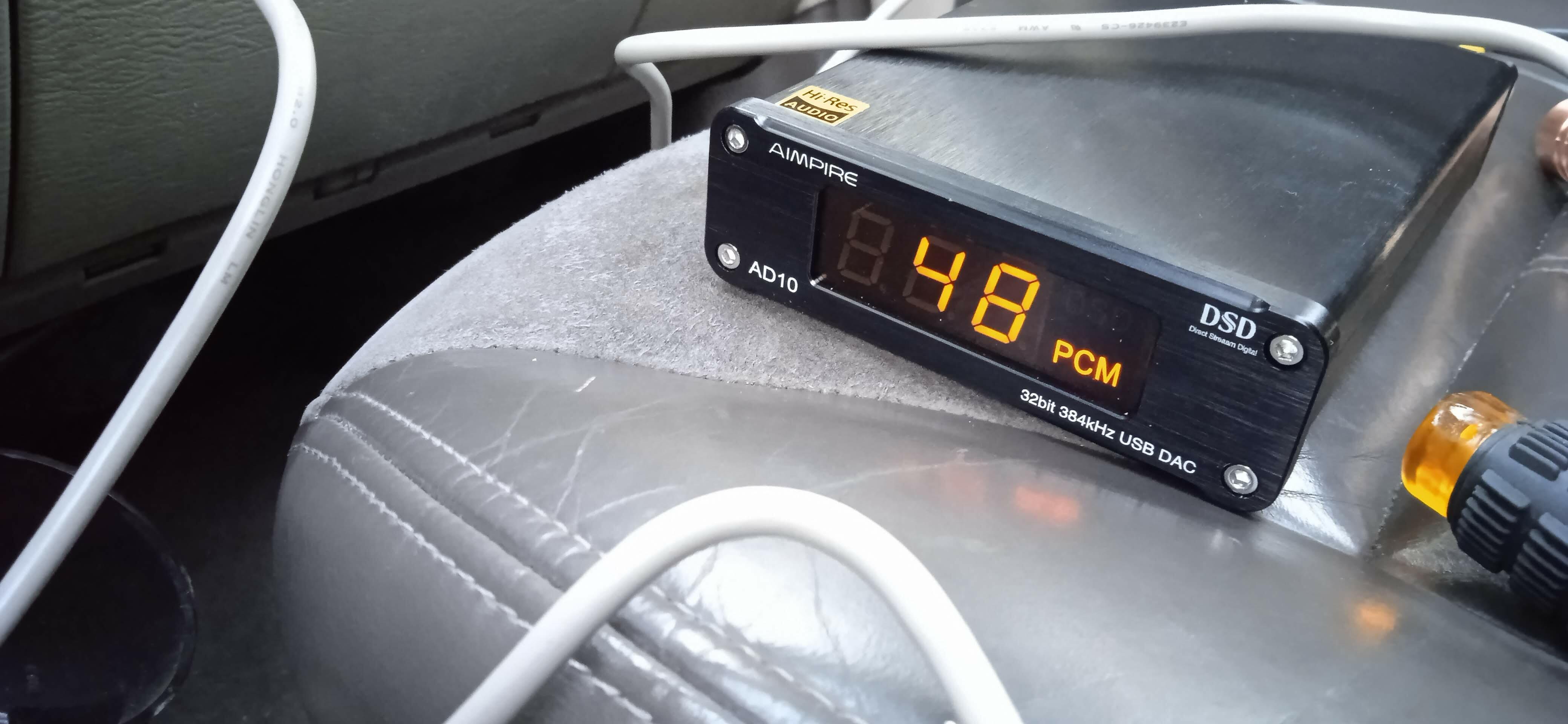

So last night I broke out my USB DAC (Topping Clone) and tried it out. Hooked up the USB to the Redmi 9c, no dice. Then tried my chromebook. WORKS PERFECT! SO on to do testing.
Its been the most quiet and noise free of all of them. With the Chromebooks audio output sounding a bit more airy, and musical, but the topping is dead nuts silent. No hiss, no noise. Its just the music and nothing BUT the music.
It seems it would work better with another amp as the amp I am using is more suited to the lower voltage level of my chromebook and the Android Chinese audio touchscreen i have that can't even DRIVE the thing! LOL.

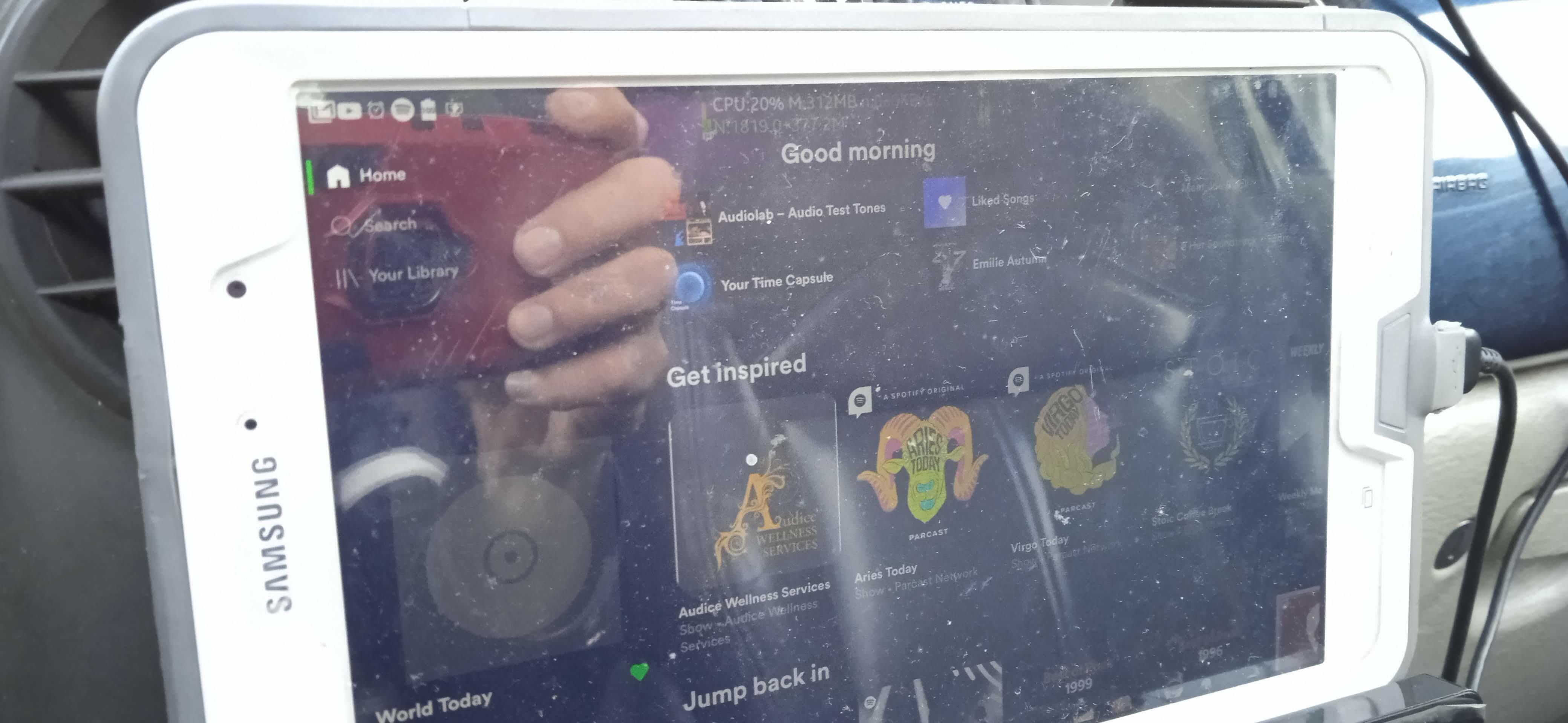

Anyways, also tried with my Samsung Tab PROs (SM-320) Wonderful! Works great! Running it with the USB power supply and Samsung OTG Adapter. Getting 48 Khz PCM out of it. So far very impressed. Sounds better IMO then from the chromebook with the USB DAC.

Photos of setup of the Ampire (Topping CLone USB Dac)

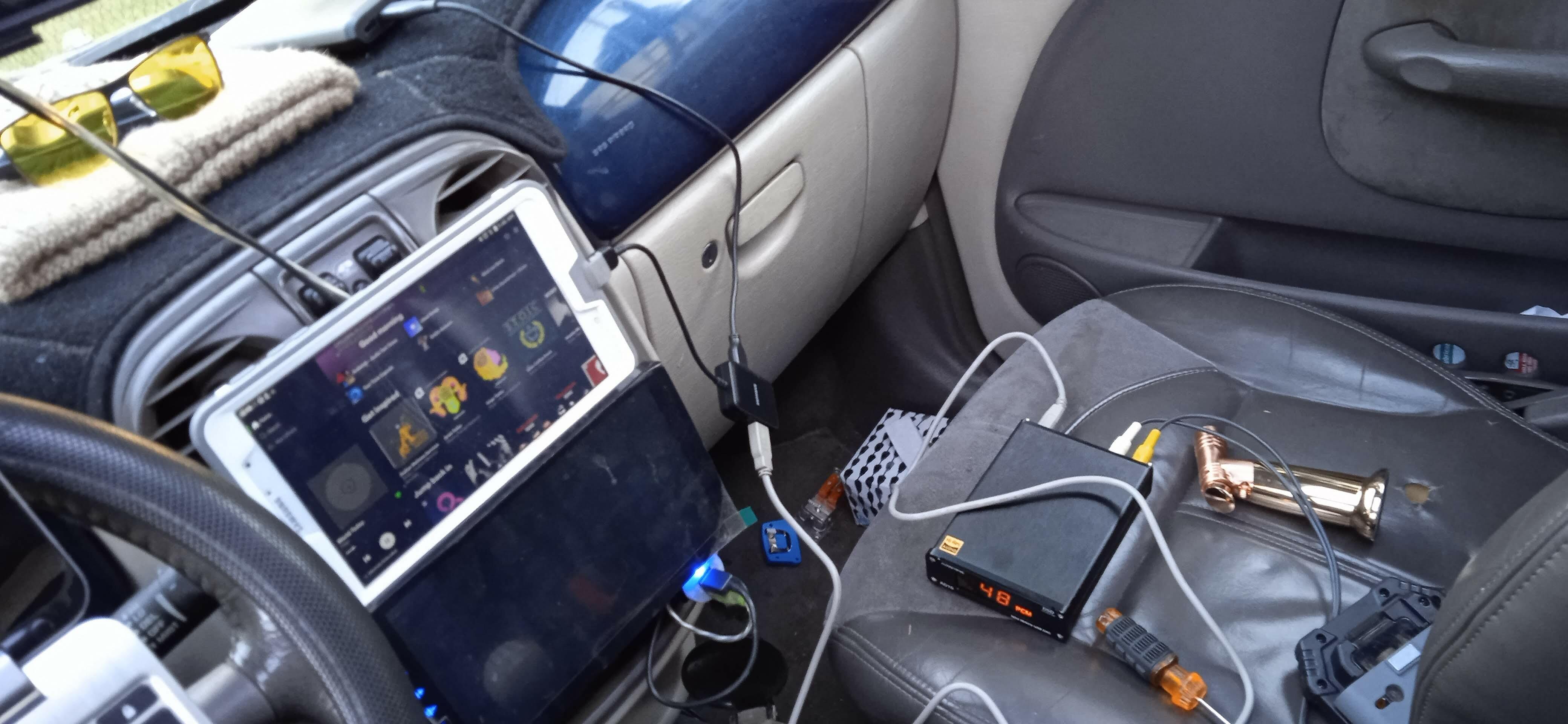

This is the Power supply I am using to run the Tablet and the Power Hungry Topping Dac.
SM 320 Samsung TabPro. The DAC just worked plug & Play!
Amazon DAC AMPIRE unit. Hey, it was Open Box, it was less then $30 bucks, I got it OKAY! LOL! Really the first time I am really using it. Been in the box for over a year.
TEMP SET UP! TEMP! I am TESTING!

So as of now, I think I got the Ampire (Topping CLone it seems) Working VERY WELL!
No drops or anything with the Samsung OTG Adaptor and Powered by the USB power brick.
Thinking right now to just run the Tablet Headless. So More USB Ports and some more cabling to do. But I think at this point? Man, I'm just about ready to throw in something active, but I am really enjoying the set up right now. Still? It would be nice to just find a Simple Bluetooth Dac until I really get all serious and drop the Dynaudio 3 inch mids and and match it with some G & R tweeters.
Its pretty loud. Sounds like a Live band when I park out in the Industrial area, and doing the sweeps from the DAC, Audio Tool can see all the frequencies all the way to 19 Khz. Really cool! I can BARELY hear them. But whatever.

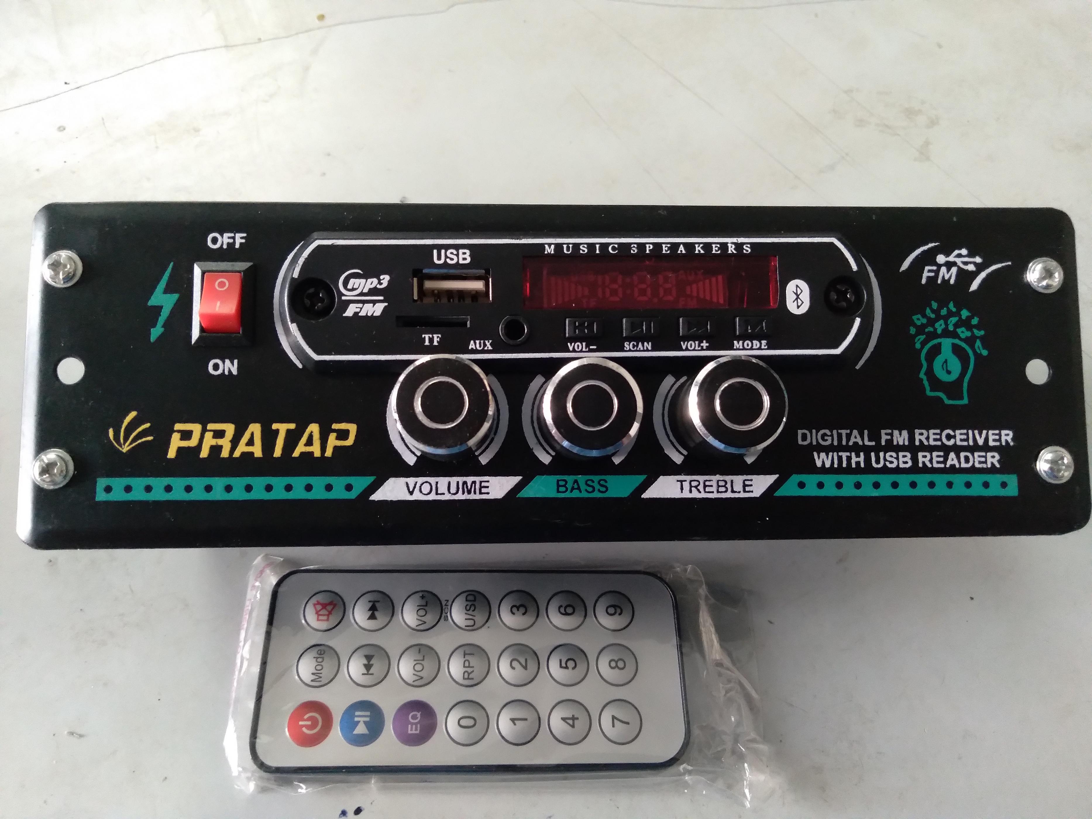

$5.00
Includes Amplifier...with remote, 20 watts per channel, though I would not expect more than 10.
Enough in a closed car.
More expensive versions up to $15 or so.
Frankly, CD are no longer used, and this even has aux in in front. And can use memory cards and sticks.
