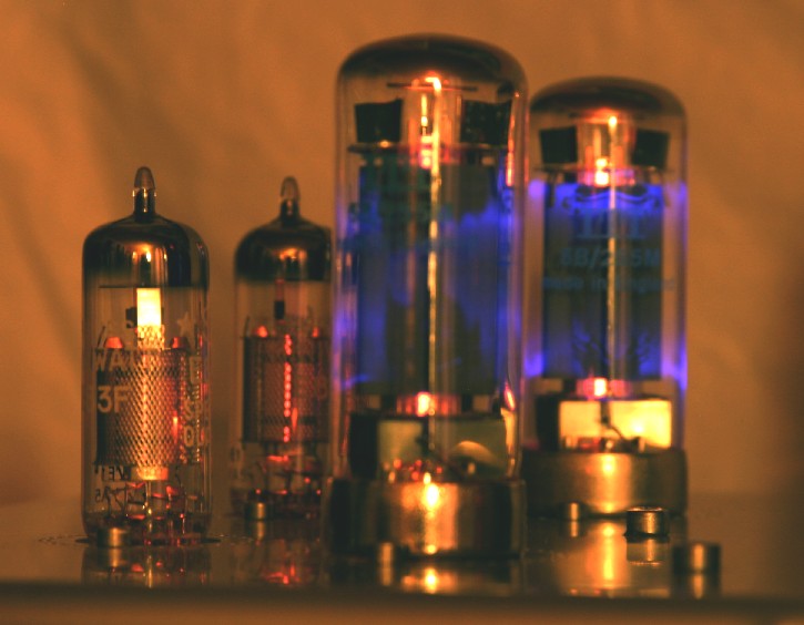

That is a nice photo too. I have a quad of EL34's that do/look like that also.

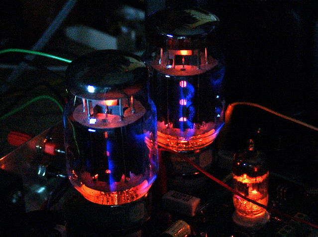

Stray electron hitting the glass enevelope causes a blue glow. No flouresents it's a sign of a gassy tube.
As tube's get older they diffuse gas through the envelope and around the seals.

The tubes seen here are new Electro Harmonix KT88's. They have blue spots on the glass that are quite bright. The spots vary in size and intensity according to the music.

No .....I've been using 807's for over 45 yrs and thev'e all behave sim from first electron onwards. One can check this by measuring g1 reverse leakage current. That should dispel the porous envelope to a myth. The recent Svetlana's have very thick glass compared to some early KT88's which had glass thin as a wafer crisp.
The idea that cobalt causes the glow is also speculation. My 807's use cobalt free glass and the blue glow persists quite strongly. On warm up the strong blue is within the electrode geometry then spreads around the whole tube- These JAN 1950's tubes were made at the height of nuclear prolification testing so the glass had to be free of known impurities.
I agree that leakage around the wire outs can muckup tubes but most are made quite sound and should last indefintely. Most of the failures are mechanical.
In the 1950's most of the UK imports of 807's were rebranded KenRads (US/CN).
Just to throw the towel in, I have several old 88's which don't have any blue fluoresence.......any explanations ??????? And electrically behave just as good as others.
