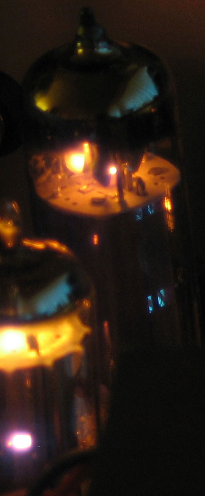

How much blue glow is healthy in a penthode?
I can see a faint blue glow inside the anode. Grid shadow is very obvious.

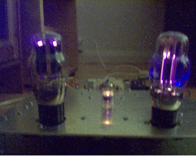

I could photograph the glow from my 6AS7G, the right one in the pic. And this with a low quality digicam. Do you think this is OK😉
Wow! Now that is seriously gassy.

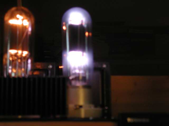

I should have known better when I bought 2 vintage VT4-C tubes at a hamfest for $5. I put them in my amp and turned it on. The attached picture was what it looked like in the amp. It is fuzzy because I was in panic mode when I took the picture. The extreme tube current blew out the mosfet driver and fried the 10 ohm cathode resistor.
The picture in the previous post was taken with the offending tube connected to a power supply. The color and intensity of the glow could be controlled by adjusting the tube current and voltage. That picture was at 550 volts and 250 mA, the max from this power supply. At lower power the color was deep blue.
Most of the 6AS7 glow in the previous post appears to be on the glass itself. This is usually OK.
what i was referring to, is a glow INSIDE the structure
you can see the grid and inside of the anode though holes in the anode. You see "shelves" of blue glow betgween grid and anode, the electron beams. The are a faint blue.
Bas

That pink color is a giveaway... and alot of glow... bet that tube on the right is too gassy.
Yes, beamnet.....
That is exactly what i was describing about the JJ7027A and the svetlana 6l6GC, You actually see the 'electron beams'
So, you look inside the tube through the hole in the vertical side of the anode....
You have to peek through the hole in an angle(to look around the cathode to see the blue 'vertical stripe', in this blue vertical stripe you see horizontal stripes which are a bit less blue(or less glowing, whatever)
As i have been told this glow inside the structure is a sign of a good tube.
The glow never changes...and it looks solid rather than floating against the inside of the anode....
and the fact that both new tubes (JJ) as 'old' tubes (Svetlana) have exactly the same although, the JJ had it a tad brighter (horizontal stripes were more defined)
so i think: don't Worry.....
This amp is in it's prototype phase. I have another 6AS7G but haven't tested it with this amp yet. The schema is Lilliput from Audiokit. Only thing I've changed is the psu. The left tube is a 5U4 rect. I have used this amp for a couple of months and there hasn't been any problems.. I think I'll keep the things as they are and start building the chassis.
