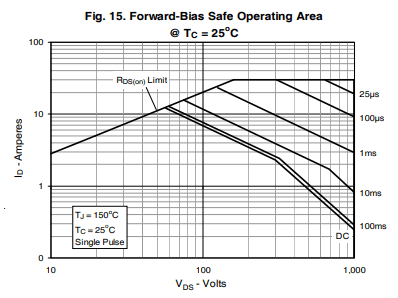

Those, like most of them, show constant-power curves. It is an extrapolation based on a thermal model only - it just shows when you reach maximum Tj for a given V, I and time. S/B limits are significantly inside of this. S/B is voltage dependent and happens long before the maximum Tj is reached. Well, what happens is it goes up to say 300C in some tiny spot on the die rather than spread the heat/current out like the thermal model assumes that it does. Device physics is a bitch.
It was well recognized in bipolars from the start because germanium was SO BAD about this. Silicon got better, and modern audio devices better still. All lateral MOS and most early vertical MOS was better still, handling full at higher voltages. Leading many to believe that MOS tech is completely immune to it. It is not and people found out the hard way. And the “better” they make modern MOSFETs and IGBTs for the intended switching applications, the worse the effect is becoming in each generation of devices. Some data sheets actually show the truth - and many only handle full “power“ to say 10 or 20 volts, falling like a stone above that.
A typical SOA is definitely not constant power - check it out.
It really is the data you need to stay out of 2ndBD trouble.
But you are right, MOS devices are not immune to it, due to the Spirito-effect.
I did link to a NASA report about it earlier.

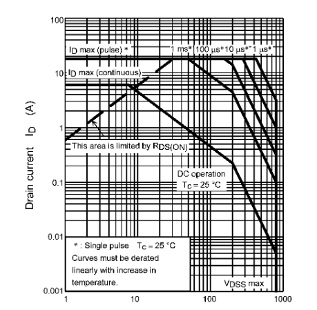

The SOA in Post #37 does not include a "DC" operating point. This almost always means it's designed to be a switch and will fail as a linear device no matter how thermally limited it is (within reason).
Compare to the IXYS IXTH10N100D2: There is clearly an adjustment for secondary breakdown, no?
Personally, I wouldn't go over 300V B+ @ 500mA with this = 150W on a device rated for 695W. Seems legit? The heatsink would be the size of a toaster though.
I have been talking to IXYS guys about using their high-voltage (>3kV) devices for linear operation.
They wouldn't recommend even 10mA linear operation at that voltage.

Any transistor data sheet that shows a purely thermally limited SOA curve is lying. All suffer from some sort of second breakdown effect - MOS , bipolar doesn’t matter. Some MOSFET types have been updated in recent years to reflect this unfortunate reality. Many of the older types were in fact better.
If what was claimed in the data sheets was actually true, there wouldn’t be a problem charging the output caps hanging off a regulator or hum filter. 3T regs “solve” the problem by internally limiting - and with a discrete design you have to do the same. And understand where that limit REALLY is. If you’re not intimately familiar with a particular transistor from prior experience, you just have to TEST it yourself. Since they are constantly changing which types are offered that makes the job a lot harder. The next offering that is rated two amps more and lower Rds/Vce might not handle as much current at 100, 200 volts as the old one did and you cannot just ASSUME it can.
Models from IXYS and Toshiba appear to have another transition in SOA diagram over higher Vds. It seems safer choosing parts from them.
