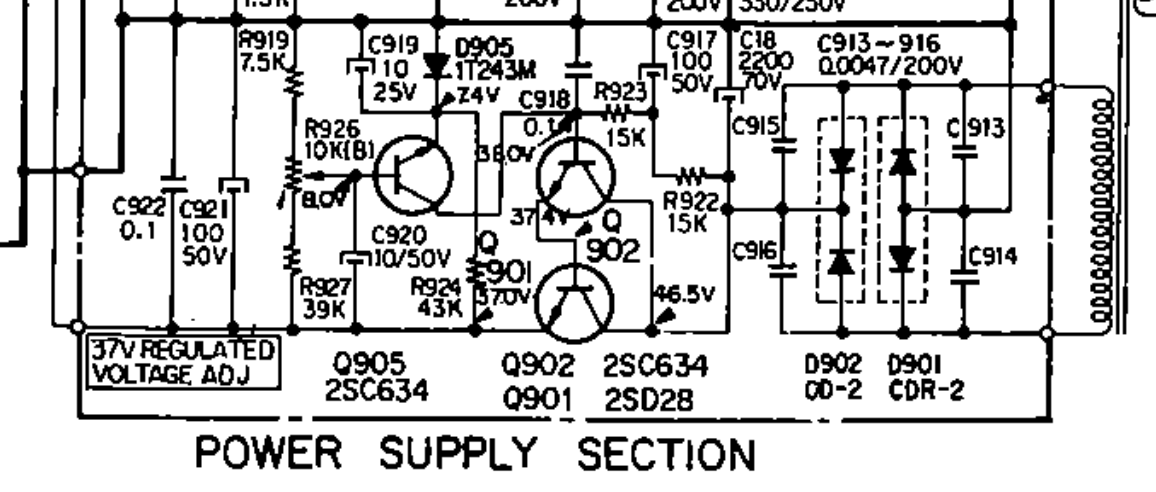

Looking at the schematics, there is not a 2SD69 fitted, it was originally 2SD28.
I would fit a 2N3055 or anything of that spec.
There is a maximum of 45volts DC on it and the current draw is minimal. Or am I looking at the wrong transistor?

It something going on here.
The 2sd69 dont exist in the circiut.
Maybe someone switch it earlier?
The Q 904 is replaced with 2sd69 on the circiut (185 to 150v rail).
The original in the Sonys partlist is 2sc807. 😀
2SC807
