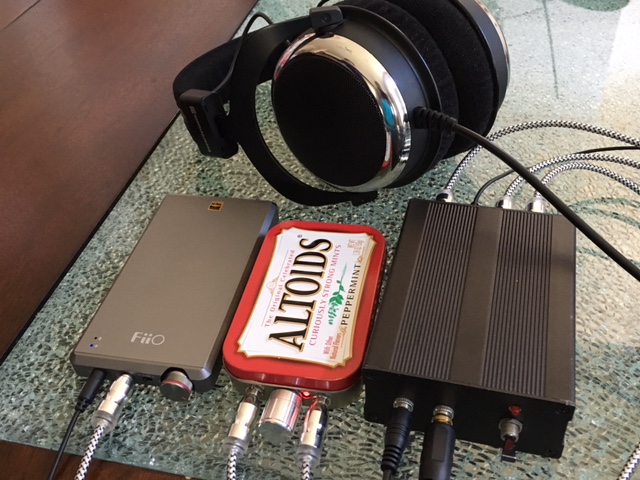

AB Test Box
I just whipped up this AB tester box. Using two DPDT 12v relays. N/C is connected to amp A from input. The second relay switches the outputs coming back from the amps to the headphone. Both relays operate instantly and simultaneously. Pushing a momentary on switch (lights LED for "B") and flips relays to N/O for amp B. I am using a 9v battery with a small DC to DC step up booster to get 12v. 6 x 3.5mm jacks and a small box and some soldering later it's done.
Sounds completely transparent of course as it is a wire. When volume matched the switching is almost seamless and imperceptible. Great tool to have.

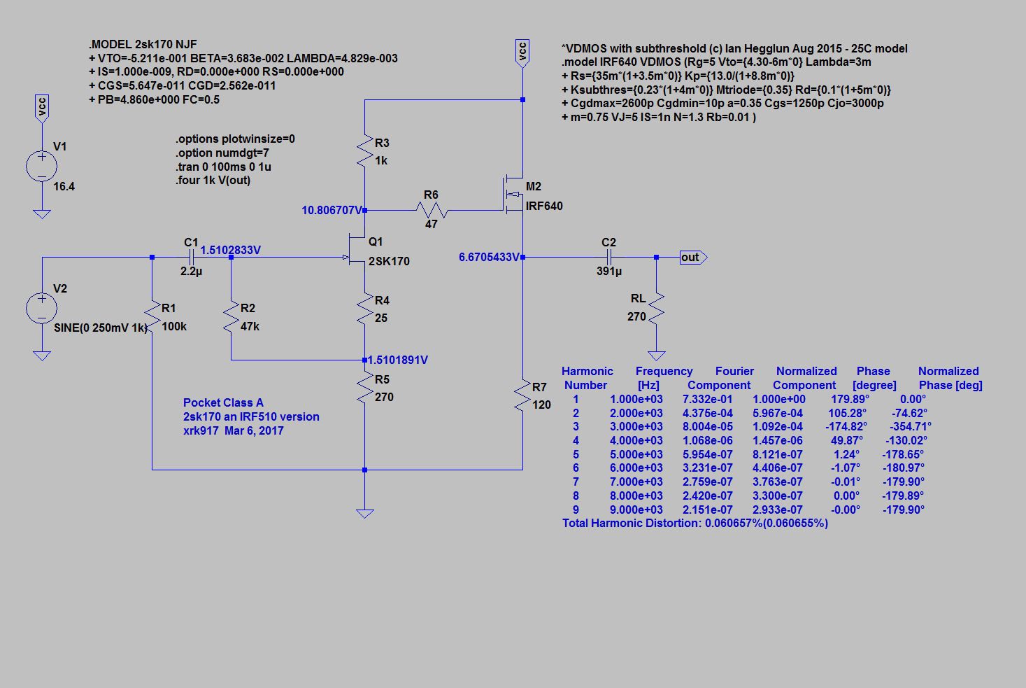

I couldn't find a model for IRF610 but IRF640 might be close enough. You could just take the same circuit for BF862 and ZVN4306 and drop in 2SK170 and IRF610 and it will work pretty well. It will run a little hotter.

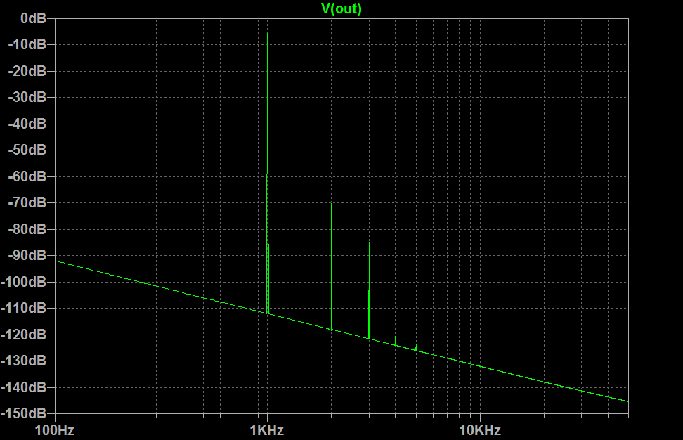

Here is a circuit reoptimized for the 2SK170 and IRF640. It's running about 55mA bias in IRF640:
FFT is pretty good and should get about 0.06% THD at 700mV drive into 270R load:

You could use 2SK170BL and IRF610 and run the bias higher, but it wouldn't be pocket sized or battery powered. The circuit from amp B could also be made with 2SK170BL, and in fact I made the prototype with the 2SK170.
When the ZVN is replaced with IRF610, the sound will change. It might not an improvement to the amp F.
