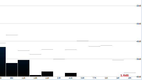

Oops sorry, I meant that you can see the response level at 20kHz for certain musical note and you can see differences. Let me take an example:
I display the spectrum visualization (see attachment) for clip B, then when there is 20kHz note appear on the screen (above -60dB) after the lyrics "September (in Montreal)" I printscreen the image. Most of the clip doesn't have this 20kHz note, not above -60dB. Clip B shows 1.6dB above -60dB, so at least there is 1.6dB difference between clip B and most of the other clips at this frequency. This is what gets into the ears, not the +/-0.2dB.
For that 20kHz note as an example, you will see that clip B is the loudest, then clip F. I believe that this applies to the majority of notes. And you can see that clip B has the highest vote, then clip F. This is not coincident. Many people can perceive small loudness difference. Trust me, if this loudness is flat/same across all clips then almost everyone cannot hear differences.
I didn't say that clip B is chosen 100% because of the perceived loudness, but it is the major factor. After this factor is of course the bass quality that unfortunately comes with a price: accuracy. But this inaccuracy and the low distortion, who can perceive it by the way??

The 20kHz is just an example (to make it easy to show differences) to explain my point that our ears do not hear +/-0.2dB from 20Hz to 20kHz. Certain musical notes can be drastically different between clips. It is up to the listener to choose which note (hence frequency) he wants to listen to when comparing. (I was just giving the clue. If I have time may be I will try to capture other notes.)
Loudness is the first thing most ears can perceive. I believe it is the first determinant factor (Many believe that it is the ONLY determinant). Second is bass 'quality', but loudness will reinforce bass perception too, right?
So I tried to check other notes. The highest note in the music, 1kHz, which is after the lyrics "That's where..." at 0:40. One clip has outstanding SPL here. This correlates with highest distortion. I believe this is the pocket class-A headamp which uses poor ZVN mosfet at the output.

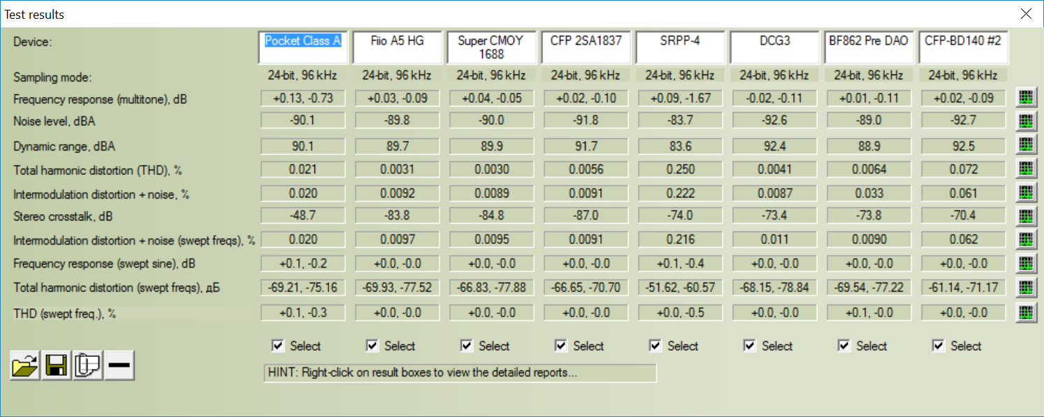

Here is the summary of the test data from the amps on the day the test was made:
Note that the pocket class A has since been made into a real PCB with larger output caps and bigger rail caps so performance is even more improved (dynamic range is 94.2dB, stereo crosstalk is -72dB, noise floor is -126dB, freq response is +/-0.5dB 15Hz to 40kHz).
