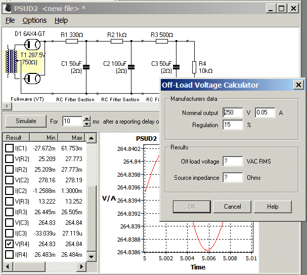

hello guys,
i would like to build this preamp as I have all the parts needed except for the power transformer. What will be the right secindary voltage for the power transformer?
thank you...
... secindary voltage for the power transformer?...
Try 250V at around 50mA AC.
This sims-out to just about 260V of DC at the amplifiers.
Yes, the simmed rectifier is different; I have allowed for that. The single winding with diamond bridge will drop about 1V more than the double-winding 2-diode form. This double-winding is specified each-side, so same-as a single winding. It will measure 280V-290V AC NO-load, dropping to around 250V AC at full load. Voltage at the first filter cap will be near 390V DC NO-load, a bit over 300V DC under load. The 1K resistors drop this to near 260V supply to the amplifiers. I doubt it is very critical; I'd expect it to work fine 200V to 400V. (If you are facing a 27-amplifier shoot-out, you may want to try various supplies....)
