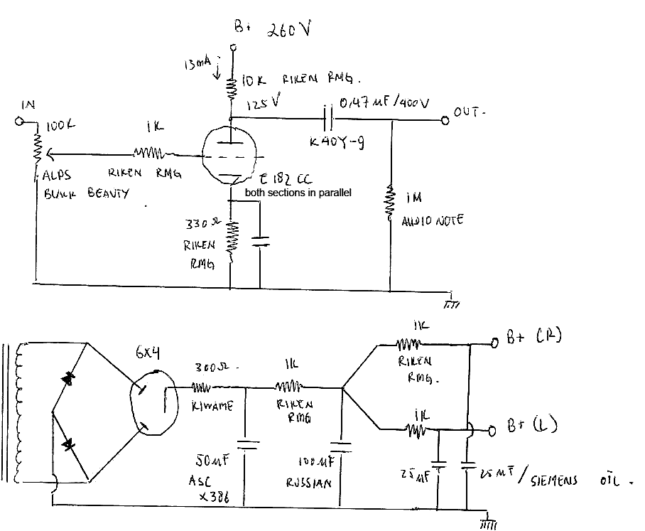

blind test tube preamp free for all
each channel tube is parareled..

Now I have to ask: did you listen to the preamp without the paralleled triodes i.e, just one half of the 7119?
Why not just add the E182CC and volume control onto the amp chassis and do away with one set of interconnects and two connections? I bet this would be the best sounding, most transparent solution.

Just one note: on your schematics the two diodes are drawn wrong. Maybe a moderator can add a comment so that anybody willing to copy the schematic won't end up with an non-working PSU.
Erik

I want to build a simple preamp out of parts i already have. and this may have given me the inspiration.
looking at the datasheet i think.... and please correct me if i am wrong... but could i drop in a 6n6p as almost a direct replacement (I would want to run it slightly hotter, maybe 20ma.
maybe a b+ of 220 and only 120 on the plate?
I see no reason why not. You may also wish to experiment by replacing the cathode resistor with an LED. Output cap is probably on the low side for a solid state power amp.
Any changes to the published circuit or components will certainly change the sonics and not necessarily for the better.
sorry, i forgot :)
the cathode capacitor is black gate n series..
i've never try non parareled tube for each channel.
i parareled the tube to have a very low impedance, any comment 'bout the difference between parareled and non parareled ?
can someone correct me if i am wrong? i think 6n6p does not have the same pin out as e182cc/7119. anyone?
