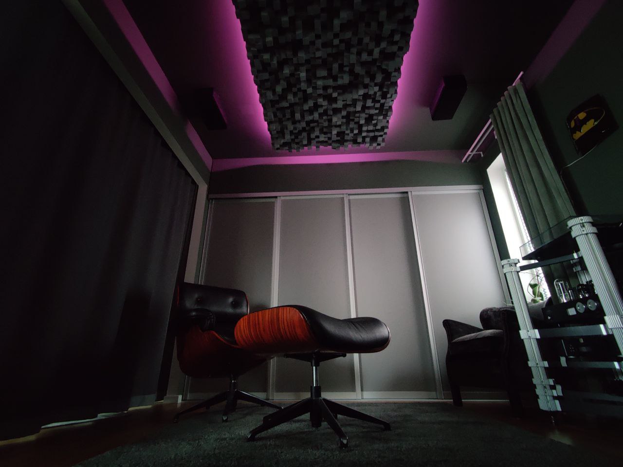

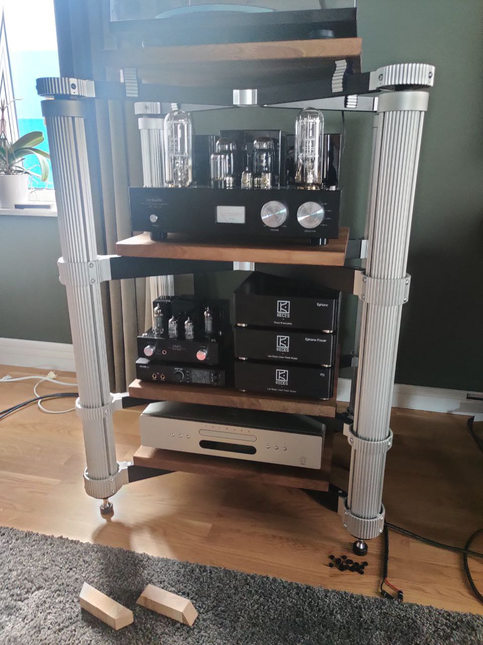

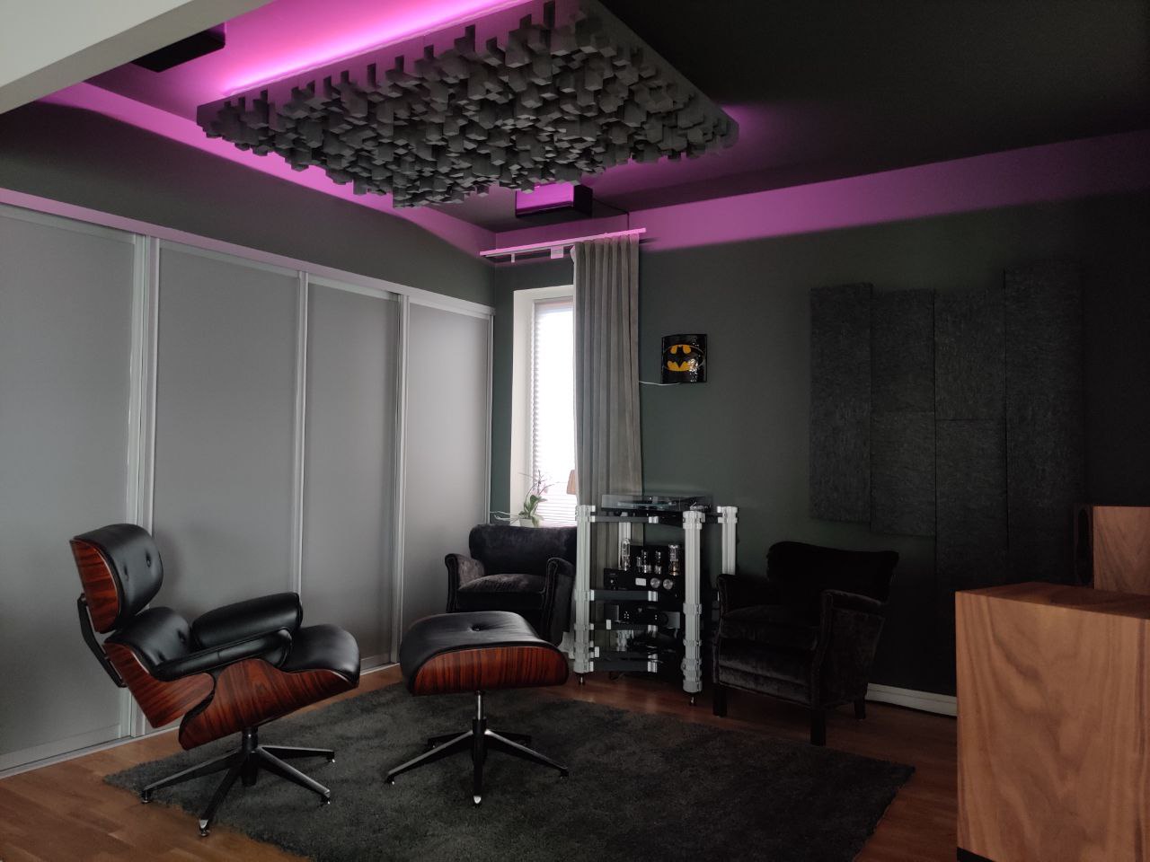

Room is, well. I have attached some pictures. They are not new, but its basically whats the room looks like. I have an open floor plan, but with my music/cinema is not really out in the open. I have curtains to block out light when I am watching movies. In the closet behind the seat I have all my records, cds projector, avr, sub amps and subs. The plan is to build big absorbents in both corners of the closet. Nearfield listening as the speakers are 200-250 cm for listening position.
The purple is just for demonstration purposes, I usually go for a mellow sunrise.

200-250cm is definitely not nearfiled! In a normal room reverberation radius is about 1m, in a lightly treated room a little more.
So you could think about some directivity but if the room sounds good it's not needed in this distance.
Do you want to stick with 4 way or do you want to switch to 3 way? With 3way you need a bigger volume, your design idea will not really work. Or only with pretty low volumes.
