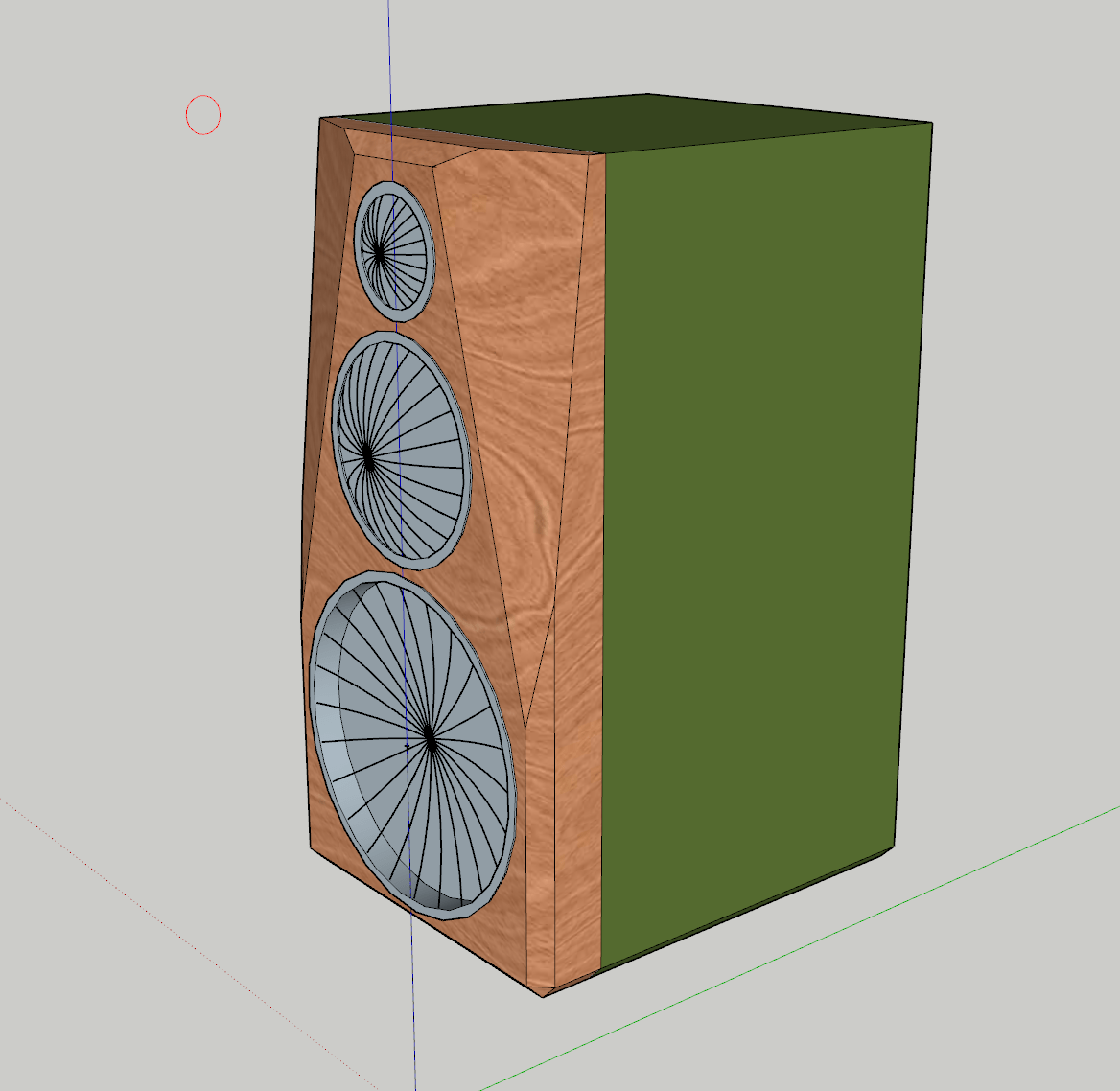

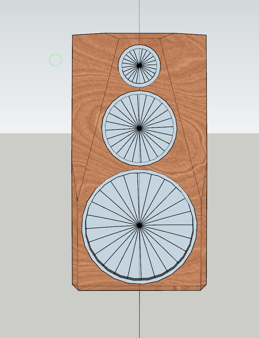

I the latest sketch the mw19p woofers 7" have an outer diameter of 187mm, a 8" beyma is 212mm so I guess you could make that work without changing the proportions massively. So any suggestions to 8" are welcome as well.

One of the ideas when I started thinking about this build was to keep the drivers as small as possible but not stressing them. And to do that I landed in the idea of the three way and subs, a four way.

Unfortunately for me the width is what's most important to keep at a minimum. A projector screen is coming down between the speakers.
But the more I think, and the more perspective, ideas and inspiration I get from the community the further away I get from the original idea, hopefully/probably for the better 🙂

Yep, hopefully I get time this weekend to do a few sketches with different baffles and driver sizes. I might bring home som material to build some mock ups in cardboard or similar. I have an open floor space apartment so speakers will be visible from everywhere except my bedroom.

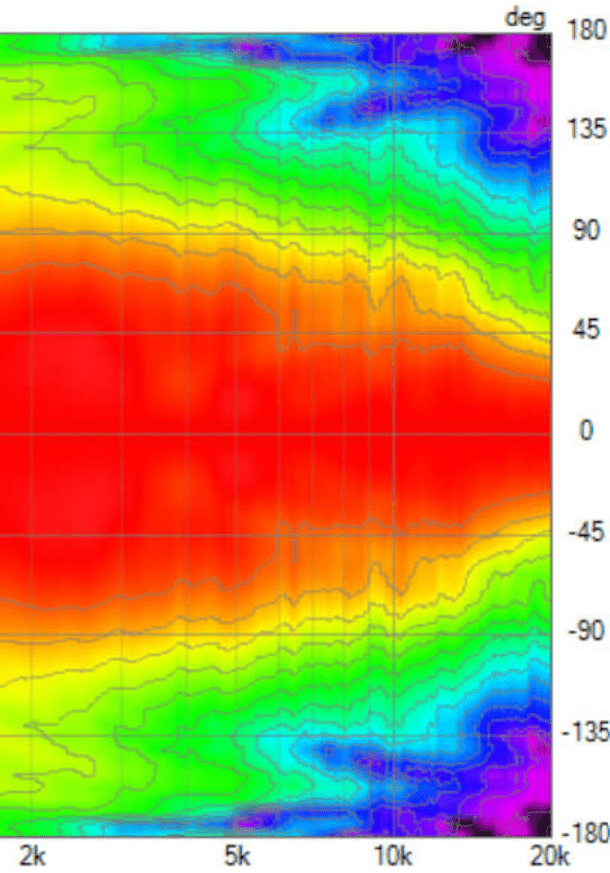

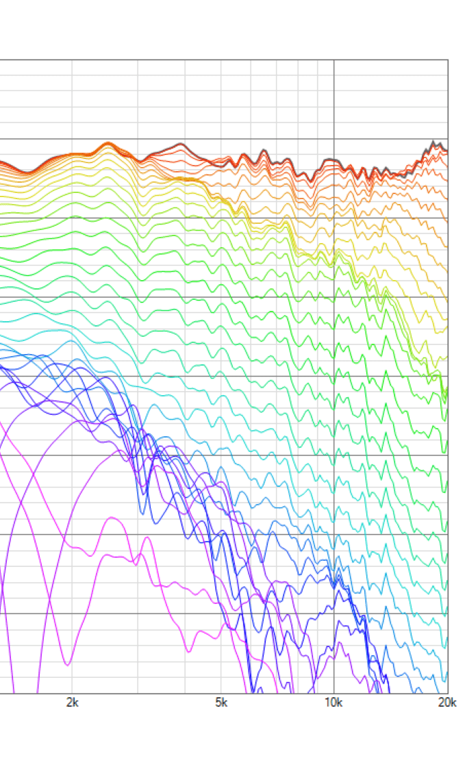

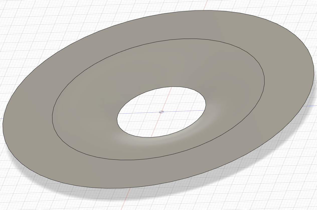

Possibly a very shallow wave guide, to optimise top octave DI control, without mismatch at the crossover, the mid will still have a higher DI at the crossover due to a wider dome than the tweeter, so some level, although minor, of DI control should be used on the tweeter imo.
I helped a fellow member design a shallow waveguide to solve a problem of matching the T25B to the M74B. The Augerpro waveguide had too much directivity to match the M74B and using it in a flat baffle suffered from diffraction effects.
Waveguide and T25B measures like this
A 5mm deep plain radius was enough to match them quite well at 3K. The measurements are not mine so I have snipped the relevant bit.
How much vertical baffle there is above the M74 is important to avoid some unfortunate diffraction effects. Centred on a baffle wide enough for 8" drivers and 1" roundover works fine if the vertical is chosen carefully.

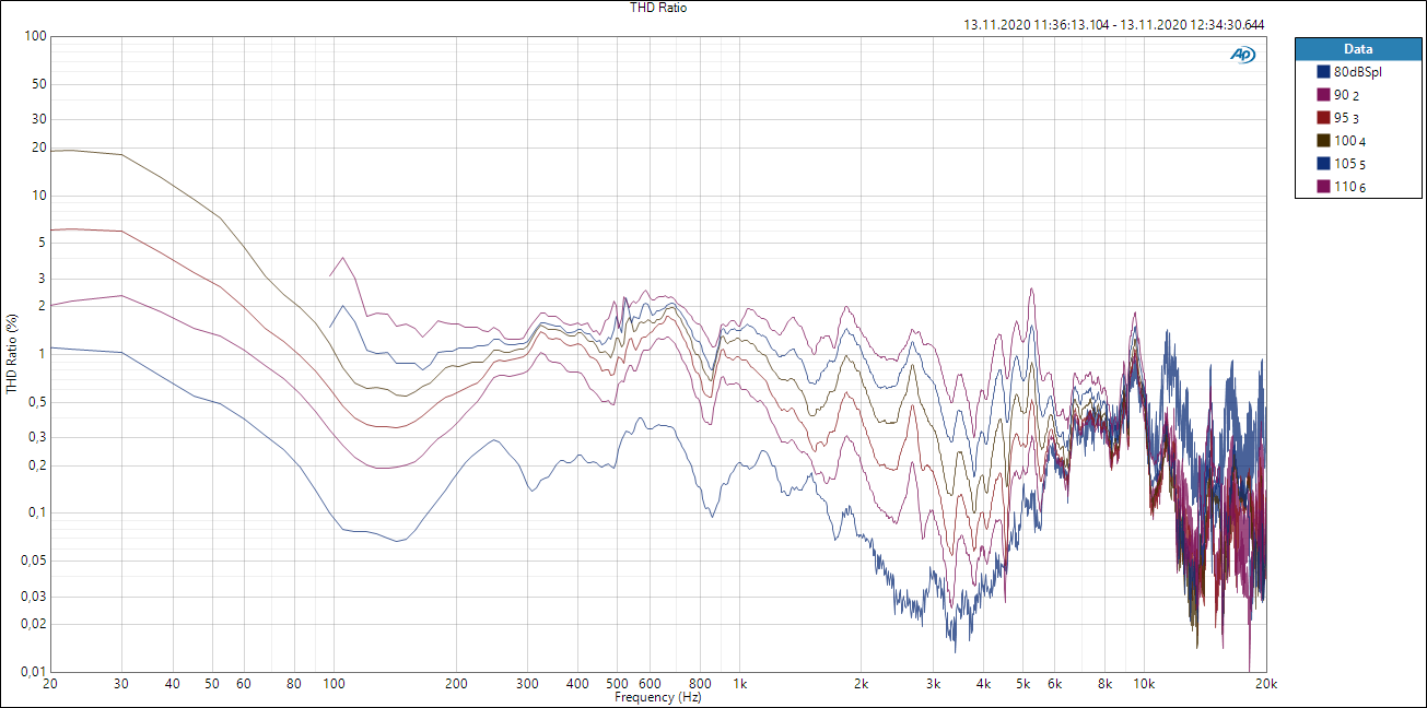

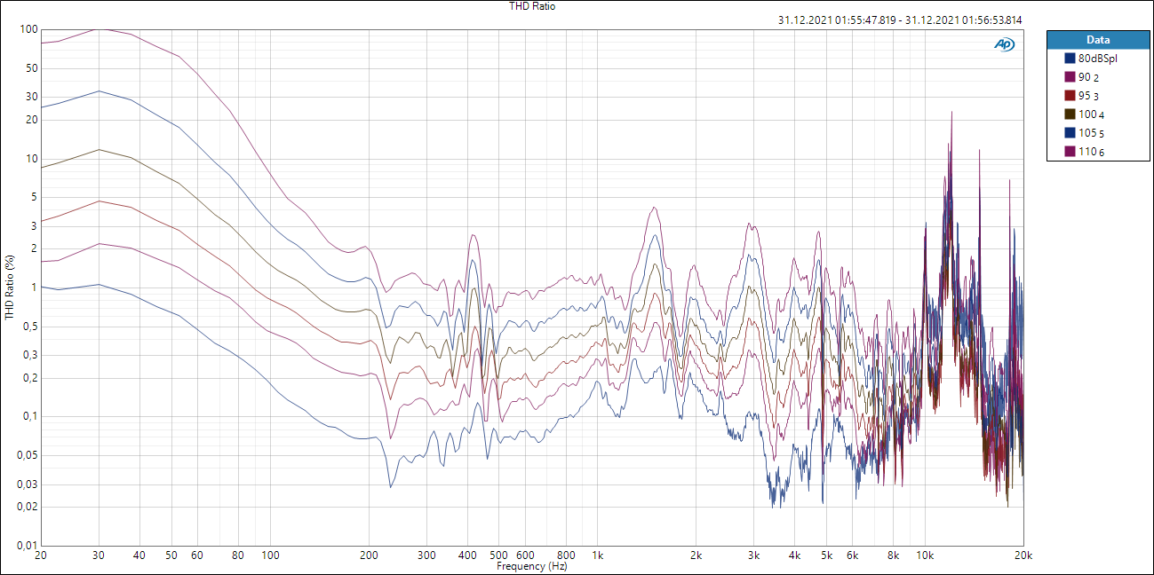

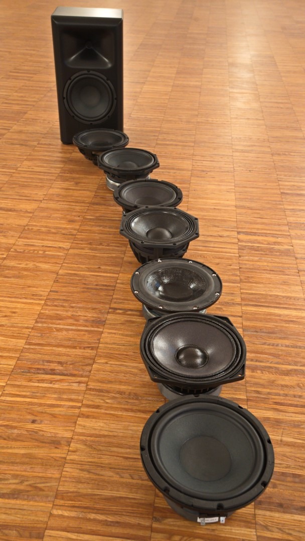

18Sound 8NMB420. While a nice driver for PA I wouldn't recommend it for HiFi. THD is very high at low levels, it's not made for that. It was the first driver I tested for my home cinema speaker ... after all I bought and tested about 10 different ones ...
Endet up with PHL or Kartesian Audio - both great for HiFi and high level.
When you go 10" (PHL?) you probably can use it later with the M74 in between.

I think I have to go 10". Smaller drivers just don't seem to have sensitivity to match. Any drivers that performed well lower in the frequency range? Think no need for subwoofer, or I have my old subs but they don't sound great for music, but OK for movies. Specially in a small box. Ditching new subs allows for redistribution of funds again.
Or go for a MTM or WTMW?
Sorry if keep changing my mind, there is a constant battle in my head between the compromises that you have to make. As usual, the more you read and gather information, the less you realize you know.
