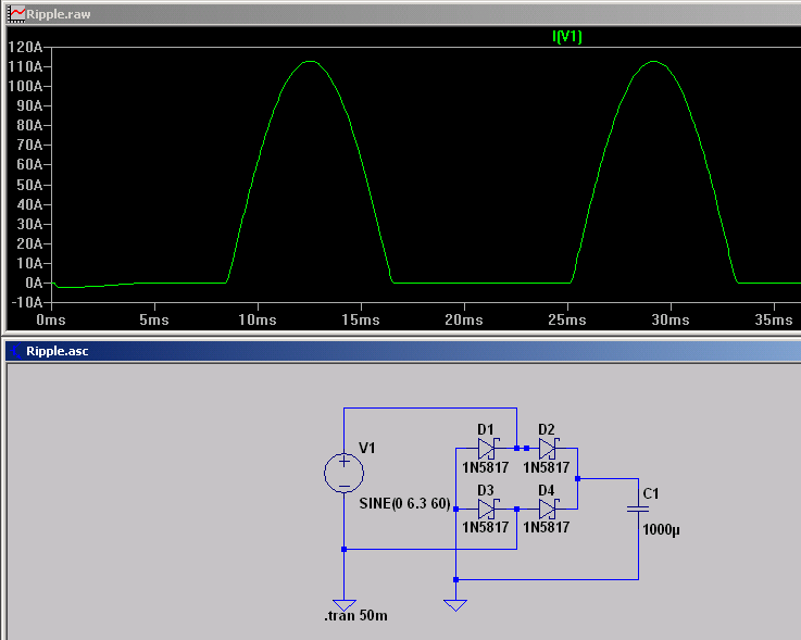

Vripple @300mA = (300x10^-3*8.3x10^-3)/(1000x10^-6) = 2.49V Vripple @150mA = 1.245V That seems extremely high!
It's a worst case calculation. It assumes that the cap is charged instantaneously once per t seconds and discharges linearly between these charge packets. In reality, because of the non-zero conduction angle I harped about a few posts back, the cap will charge over a longer fraction of the period so in reality, the discharge time, t, will be shorter.
You can probably find a better estimate of the ripple voltage by calculating the conduction angle, and get a better estimate for the discharge time. But if you want to be more accurate about it than the quick, back-of-envelope calculation I'd turn to Spice. A quick simulation in LTSpice (free download from Linear Tech) shows 1.71 V ripple (1000 uF cap, 300 mA load, 60 Hz mains). So 2.5 V is not way off by any stretch of imagination. 300 mA is a sizable current and 1000 uF is a fairly small cap... Also note that most newer electrolytic caps have tolerances on the order of +/-20 %, so that 1000 uF cap might be 800 uF (--> 2.1 V ripple). Older ones are typically +100%/-50%. Yep. -50 %!!

Vripple = 1.7 V (using the figure from the Spice sim)

The trafo should connect from pin 2 to pin 3 of the diode bridge. It should not connect to ground. In your schematic, you're using half-wave rectification and shorting out the transformer during half the cycle. Look at the current into pin 2 of the diode bridge...
Stare at attached.
~Tom
Stare at attached.
~Tom
