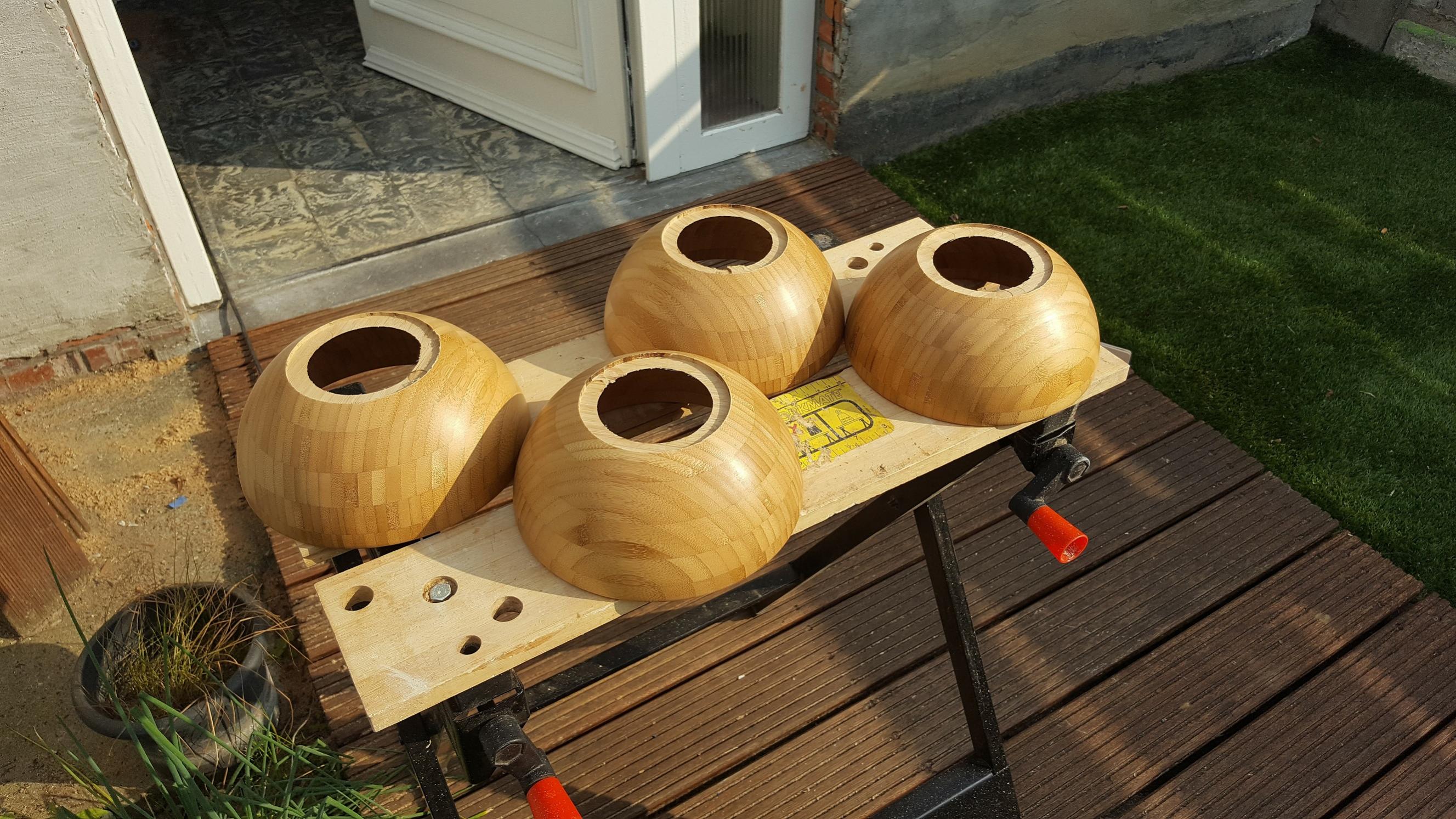

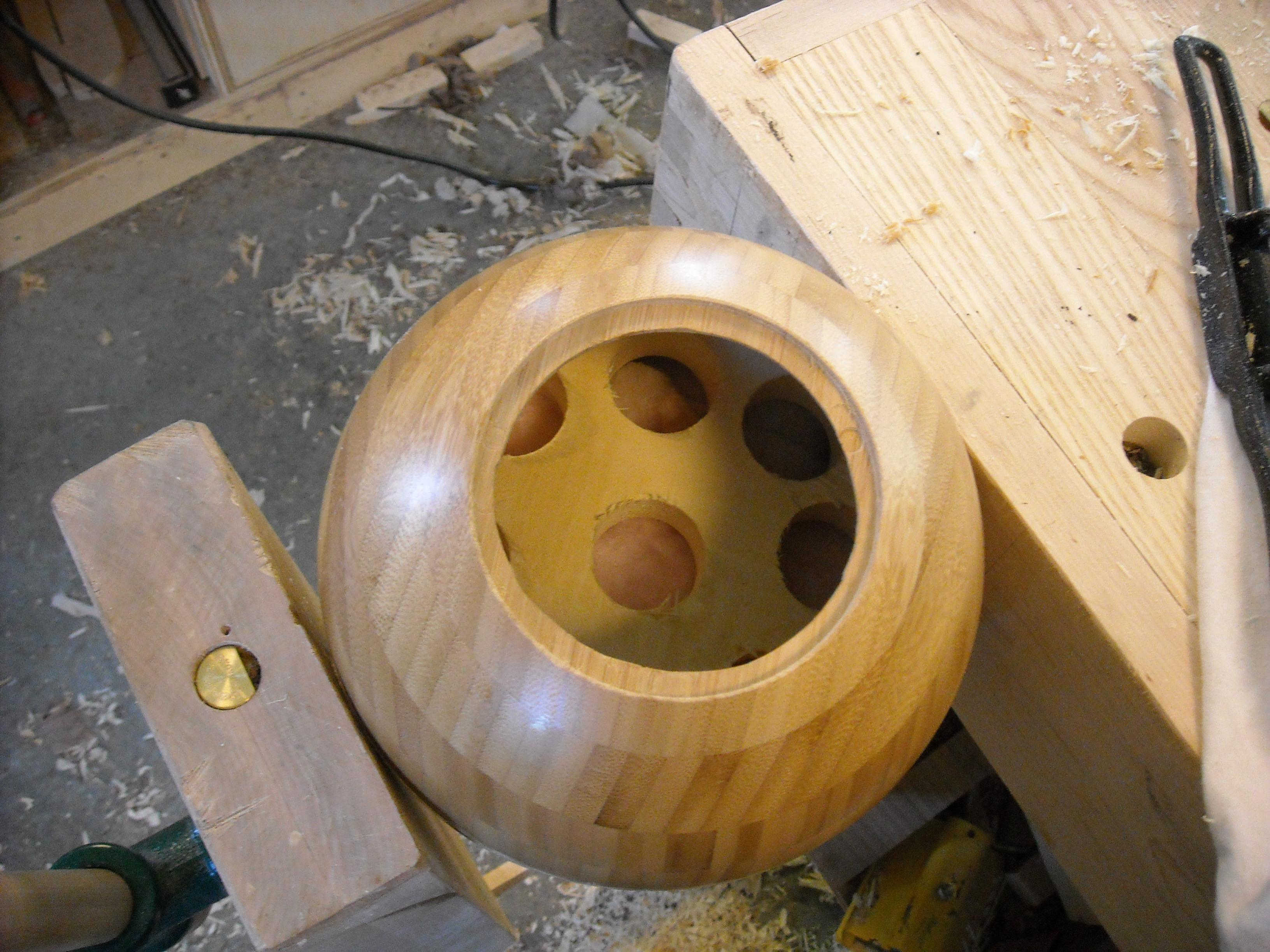

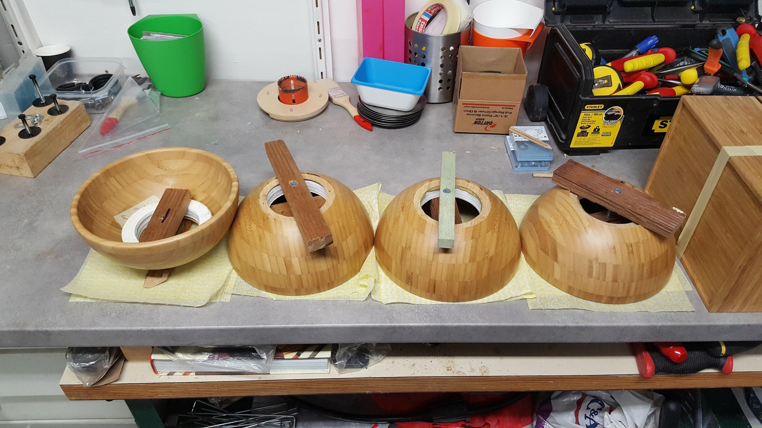

Could anybody here tell me how user kingfisher did this?
Or could anybody tell me how he/she would go about and do this?
I mean the inset for the speakers in the wood bowls, as i'm also starting this project with blanda matt bowls.

Well I have a router (black and decker KW900E) but I just don't see myself doing something like that with this one.
For me the router looks to big and because of the shape of the bowl, you can easily go out of bound or slip up.

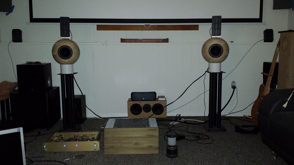

Well user kingfisher did it with the use of a Jasper jig and user ErikW did it with the use of an oversized template.
If anybody else has any tips/hints, I'm glad to know.
@Jerms: Most of the builds I find online or flush mounted ones, but when I saw the insert I really wanna try it for my project.

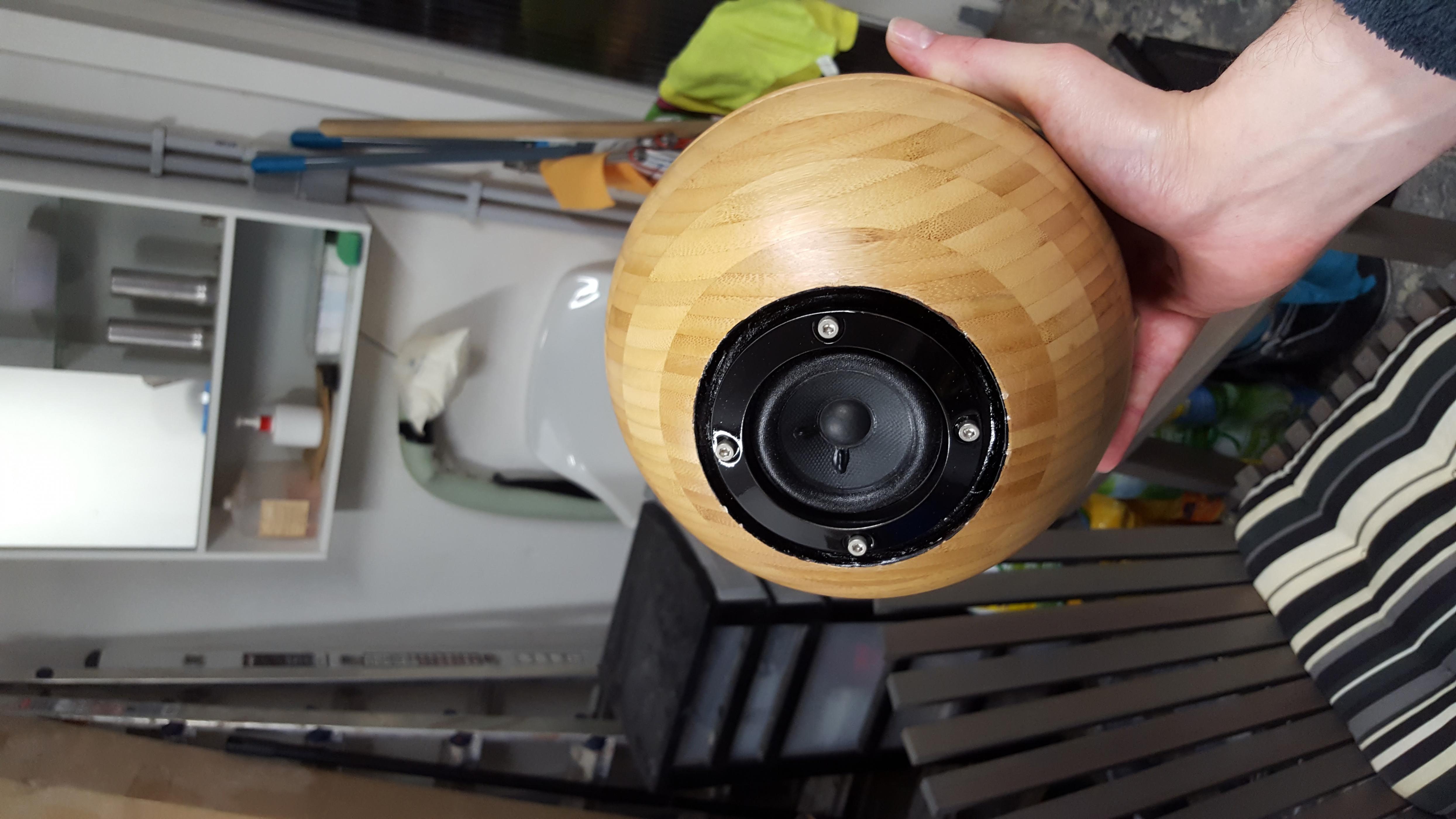

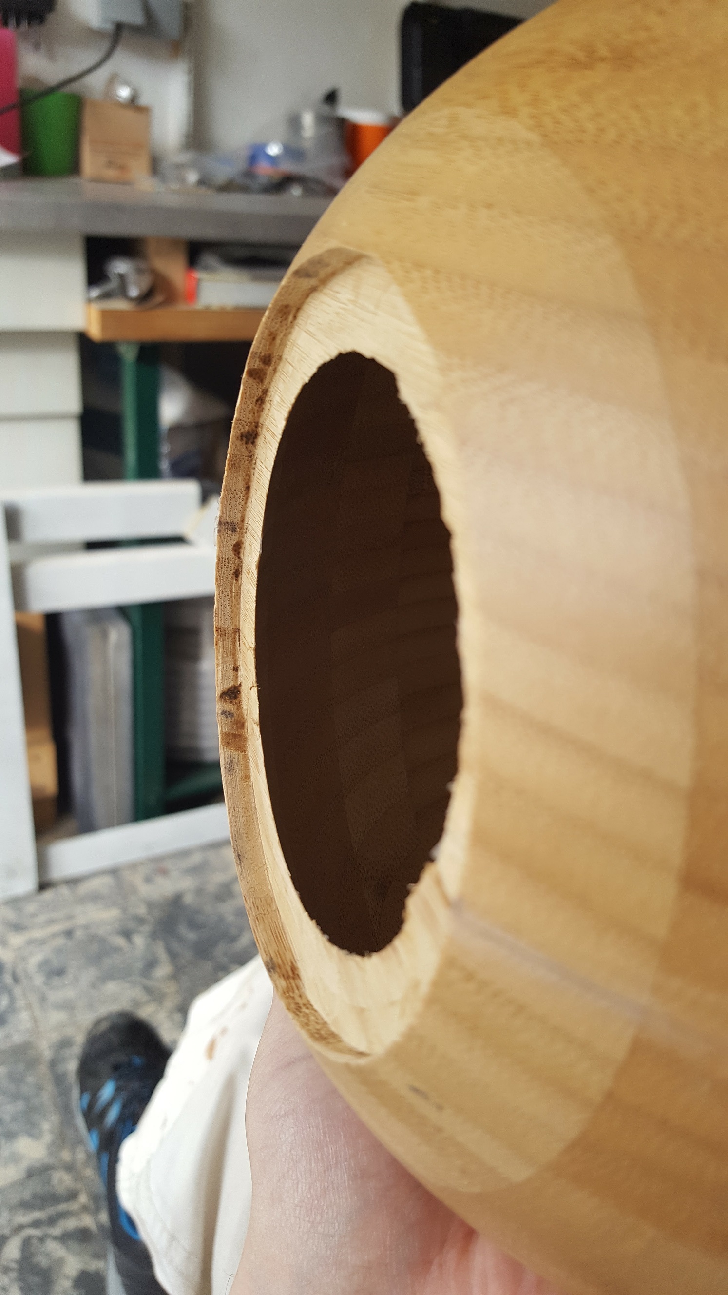

Do I understand your question correctly, in that you wonder how the rebate was cut after the hole? If that's the issue, I'd use a router table, with a template bit. The bit would have the bearing at the 'top', and would be a smaller diameter than the the cutter. It would take a bit of playing with the bearing size, and its height above the table to get the correct rebate, but it's safe and doable.
Aesthetically it looks nice, but not necessary. Seems like a lot of work for little returns. Looks nice though and you'll like the sound. The speakers disappear.
Good luck!
Vince

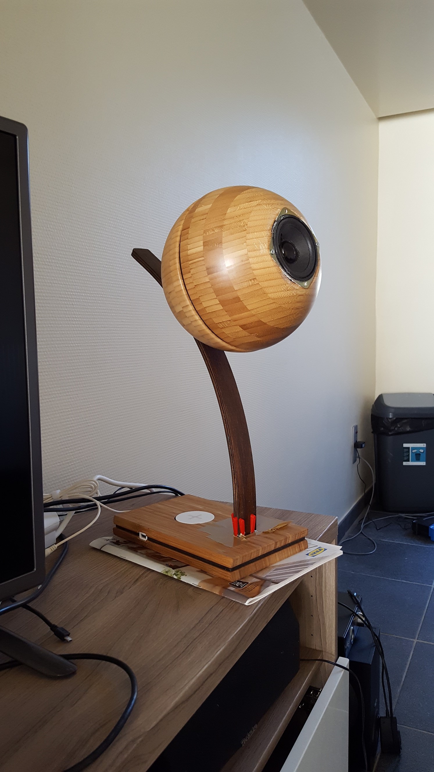

Well right now I've done a flush mounted one, this is just a test build with an old speaker set from the PC. I just wanted to see if I can make it, cost, design,... and when I saw a recessed one, I knew I will have to try it when I get the new speakers (just wished somebody would sugest me some in my other threat)
(also it gives that extra $$$ look ;-)

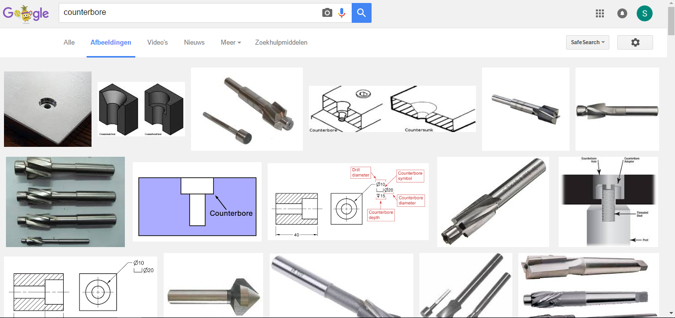

@Andersonix: It's not that I don't want to believe you, because I looked up couterbore. But when you open google you receive these images, counterbore or countersink are things I know and I even used a counterbore on this project for the foot where a screw goes into and a soft padding to hide the screw.
It's just not a term I would use for my project, as english isn't my native language. I don't see a counterbore as that big a hole, because I knew it more as a means to hide screws or go lower into wood,...
I'm looking for tips, hints from people who did it

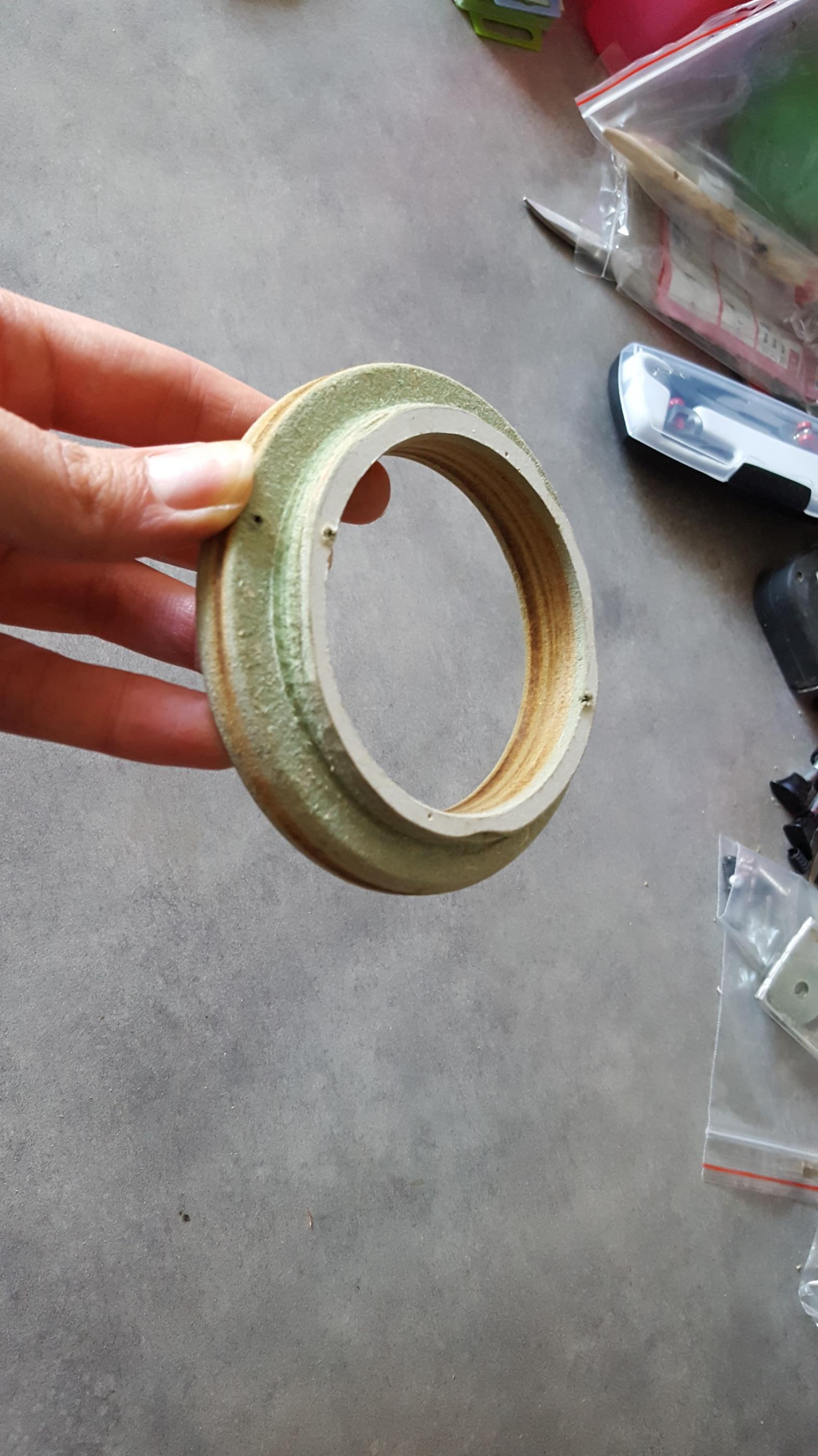

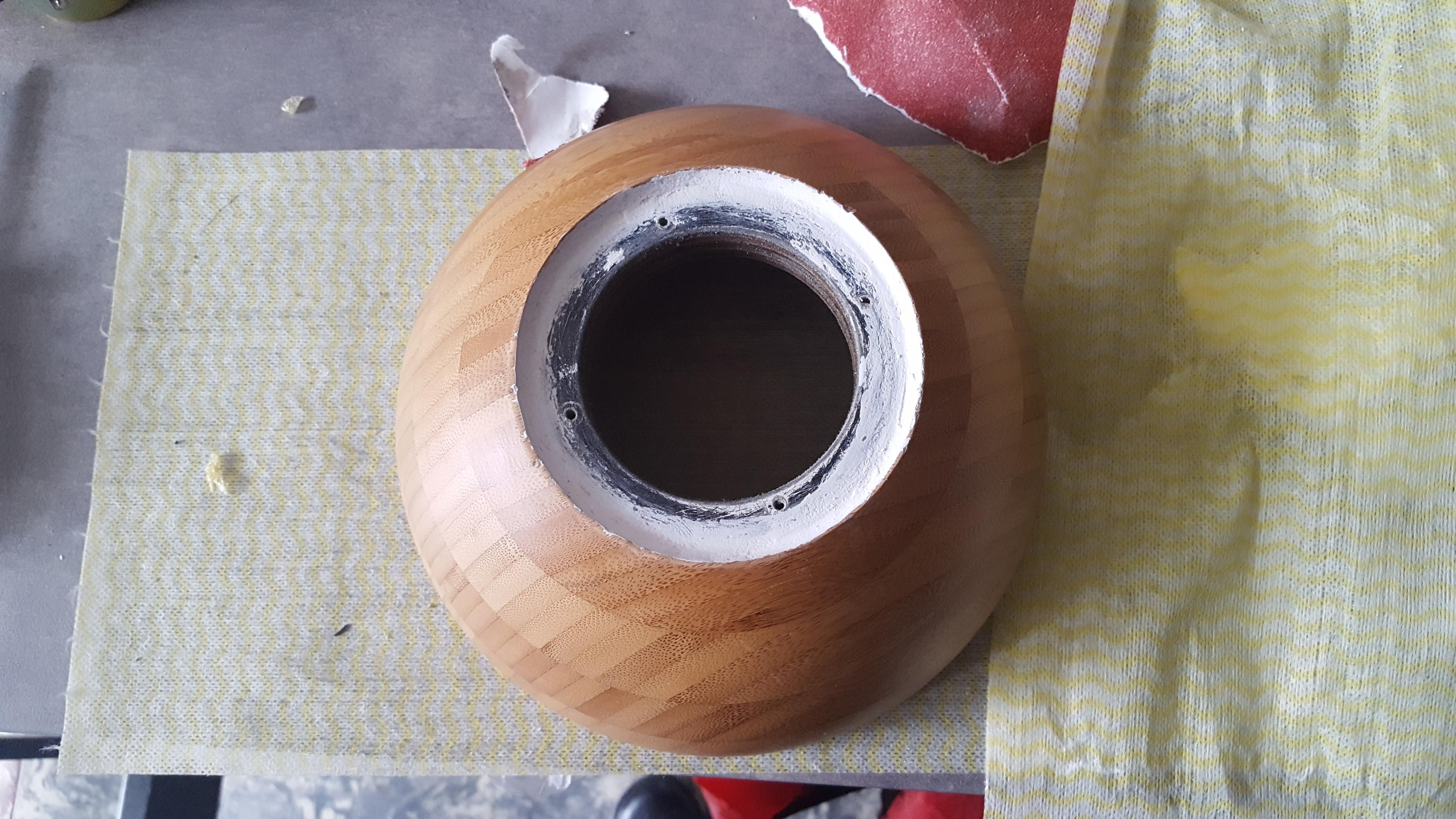

Well I tried a version of it this weekend.
I made a ring to sit inside the bowl, glued it with pu expanding woodglue...then with the use of woodfiller for the small space because of the holedrill.
When I have my new speakers its gonna be a tighter fit, but the process stays the same. So if anybody wants the look, this is another option to go about it.

Looks good with one "BUT!"
Depending on the venting arrangements for the back of the speaker your ring mount may restrict. It's usually better to chamfer/bevel or rebate the back of the ring to allow the driver to breath more easily.

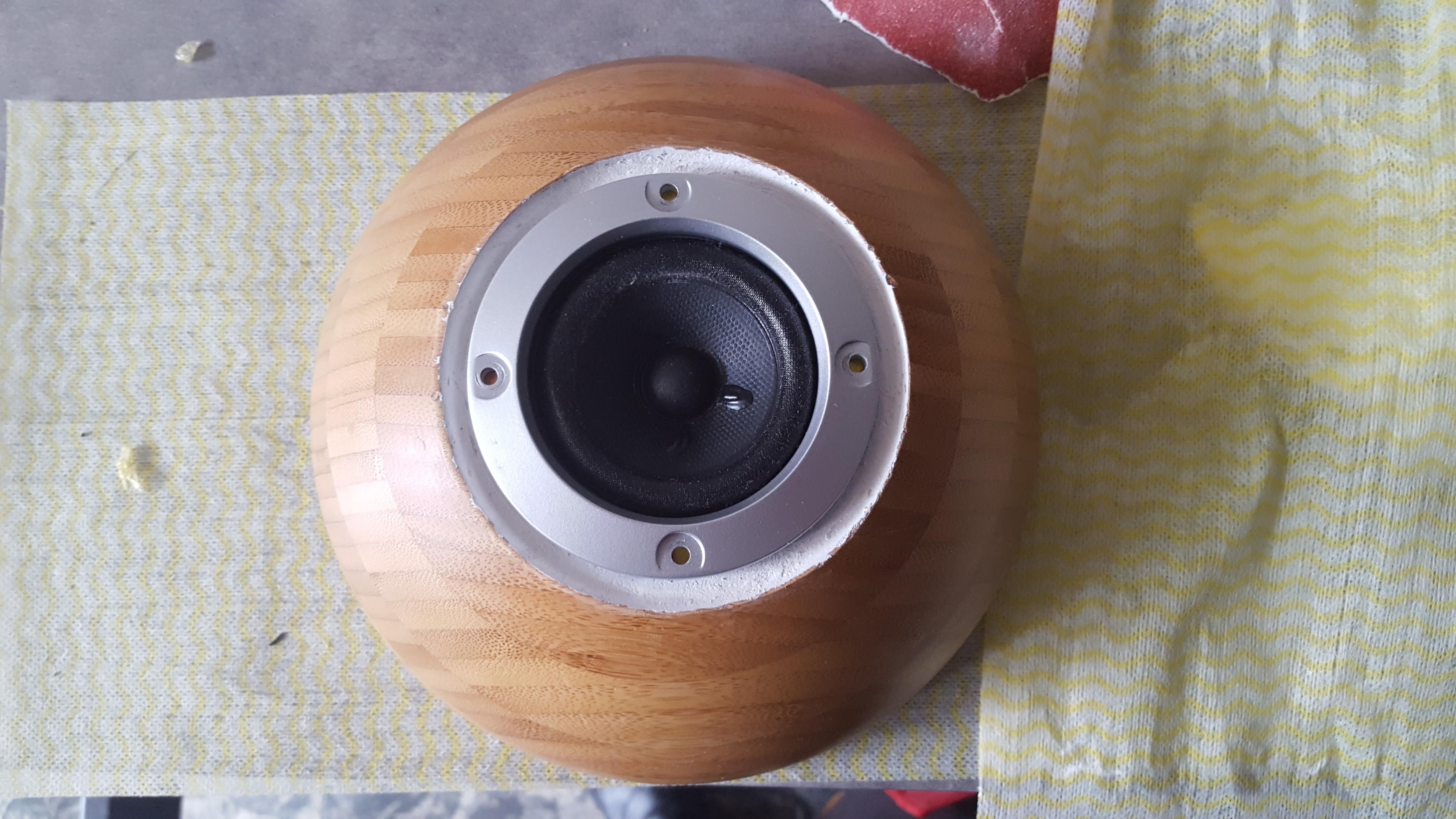

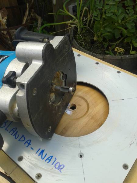

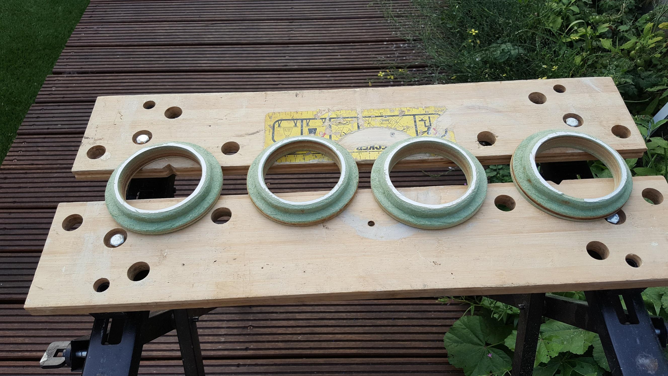

So here is my jig that I used to create the couterbore in the bowls...
Warning: when I was almost full circle in the second bowl, the remaining wood broke from the jig. So I had to touch it up with some paste made from glue and bamboe dust. But a steady hand and patience and then knowing that this could happen was all I needed for the remaining two.
I still had to use my rings after routing the circle because I ended up with round 2mm of wood, so I played it save and added some for the screws.
I made the hole bigger in the rings for these speakers so they can breath more easily, but just enough for the screws to bite into. Didn't chamfer it, because I forgot to do it (posting this and seeing your comment again made me realise that). But I can still do it because I noticed today that my screws for the speakers are not level.
So for anybody that wants to do a similar project, this is another jig
