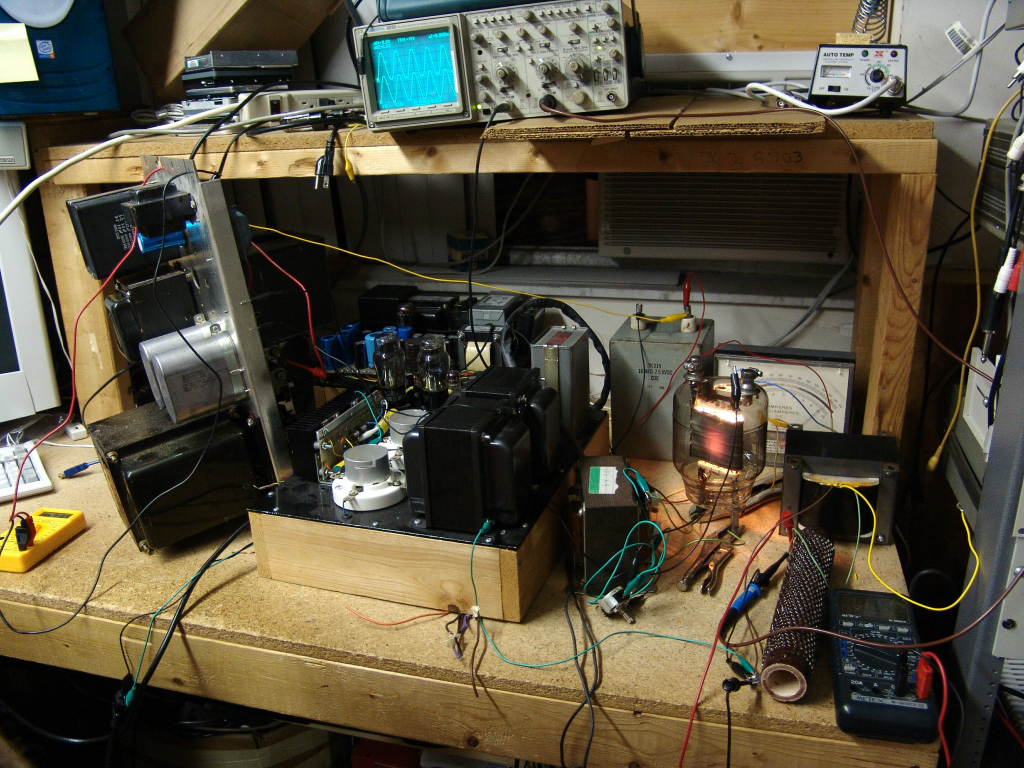

hey! if your cat is playing around
That's not my amp, but if you follow the thread to the end, you will see a very nice looking amp with vent capped Pyrex cylinders enclosing the tubes.
My 833A test amp however was so scary that I kept a 1/4 inch Lexan sheet between me and It. Look carefully at this picture. That yellow Radio Shack quality clip lead is carrying 1500 volts from the 1/2 amp power supply that is standing on edge. The plate current meter behind the tube reads 250 mA. The connections to the tube are made with Vise Grips and hose clamps. If I had a cat this thing could vaporize it.
It only existed for a week as an exercise to test the custom OPT seen to the right of the tube. The transformer failed to meet its design criteria, so the amp was never built. I still have all the parts, and may build a killer (in more ways than one) guitar amp some day.
This amp was created by taking my existing 845 SE amp, and wiring in an output tube that was 4 times bigger than the amp was designed for. Then I wired in a power supply that was rated to supply 750 watts of power. The 845SE never missed a beat, even though I plugged in my guitar preamp and attempted to blow this thing up with my guitar playing. I did manage to trip the 15 amp bench breaker twice though.
Note: This amplifier is NOT blameless, it has been blamed for several annoyed neighbors. The guitar testing could be heard from 2 blocks away. It was also the source for the picture seen in my avatar.

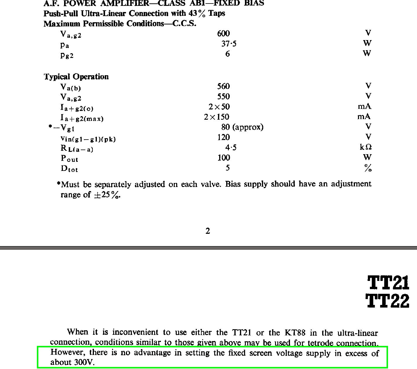

.... Tubes designed for audio are designed to have the same DC voltage on both screen and anode.
Recommended operating conditions for KT88 (tetrode mode) include a VG2 of about 300V, even when the Anode is fed from nearly 600V supply. The note, attached, from the Marconi TT21 data sheet, goes so far as to indicate that VG2 over ~300V is futile.
The EL34 is also designed for substantially higher anode voltages, compared to VG2, if the designer requires it.
