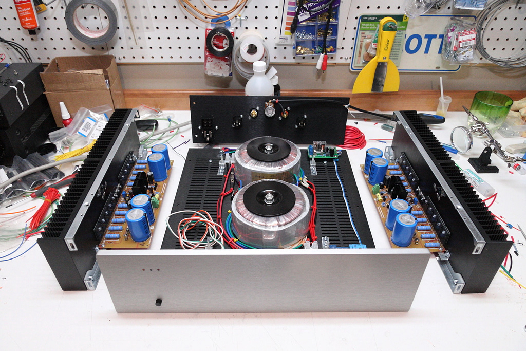

Meanman, official Dx Corporation man for Europe
Is working together and cooperating a very long time.
He was the one was in the first place and in the first group buy and always have assembled our amplifiers.
Image attached is from many, many years ago.... Meanman and i had a very few white hairs in our heads.
Reason why has my gratitude and respect.
