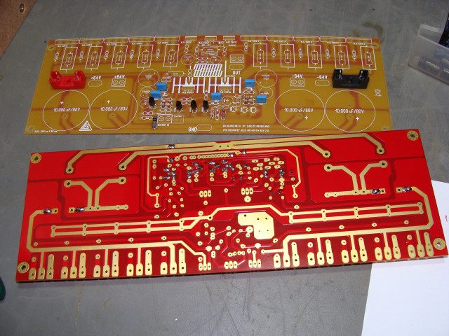

I have some news about my troubles. First, I found where the horrible looking square waves came from. It is my scope. I saw it yesterday again so I hooked the probe to the calibration bar on the scope and see the same shape. I checked channel one and the shape is fine. Seems some of the switches in the scope are getting dirty.
Anyway, there is still a little something happening at the point of clipping but I'm not going to worry about that as I will never play it that loud. I did find the problem with the nonworking channel. When doing the mods that Carlos suggest, I changed R22 instead of R21. I have fixed that and now it is playing and the heat at the VAS is greatly reduced. Very cool. I am still having trouble getting the bias set. What is the best way to measure it? I have tried using an ammeter on the rail, using a 10R 10w resistor in place of the fuse and tried measuring across a pair of the emitter resistors. With a 3k3 resistor in R21 I can't get it to bias at all. 0.0mv across the emitter resistors. That is class B if I understand correctly. Any help here will be appreciated.

The schematic used to produce these pcboards Meanman
Have offered is in Meanman hands...i have some but they are updated schematics that may not fit this pcboard...so.... this is to Meanman to answer you.
Several group buys and produced in several places and in several batches..so... there are some differences.
Red Boards, made by Meanman, are based in one particular schematic..and this is the one you should search for.
In the thread, Dx Blame MKIII, there you will have the first, second, and final schematic....search in descending order if you will produce your own pcboard... search in descending will allow you to find the last schematic posted...and the last schematic posted is the most modern one..... i do think you will find an optimized schematic as people have asked me to reduce third harmonics to make it even better in sonics.
