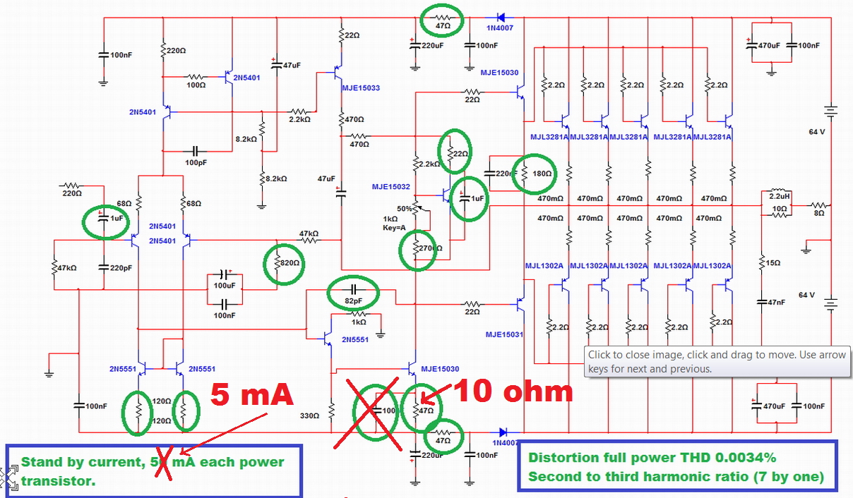

Carlos has confirmed the "best" schematic in the other thread. Here it is:
