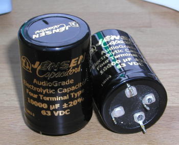

Here how Jensens look. The BG used by Krell are artist impression with a small print "Black Gate" at the top, that's why they don't look like real caps.😉
I'm glad I've read your post, because so far I only tried standard BGs. Next time I'll order the N type. I'm using them in gainclones (1000/50v) and the amp already sounds very good.
Ok Peter, that makes it more clear now, but are Krell using non-polars or what, do you happen to know?
Also, how are the four terminals connected up on the Jensens?
Is it like the 'older' DNMs I posted about earlier. i.e. Positive in & negative in, and positive out & negative out?

The Jensens have two leads marked with black dot and those are negative, the other two are connected together and form positive terminals.
Yes, that is how they are connected. positive in and out, and negative in and out. I have used them with positive in and out/ negative in and out tied together, because I could not install it otherwise, but they are really supposed to be isolated from each other, and go through the cap.
