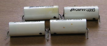

And here's a pic of some of the caps from him. You can see that there is only one cap which has a black dot according to flow of the lettering. I'm not sure how he measures that, maybe something about the inductance?
BLACK DOTS.
Hi Peter,
I'm not sure how he measures that, maybe something about inductance?
Quite probably...and I don't have a measuring bridge for that.:bawling:
I notice one cap in the pic has already delvelopped fruckles.:bigeyes:
Thanks Peter,if I find an easy way to tell which end is which,I'll let you know.
Eh,eh...wait 'till Bob finds out about this...:goodbad:
Cheers,😉

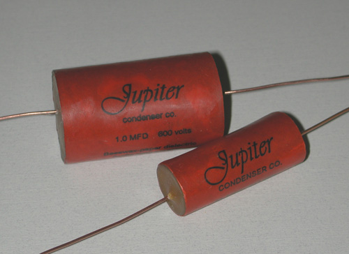

Has anyone ever tried the beeswax caps Jupiter is making?
I forgot this part...
Apparently a new brand,I noticed Welborne Labs carry them amongst others and some Dutch guys put them to the test already with very promising results.
Brian Cherry is one of our members and runs an audio business in China,dealing tubes and high-end components.
Cheers,😉
