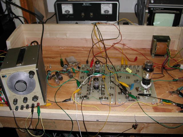

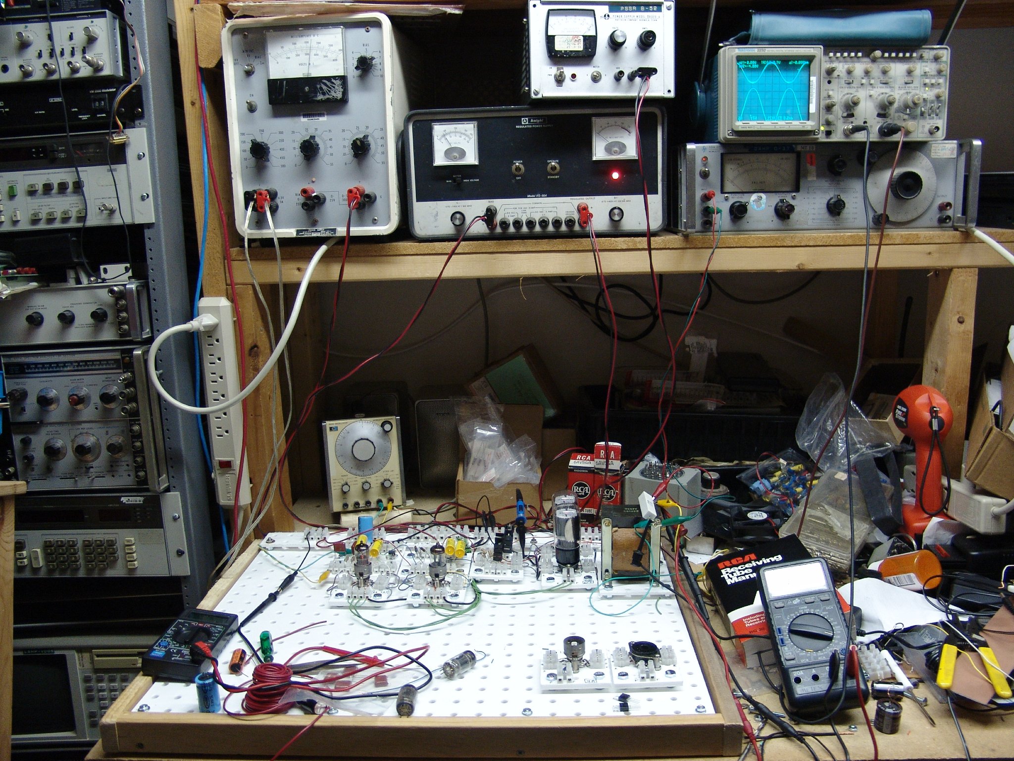

Not exactly Black Friday scores, but I have placed several orders with Amazon and Antique Electronics Supply for some bits and pieces needed to build a new vacuum tube prototyping system. Construction of TubeLab 4 has begun using the base from TubeLab 3. Some of my Amazon orders are scheduled for delivery on Friday, so this could be deemed a Black Friday project.

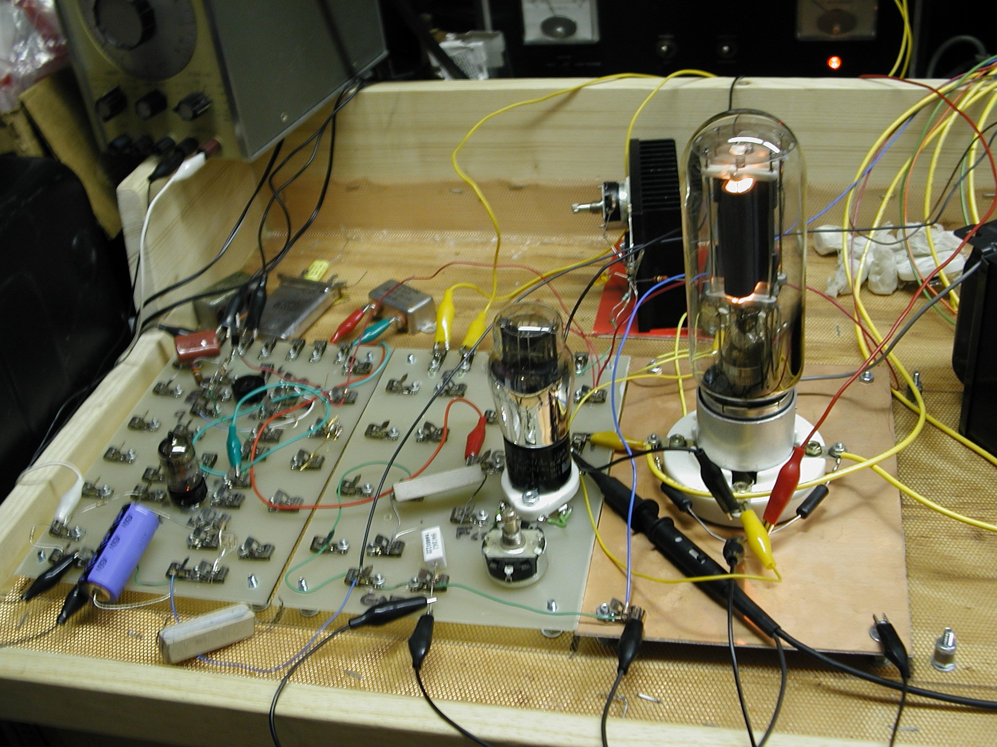

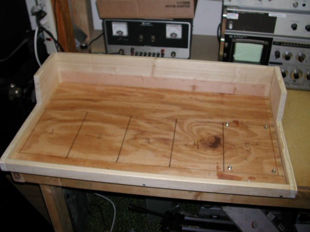

In early 2004 I made a crude breadboarding system that I called the "TubeLab." It had a crude wood base with a copper screen stapled to it for a ground plane. There were 5 places to drop a PC board that had one or two tube sockets and some Fahnestock clips on it. This was used to design the TSE, 845SE, 300Beast, PowerDrive and a few of my other early creations. The black component in the upper left in picture 4851 is an IXYS10M45 and this is the first ever PowerDrive implementation. Its bigger brother lives on the heatsink behind the 845 tube. This was "TubeLab 1" before I decided to also use the name for the company that started up in 2005. TubeLab 1 was useful but limited in scope. Tubelab 2 was a radical change, which caused more frustration than it saved and was tossed in the trash before being finished.

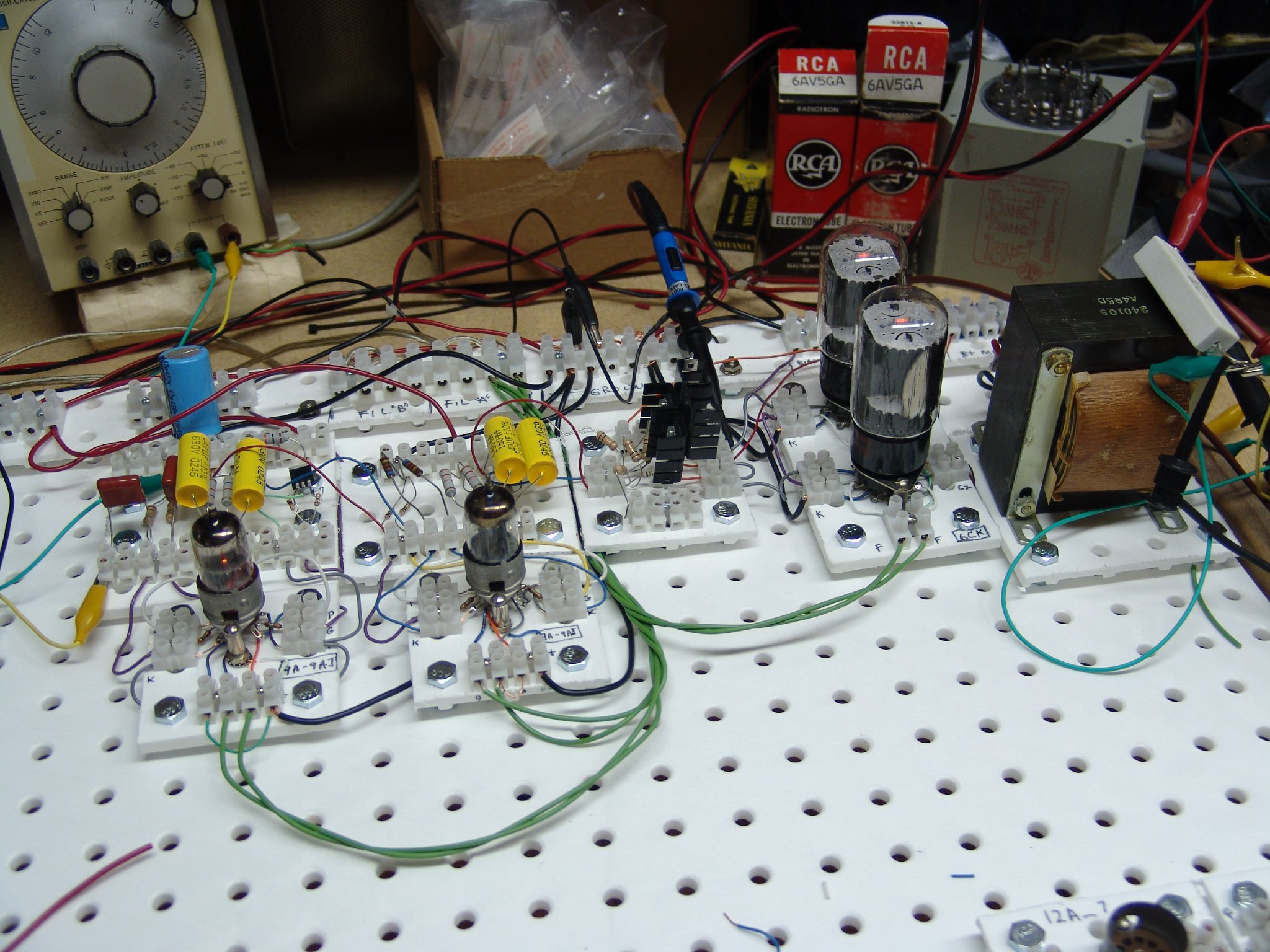

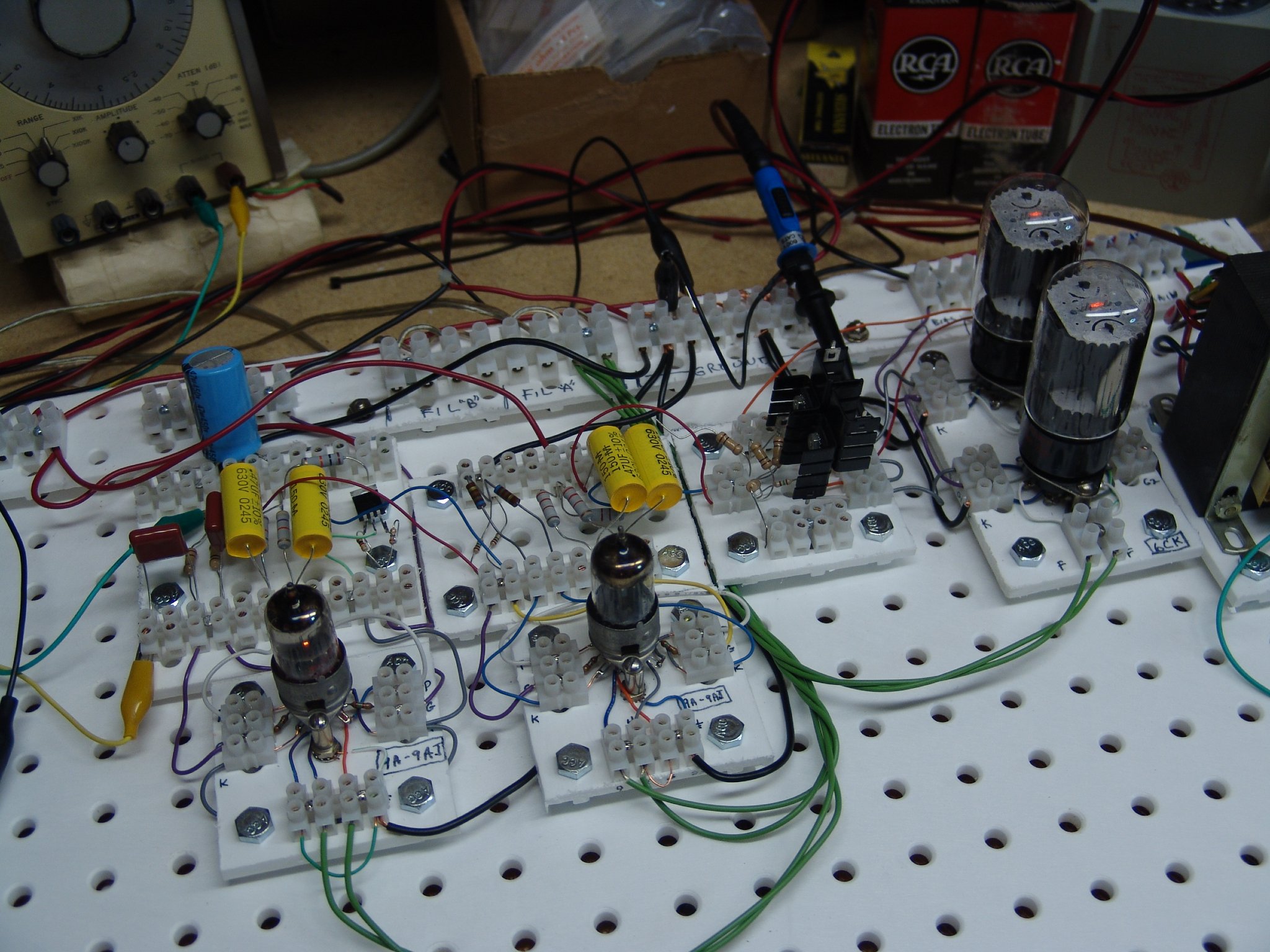

TubeLab 1 had provisions for a lid that could be closed for experiments that could end badly. I got that idea after setting an OPT on fire when my Radio Shack dummy load blew open when I was squeezing about 150 watts from a pair of sweep tubes on over 700 volts. Unfortunately the lid was designed to fit the 45 tube seen in the early pictures, the 845 and the 6LW6 did not fit, so the lid never got used. I decided to reuse the base from TubeLab 1 to make TubeLab 3, but since there was no lid, I cut the outer rim all down to about 1.5 inches, added a row of connectors across the back for power supply connections, dropped in a piece of plastic pegboard and created several drop in modules for the popular tube pinouts.
TubeLab 3 can be seen here with a fully functioning 80 watt push pull sweep tube amp being tested. This system worked fine and was used until I packed up everything I owned and moved it all 1200 miles. The base of Tubelab 3 is here, but none of the individual modules have been seen since the move. Lots of other stuff disappeared too. I have pulled off lots of amp designs since then by hacking up old boards or laying out prototype boards and tweaking or hacking them into something useful.
These prototypes often start from an LT spice simulation. It's pretty easy to set some specs for the simulator and tweak parts when the goals coincide with measurable quantities like a certain power level with as low as possible THD given a descending harmonic profile. Now, I want to 'reinvent" the vacuum tube guitar amp. How do I ask LT spice to make it "ROCK" and go PAST 11? I need to play with REAL Parts and maybe melt a few tubes!
The parts that were ordered will be used to make new modules, so TubeLab 4 will be much like TubeLab 3, except those screw terminal interconnects have to go. I'm experimenting with several alternatives and more than one type will likely be used.
