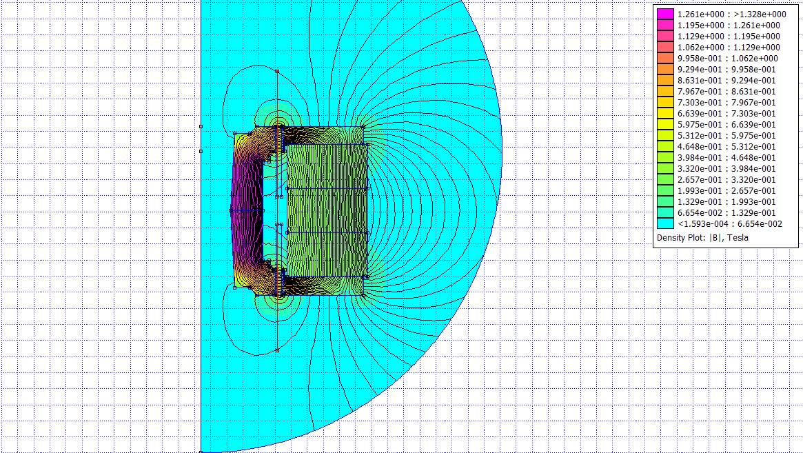

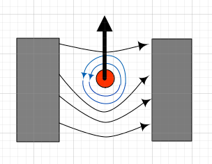

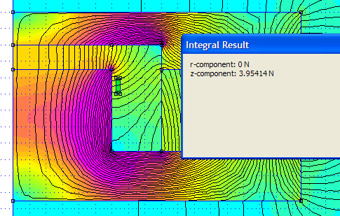

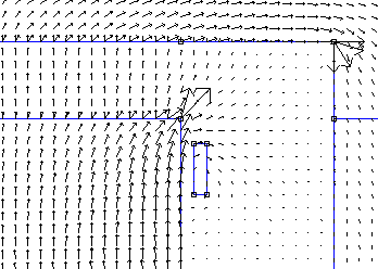

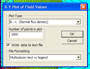

Please note when exporting flux data from FEMM, the (Normal flux density) curve must be used:
attachment.php
The exerted force felt by the coil depends on the direction (or angle) of the flux. This is the flux that is perpendicular to the coil. The straight is the tangential.
So, sqrt(perp^2 + tang^2) = magn of flux density and, angle = atan2(perp,tang)
Here is a short proof:

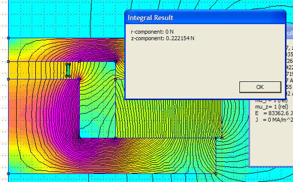

in the 1st image below the coil is put in a field where the angle is not perpendicular, therefore BL is just 0.22, in opposed to the 2nd image where the angle is more perpendicular, now BL is ~4.0. The next images show the directions when only the magnet/coil is enabled, respectively.
attachment.php
attachment.php
attachment.php
attachment.php
(this is how the force roughly looks like: )
attachment.php
Next time i will share the application and the details, how to use it etc..

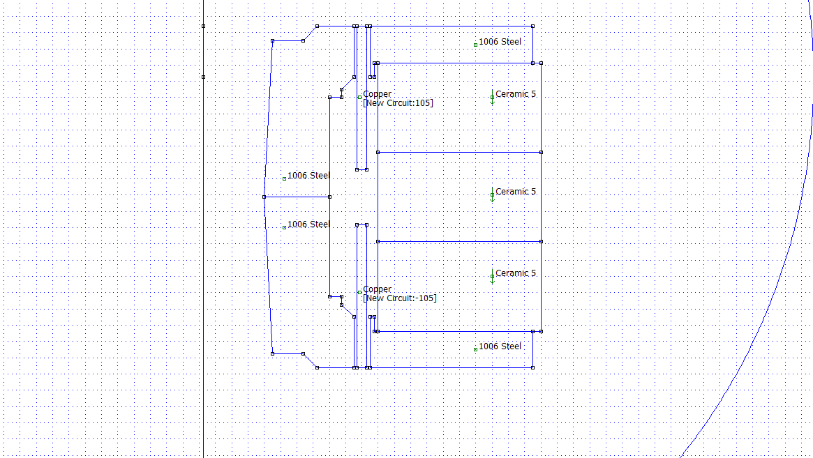

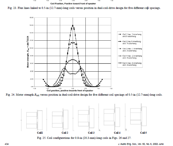

DDD coil:
Yup. That's it alright. Been a while Since I fixed up that WGTi.
One thing I saw with that simulation of the DDD motor, is that the coils appear to be centered on each magnetic gap, where as in reality they are offset towards each other so that only the last 0.5" of each coil are within the physical measurement of each 0.5" gap. That's how it is for the mobile audio subwoofers anyhow.
Hi OscarS,
It's good to see someone who does reconing on subs.
There was a time when i was interested in getting bad/misadventurous subs and fix them. It's worth to do that. At least for their NEO structures.
Do you mean this way: ?
attachment.php
attachment.php
According to the simulations, the BL curve is not better. But i'm going to give it a try in FEMM, and see the real results of the evaluations.
Akos
The issue I see with your model is that you don't have enough space between your magnetic gaps. Notice how there is 0.53" in between the 1.4" long coils on the former. With this spacing it allows the coils to be "inner hung" without having any windings outside of the magnetic caps. Here is what I'm talking about:
So to correctly model the W12 and W15 GTi subwoofers, you need to have the 0.5" long magnetic gaps 2.33" apart (on the inside). This places the gaps at the outermost end of each coil's last 0.5" worth of windings.

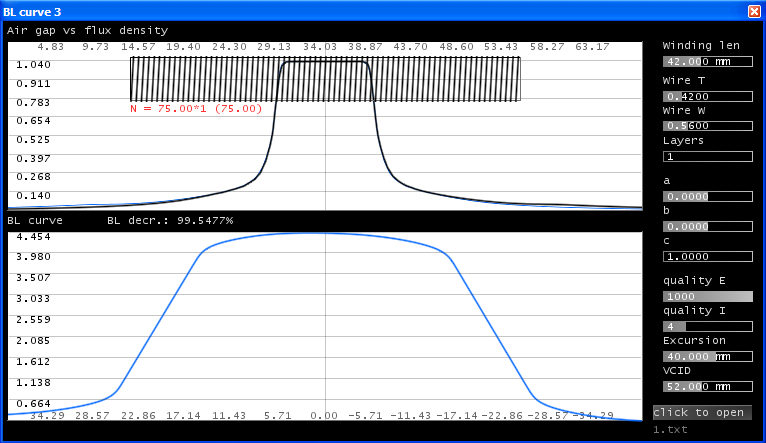

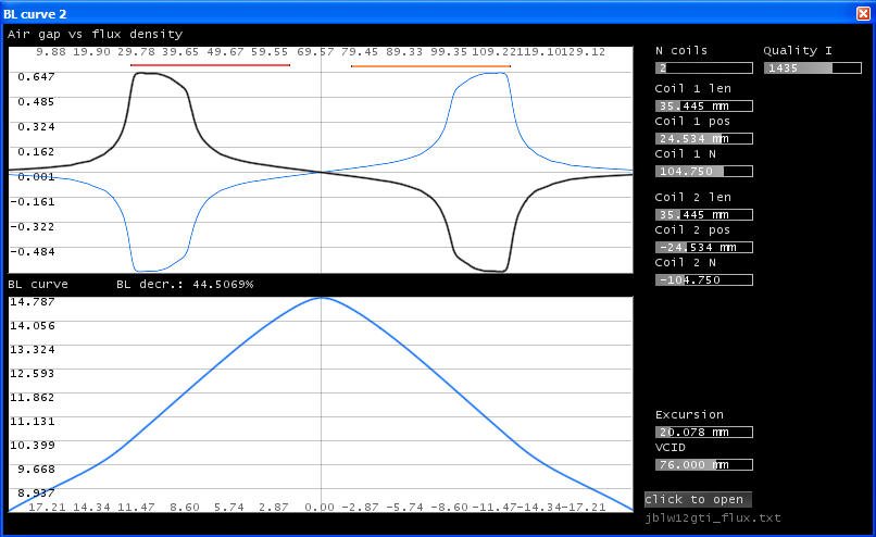

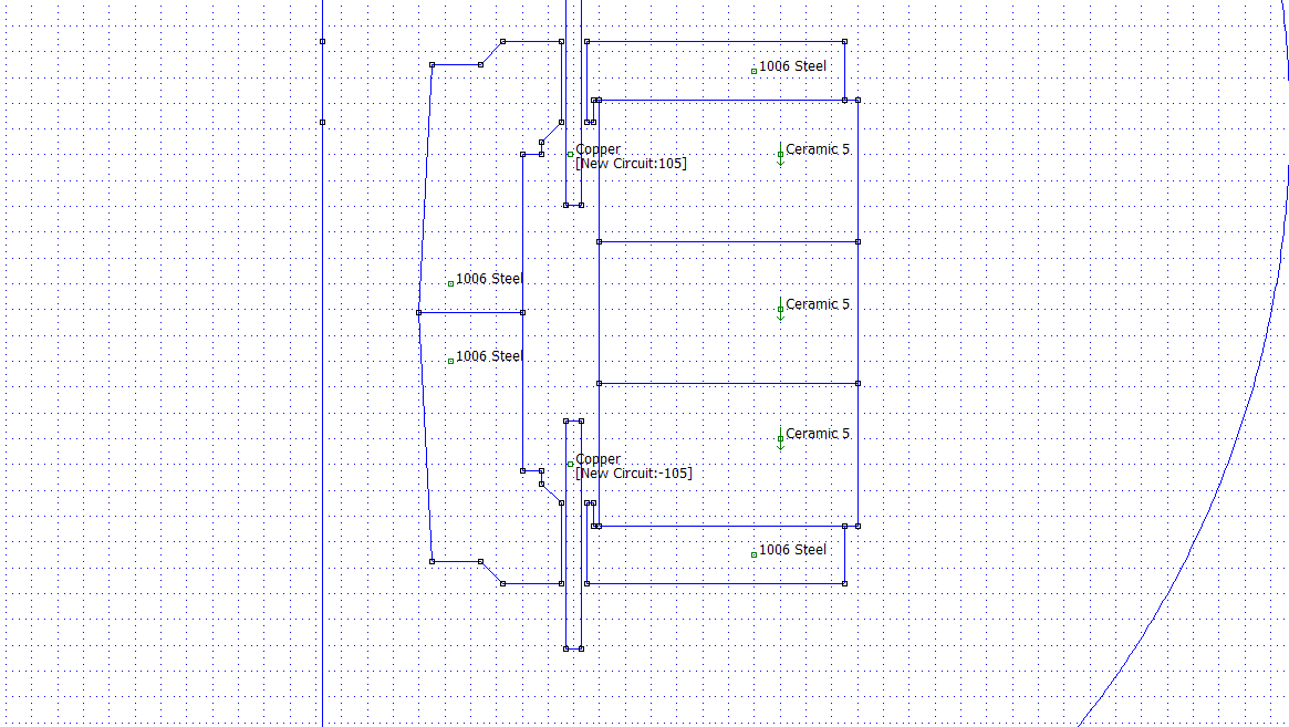

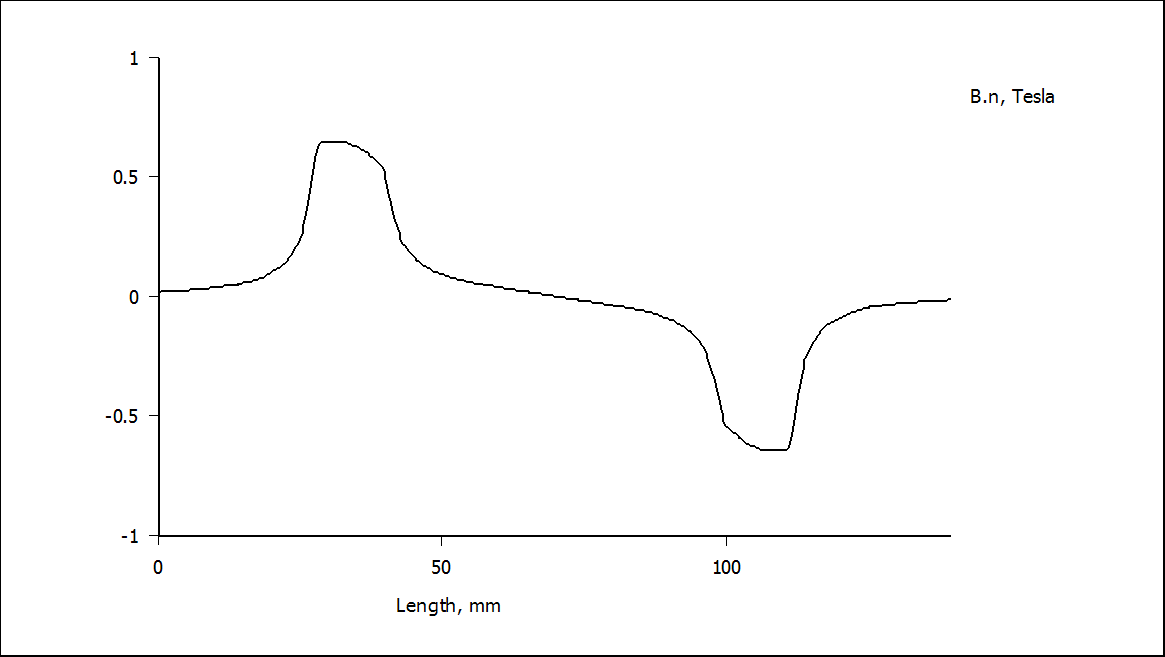

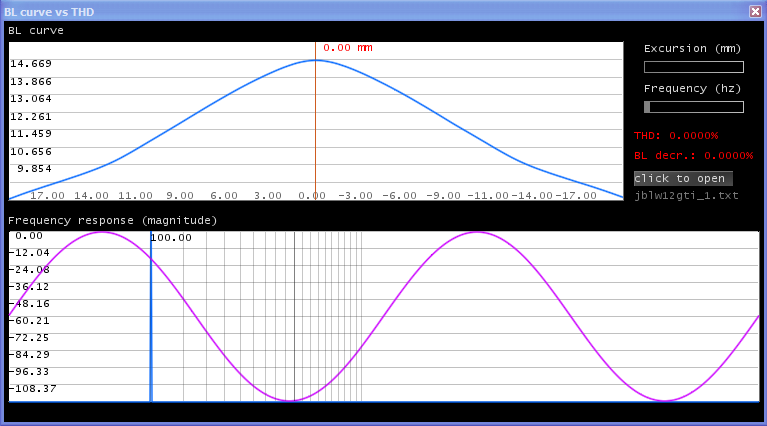

I did the modeling for the JBL wgti. In order to model the system right, it would be great to know how the structure looks like actually. This is just an approximation:
attachment.php
attachment.php
flux:
attachment.php
This is the BL curve given by FEMM:
attachment.php
And the BL curve given by my app: (pretty much the same)
attachment.php
attachment.php
And here are those curves I was talking about: (see post #20 3rd image)
attachment.php
Well, anyhow the wgti series sound, the BL curves look like these. I found contradictory information on the web some stating that wgtis have straight curves and others that it doesn't. Actually I don't know anymore 🙂
p.s. The coils were connected in series.

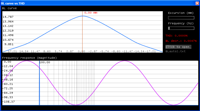

First, here is the app:
app.zip
Anyone reading please use it carefully, as it is beta.

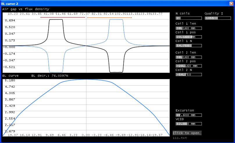

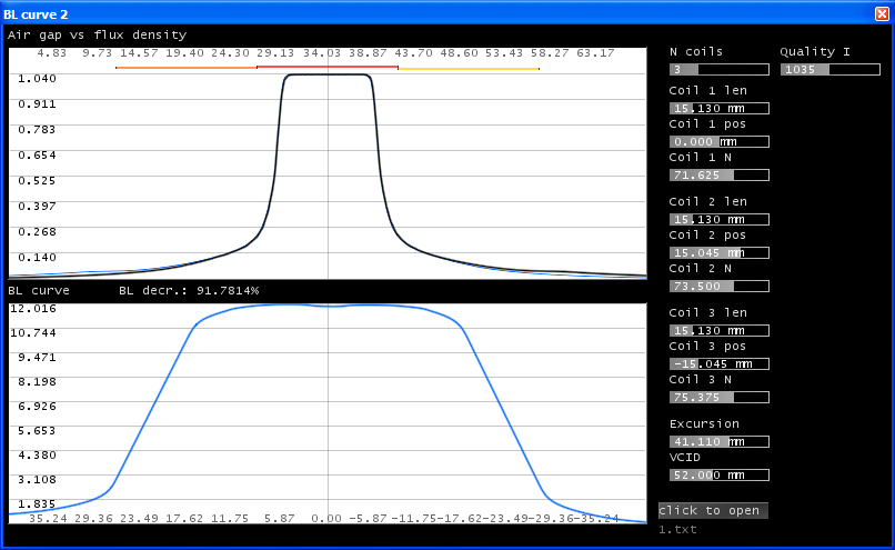

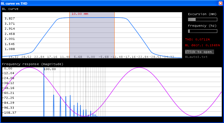

Furthermore, I wanted to say a few words about my actual ideas of better BL curves.

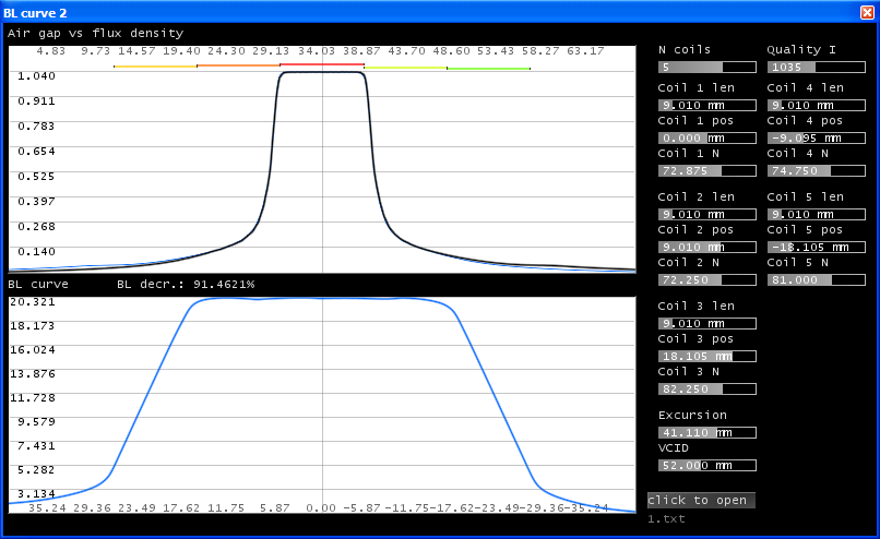

First, I experimented with the coils, and found out that using 3 or 5 coils with different densities results in a more linear BL:
attachment.php
attachment.php
This is a kind of LMT winding but the results are not perfect.

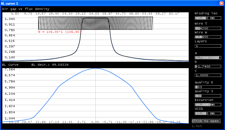

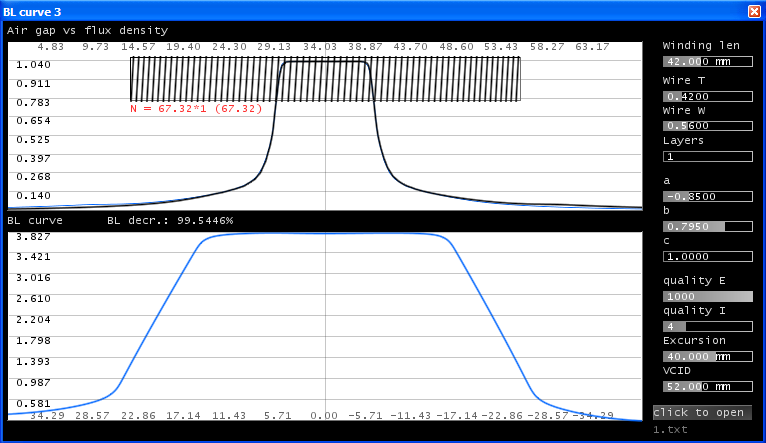

Therefore I did a third app i wanted to show. I was thinking about gradually-wound coils for a while so i did an application that calculates such a gradually-wound coil. There are more turns at the ends of the coil, and fewer at the inside:
attachment.php
attachment.php
attachment.php
attachment.php
The BL curve is excellent! Parabolic curves are used to approximate the linear BL figure. The distortion figures are also shown. Furthermore, the winding data is calculated in a txt file too. It's a good question whether such a professional winding machine exist, but it's worth to try it.
Here is a strong opposite winding just to show how it looks like: (There are more turns at the center)
attachment.php
I hope this was useful.
Akos
