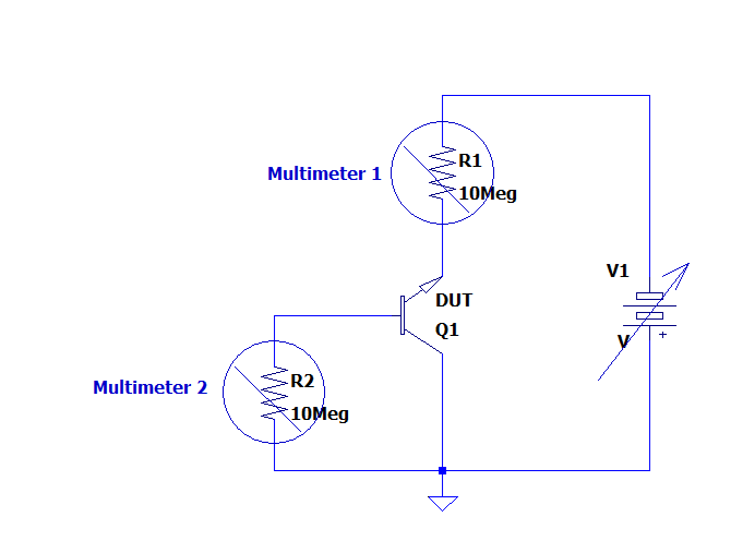

If you want to check the beta of a transistor, here is a simple, improvised test-jig example:
You need two standard digital multimeters used in the 200mV range, and a supply capable of going <1V.
You adjust the supply to read a suitable voltage on multimeter 1, for example 100mV if you want to make the measurement at 10nA and you read the corresponding base current on multimeter 2 (preferably having a resolution of 20K points or greater).
The rest is just arithmetics.
This method will make the measurement at a low Vce, with Vcb=0 thus quasi-saturation which doesn't help the gain since the Vbe will be 300 or 400mV at this level, but it gives a conservative estimation.
If you add Vbe's in series with the base, you can increase the Vce (use only transistor junctions, not diodes like the 1N4148 which are gold-doped and will drop ~0V at this current level).
Keep the setup compact and well grounded to avoid perturbations, and if you see anomalies, shunt the multimeters with plastic capacitors of 100nF or a few hundreds of nF

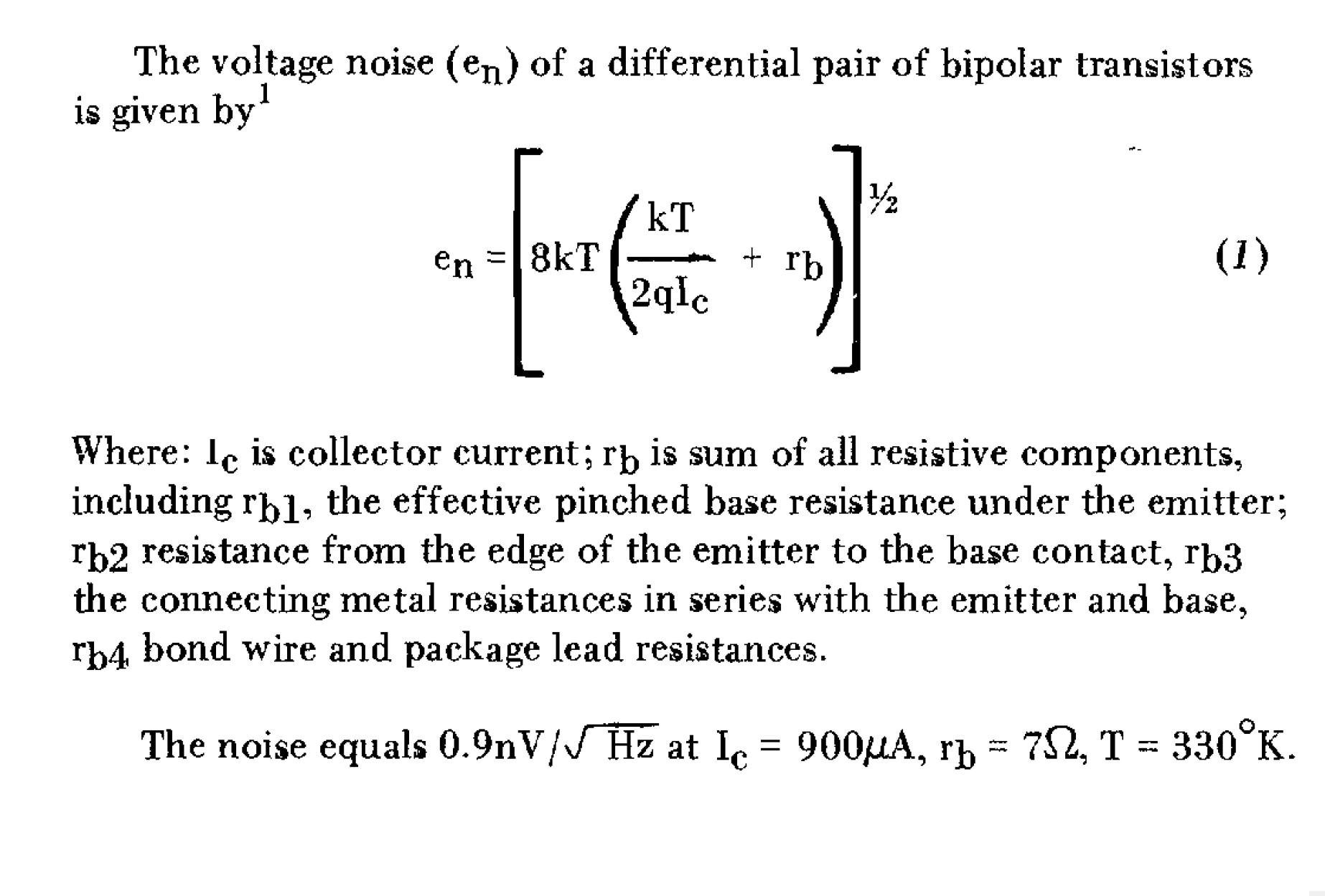

Yes, George Erdi's excellent technical paper "A Bipolar Opamp with a Noise Resistance of less than 50 Ohms" (link) goes over this quite thoroughly. Each of the NPN transistors in the input long tailed pair runs at 0.9 milliamperes of collector current. Beta of these devices is 200, and quite surprisingly, the total base resistance including on-chip wiring and bondwire+package wiring, is rbb = 7.0 ohms ... ... ... not nearly as good as discrete transistors we can buy for $1.50 from Mouser.com. The opamp's datasheet guaranteed maximum input noise density is 1.1 nanovolts per root Hertz.
I snipped out Erdi's equation (1) and attached it below. Notice that Ic appears in the denomimator. Thus an increase in Ic is accompanied by a decrease in noise.

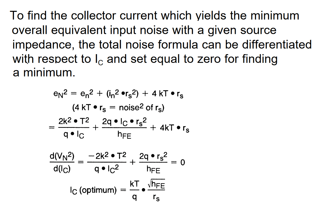

The voltage noise, yes. An increase in IC also leads to an increase in IB, which aggravates base shot noise which contributes to the equivalent input noise current. For a single-transistor input stage, if base and collector shot noise and base resistance thermal noise are the only non-negligible terms, there is an optimum at
re ~= |Zs + rb|/√hFE
or
IC ~= (kT/q)*√hFE/|Zs + rb|
where rb is the base resistance of that single transistor. For a differential pair used in an asymmetrical manner, the optimal collector current per transistor is √2 times as high.

Texas Instruments' application note AN-222 agrees with you, Marcel. They omit the "rb" term, assuming that Zs is much much greater than rb.
Plugging in the Zs number from post #16 of this thread, and plugging in Beta & rb from post #24:
Ic_optimum = (0.026) * sqrt(200)/(150 + 7)
Ic_optimum = 2.34 milliamps
which gives eN = 1.63 nanovolts per root Hertz using a 150 ohm source impedance, a transistor with Beta=200 and rb= 7 ohms, and a collector current of 2.34 mA . The third and final term of the eN_squared expression, completely dominates the other two. The source resistor itself, is the dominant contributor to total voltage noise.
