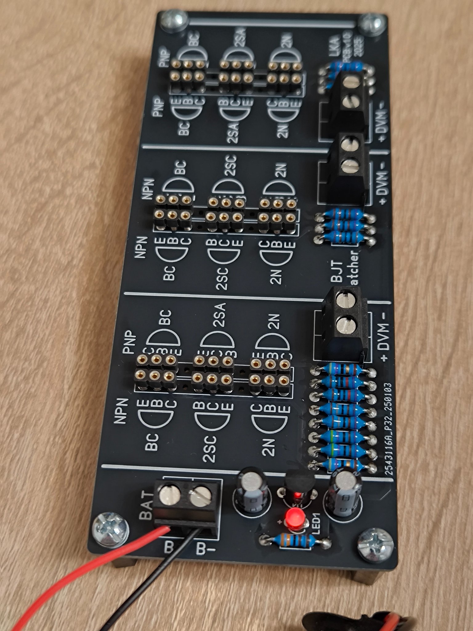

BJT Simple Matcher -- test jig presented at 2024 Burning Amp Festival
This is probably a dumb question because I'm really good at asking those, but I'm going to ask anyway....
If one wanted to try to match P to N BJT's, can this be done with this circuit? Set a reference P-channel for instance, and then cycle through N-channels until a match is found? Feel free to tell my why it's a dumb question. I'm expecting that :rofl:
This board will let you match (NPN_Vbe) against AbsoluteValue(PNP_Vbe), yes. If the NPN_Vbe happens to be +0.6111 and if the PNP_Vbe happens to be -0.6116 then the meter will read ±0.0005 volts, sign depends on which one is plugged into the left side socket and which one is plugged into the right side socket.
However, ask yourself the harder question: is VBE_Mismatch what you actually want, between PNP's and NPN's ?
What sort of circuit works best when a PNP transistor has exactly the same AbsoluteValue(Vbe) as an NPN transistor?
Perhaps your circuit wants the PNP and NPN to have identical current gain (Beta) instead? If so then this Simple VBE Matcher is the wrong tool for the job.

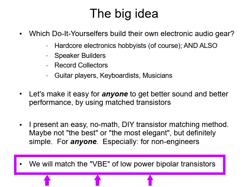

_
