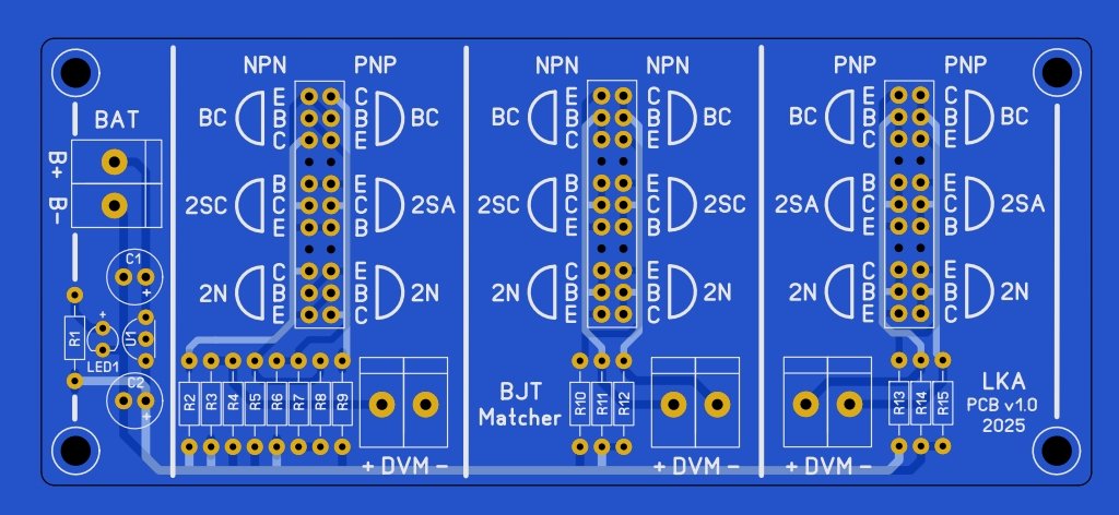

It might be a good idea to rephrase the question-- to make it more general and more open ended (?) Perhaps something like
Does anyone see a way to make this BJT Simple Matcher PCB, match other types of semiconductor devices besides Bipolar Junction Transistors? Does anyone see a way to make this PCB match JFETs?

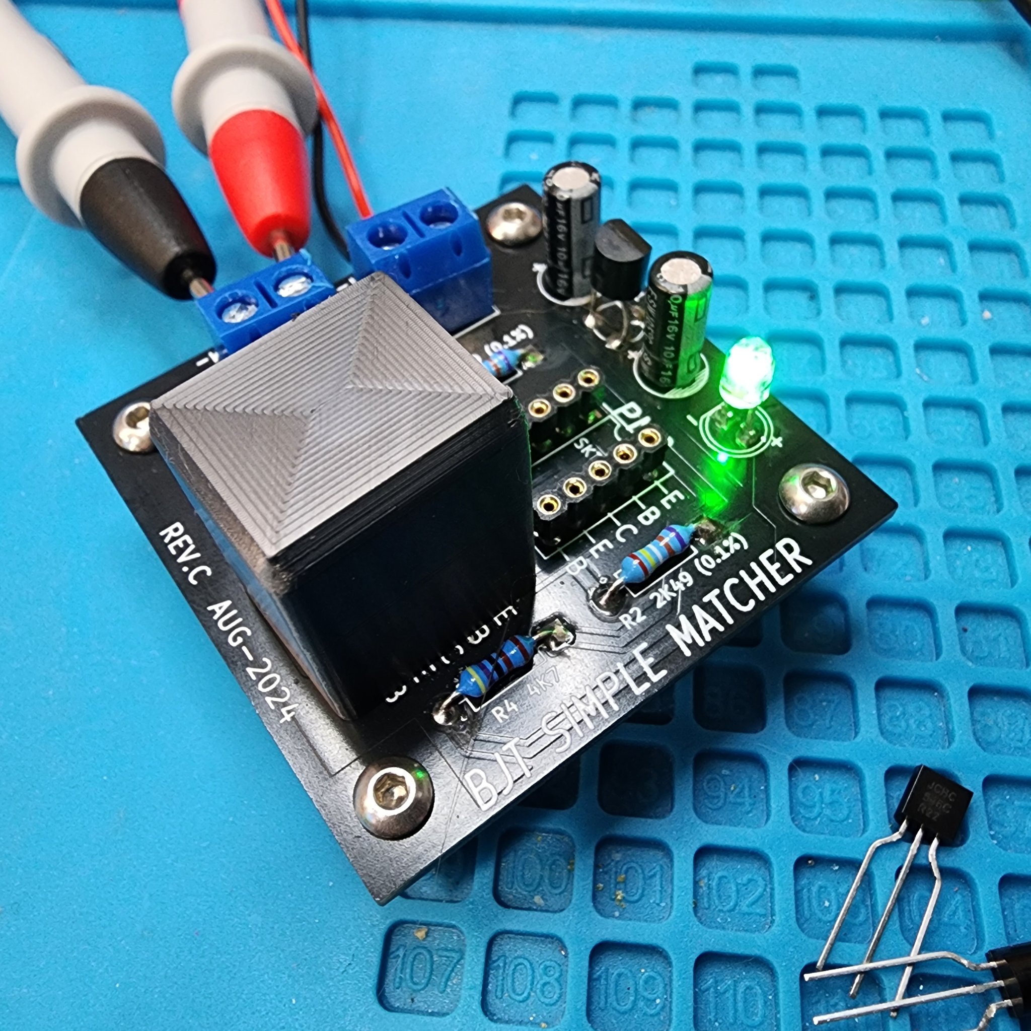

I'll also be working on a 3D print design to use as an "Air Lock Box" for the BJT Simple Matcher. I will post print files once I've optimized the design with some iteration on prototypes.

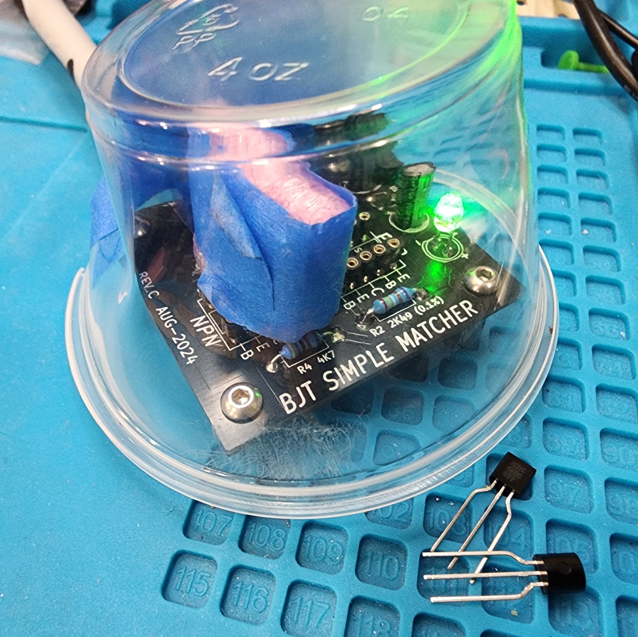

First time ever matching transistors. The BJT Simple Matcher works great. I'm using a little 4oz cup as an "Air current shield" currently. I plan to build a little 3D printed cap eventually. Since my work bench is right under an air vent the shield from air currents does help out with consistent measurements.
Lots of fun and lots of learning for a noob like me. I love it!
Thank you Mark!

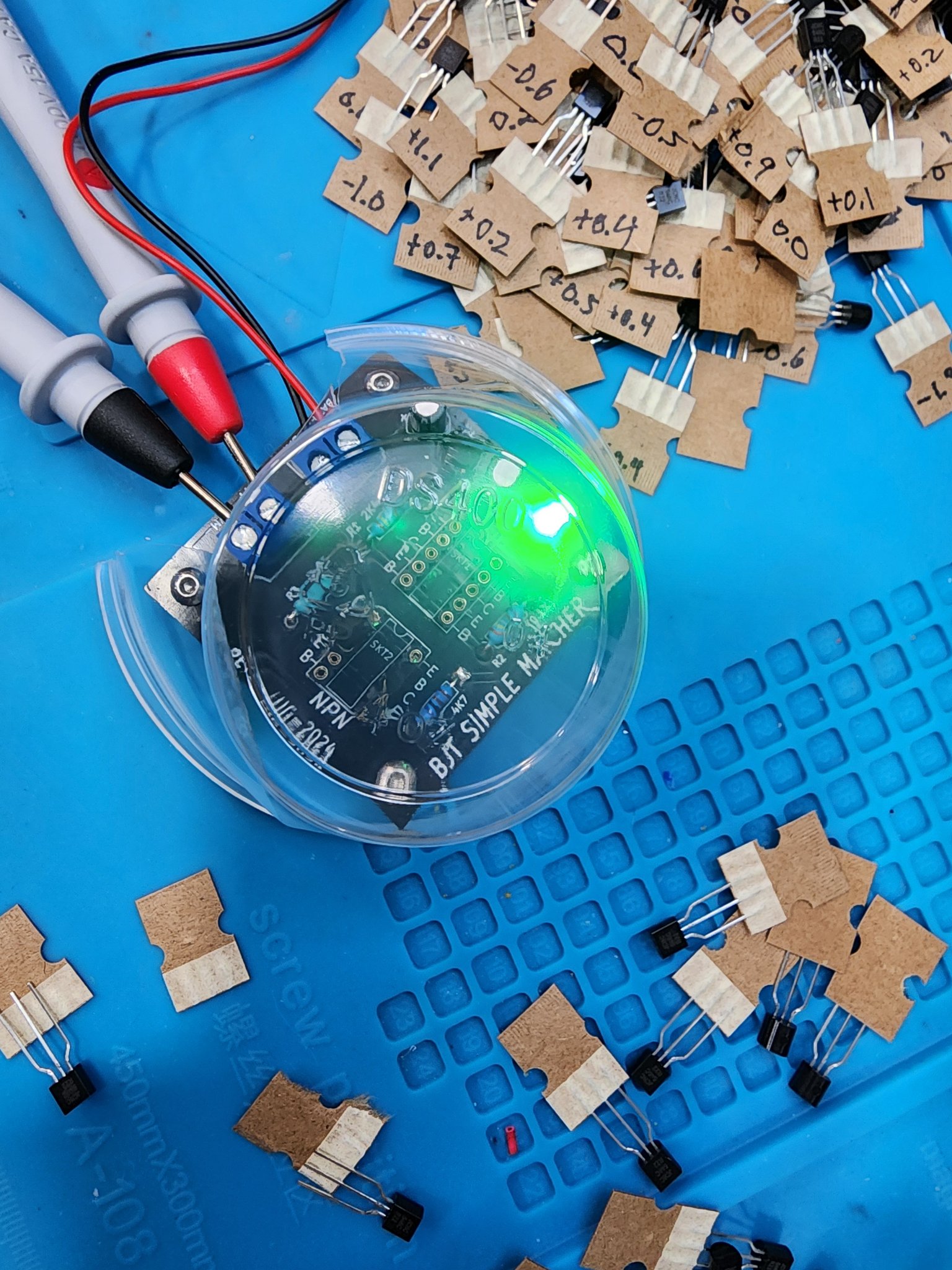

Here's a little 3D printed "air current shield" design that fits nicely over the BJT Simple Matcher to help with consistent measurements on a drafty bench area.
Here's what I had rigged up prior to making the 3D print design. It also worked fine, but not as clean.
