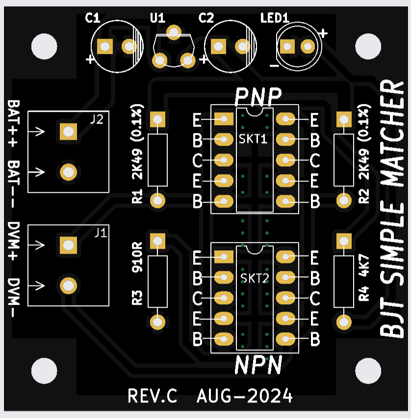

I handed out PCBs for this BJT Simple Matcher jig, during talk#3 at Burning Amp yesterday. For those who couldn't attend, I've attached the Gerber .zip file below. You can send it to a PCB fab and have some boards shipped straight to you.
If you haven't yet ordered PCBs from an online fab, it's fairly easy and painless. Here's a brief explanation: Ordering PCBs online (using Gerber files): A walkthrough -- featuring the fab "JLCPCB"
Unfortunately, some of the figures in my "slide deck" didn't render very sharply on the projection system, so I've included the entire presentation below in .pdf format which features infinite resolution vector graphics. The presentation slides are fairly self-explanatory, so this Forum post includes only a few addenda:

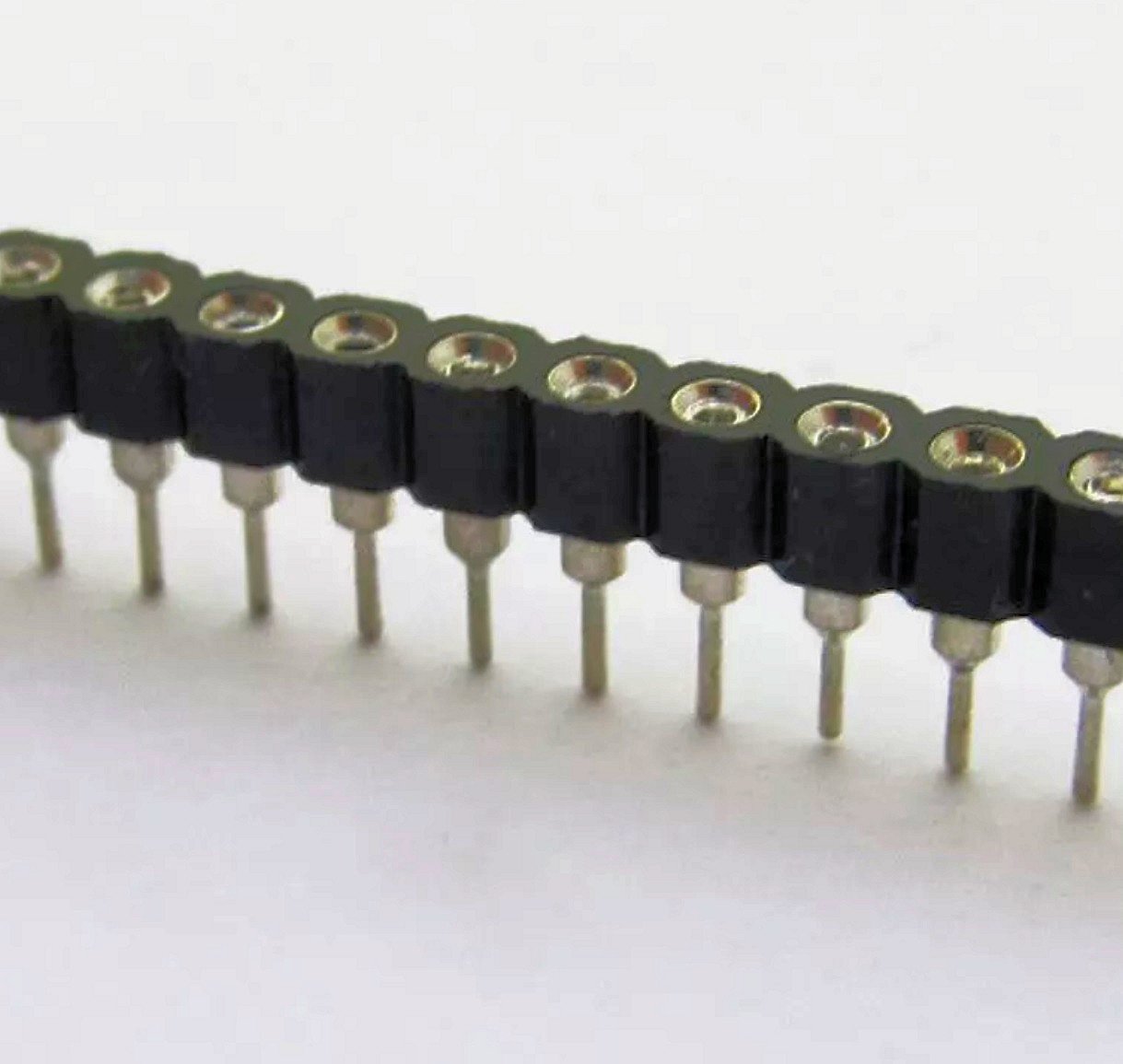

1. There are sockets for four transistors on the board. Two 5-pin sockets for PNP transistors, and two more 5-pin sockets for NPN transistors. These are arranged so that if you happen to own some 10-pin DIP sockets {which are uncommon}, you can fit two 10-pin DIP sockets on the board. Otherwise just fit 5-pin single inline "breakaway" sockets as shown in the picture attached below. I handed these out to BAF24 attendees; they are inexpensive if purchased from eBay. Here are a few eBay product titles:

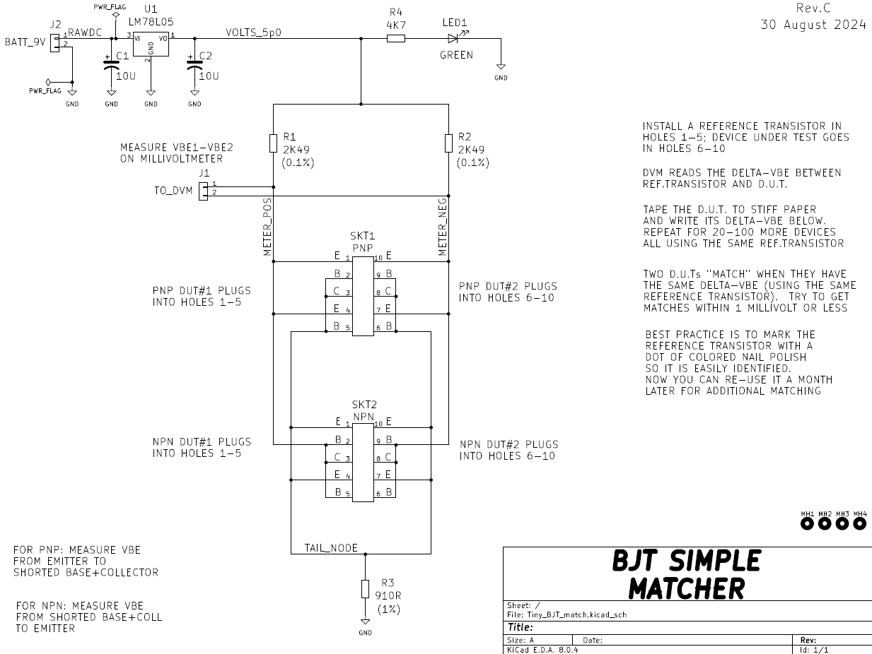

2. The circuit schematic diagram in .pdf format is attached below. That's the one to print, since .pdf has infinite resolution. Instructions for using the Simple Matcher jig appear right there on the schematic. And of course, also in the presentation slides.
3. To maximize the life of the 9V battery, I'm deliberately running the LED indicator at very low current. Please compensate for this low current by fitting a super bright LED. The LED part number called out in the Parts List attached below, shines at nineteen thousand milli-candelas. That's pretty bright.

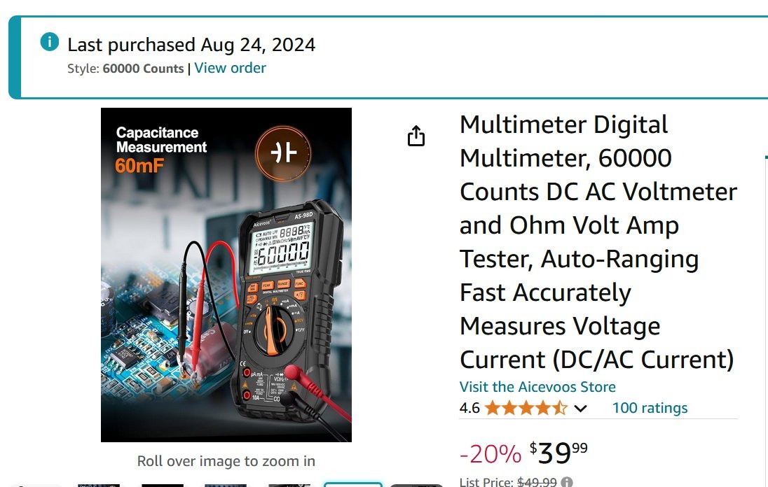

4. As promised during the talk, I've included an image of the inexpensive handheld meter I purchased for matching, which has 0.1% basic accuracy and whose DC voltage display goes down to tenths of a millivolt. It's not the only possibility, it's probably not the very best, but it's relatively cheap and relatively easy to buy. However, as emphasized during the discussion, you will get "a lot better than nothing" matching results, even with the cheapest meters that only go down to 1 millivolt resolution.
5. The schematic includes printed instructions which tell you how to use the BJT Simple Matcher PCB. Just print out the (.pdf) schematic and bring it to the measurement lab, on the day when you're doing the matching work.
6. "AIR LOCK BOX"?? During my BAF presentation, an audience member's question (@ timestamp 27:29 in the YouTube video) included a remark that in his own matching efforts with another jig, it was useful to cover the entire test jig with a (removable, 5-sided) box made of insulating foam or foam-core. This minimized air currents around the two transistors being measured, and therefore sped up the thermal equilibration of the transistors. If I'm remembering correctly, his arrangement took about 60-90 seconds to get a stable delta-VBE reading {on a different jig}, whereas my slide deck says 90-120 seconds for this BJT Simple Matcher jig with no box. So it might be a quick and inexpensive experiment that you may wish to try; possibly a box could speed up your hour-and-a-half marathon of matching. Several attendees were also concerned that the human test operator's breathing, might create unwanted air currents which slowed the equilibration process. An insulated box separating human and jig, might mitigate these concerns. I speculate that a box 125 x 125 x 75 mm (5 x 5 x 3 inches) would be a handy size to easily cover the BJT Simple Matcher board and wire leads.
Code:
50Pcs 40Pin 2.54mm Single Row Round Female Pin Header Socket gold plated
10 Strip Tin PCB Panel Female IC Breakable 40 pin 2.54mm Row Round Header Socket
10Pcs 2.54mm Pitch 40 Pin Single Tin PCB Panel IC Breakable Round Female Header
5x Strip Tin PCB Panel Female IC Breakable 40 pin 2.54mm Row Round Header Socket
2Pcs 40Pin 2.54mm Single Row Round Female Pin Header Socket gold plate

Many thanks for this Mark - that will be very useful, I will get one made up.
Can I also ask, on page 5 of your pdf slide presentation you mention "Yes it will drive an F4" a new bonus pcb that has its own diyAudio thread. I can't find it on the forum, do you have a link to it, thanks.

Well I have all the parts on hand for the BJT Simple Matcher by @Mark Johnson , except I thought I had 4.7k for R4, but closest I have on hand is 4.75k. From the schematic, it appears that R4 is just dimming the LED, so 4.75k should be totally fine from that perspective..... however, I wanted to ask just to be sure I'm not missing something.
I realize it's probably a dumb question, but I have been known to ask many of them, so apologies for another.
You are correct in your schematic reading.
Where's my "That was easy" button at.....
Went together fast. Now I just need to wait for my 100qty BJT's to match.
