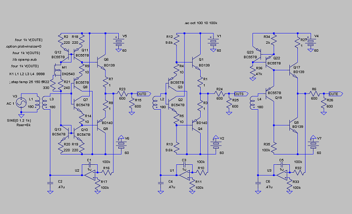

Found this old thread while searching for a buffer for a hybrid phonostage I am working on.
Had to compare the Walt Jung concept against an adjusted version of the circuit from the first post(current-PI). Contrary to the negative judgements this one works splendid in Spice environment.
It is for feeding 50Vrms into 1,2k even if the nominal input voltage is 1,2Vrms. Don´t mind the two 600ohms, just think of it as a 1,2k load!
The last one is at least as good as the others wrt overtones (even better as it has lower 3rd and a litte higher 2nd), phase and frequency respone.
Used the std spicemodels I had. I am not into solid state so please explain what is wrong to use the concept from the first post?
http://www.eflatjump.se/BJTbufferjfr.asc
