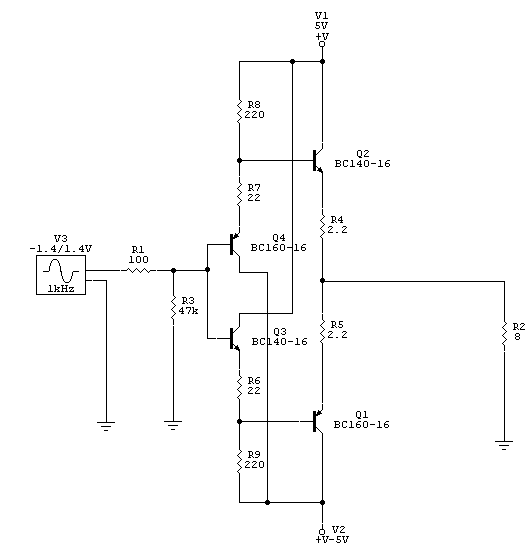

I found out that I use only very little voltage when listening in my small room in the evening. Thus I wanted to design a class A voltage folower using BJT's capable of driving 8 ohm speakers and 32 ohm headphones at 0.7 volt RMS. I have come up with this circuit.
Can anyone help me with a improvement on the topology?

Hi Darkone: thanks for the schematic, since AC coupling at the ouput is OK for me the offset is no problem, but I would like to try to DC couple the buffer some how..
Hi papa Harry
.. us kids allways simulate before firering up.. but thanks for the warning. I just finished reading app note 227 of Nat Sem and this might give some inspiration.. I'm still aiming for a buffer with low component count and reasenable performance. Maybe you've got any ideas?

Low distortion from a BJT buffer (diamond) => highly linear current gain and a high idlecurrent. of course without feedback!

Good for you that you skiped the first verision! I think that the highly unsymmetrical output stage would create rather much distortion if you had used it without feedback (even with feedback) . 5-10 ohms for positive half period and 1-10 kohms for the negaitve.
If you want even lower distortion use current generators instead of the 220 ohms resistors. Check my current feedback amp for inspiration. I have tested my design in real life. Works good.

I think that Paranders sugestion of to change the 220 Ohms resistor for a CCS is a good one for 2 reasons:
-As Paranders says it will have lower distortion with the CCS.
-A CCS will have muche more isolation from power suply noise and the circuit will be more independent of the quality of the suply...always a good thing!

The emitter resistors are too high. A variation I use moves R6 & R7 to the bases leads of Q3 & Q4. You can adjust these to change the output current. The outputs should be at least 100 mA to keep output Z down.
Another variation puts a simple follower in series between the supply rail and the outputs, to increase PSRR.

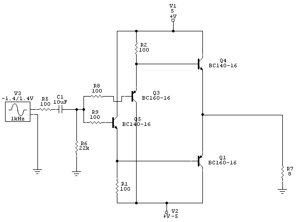

The four transistor buffer you are proposing to use is fine for relatively light loads (>1kohm) but I understand you are proposing to use it with 8 to 32ohm loads. In which case, the circuit with a simple output pair will not have adequate drive capability to maintain acceptible distortion levels. I suggest you consider replacing your Q1 and Q2 with Sziklai pairs (CFP), adjusting resistor values as necessary to maintain your desired Iq.

Hi all,
I would like to thank you all very much for your replies, since nobody seems to care about this project of mine. I don't care, I still think it's a good idea.
I've simulated alot the past vew days, all new proposed circuits were improvements on the former. i have faith this idea is going to work out just fine.
I went to the electrical shop this day and got myself the parts for three buffers, including voltage regulators, for 12 Euro's. This is gonna be a cgeap little experiment
Hi Geoff,
I don't think I understand you. Why won't it work?
I simulated the circuit and all I can see is that it should function OK. I intend to use only 1Vrms as input maximum, and use 100mA Iq (class A) for the ouput BJT's. They will dissipate 500mW. Since they are designed for 1000mA, 60Volt, and 800mW they should not break. Ouput impedance seems to be around 0.4 Ohm and input impedance around 6KOhm. Distortion as simulated is around -75dB 2nd and 3rd, all other much lower (-110dB), bandwidth: several Mhz:
Any reason why it won't be a great little low-SPL amp or headphone amp?

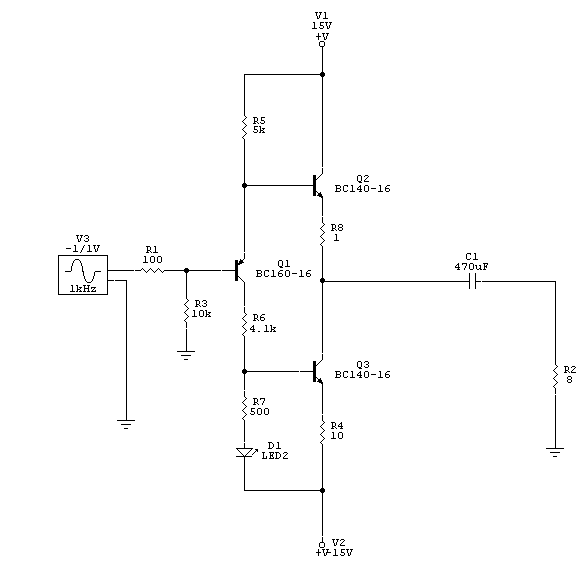

Here is my final (?) version.
