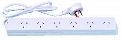

apparently the New Zealand/Australian plugs are the safest in the world. the ground pin is always longer then the other two as well so it makes contact first
this is all a bit off topic anyways
