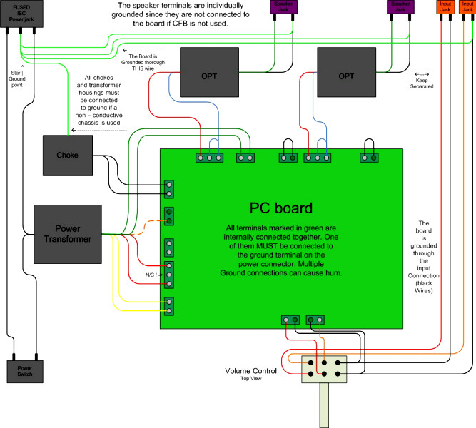

Looking at the photos I think it would be worth taking your DMM and checking for continuity between the speaker posts and ground just to be sure there is none.
Well I deleted the binding posts and just ran some wire out of the holes and connected the speaker wire directly, so it’s not an issue currently.
But if I’m looking at the drawings correctly the negative speaker cable/terminal needs to go to ground right?
Yes but only the negative and that is how I have mine wired. However I suspect the positive on yours may have also had some connection to ground. Also even on the negative side multiple paths to ground may cause problems with hum so it's good to verify both positive and negative.

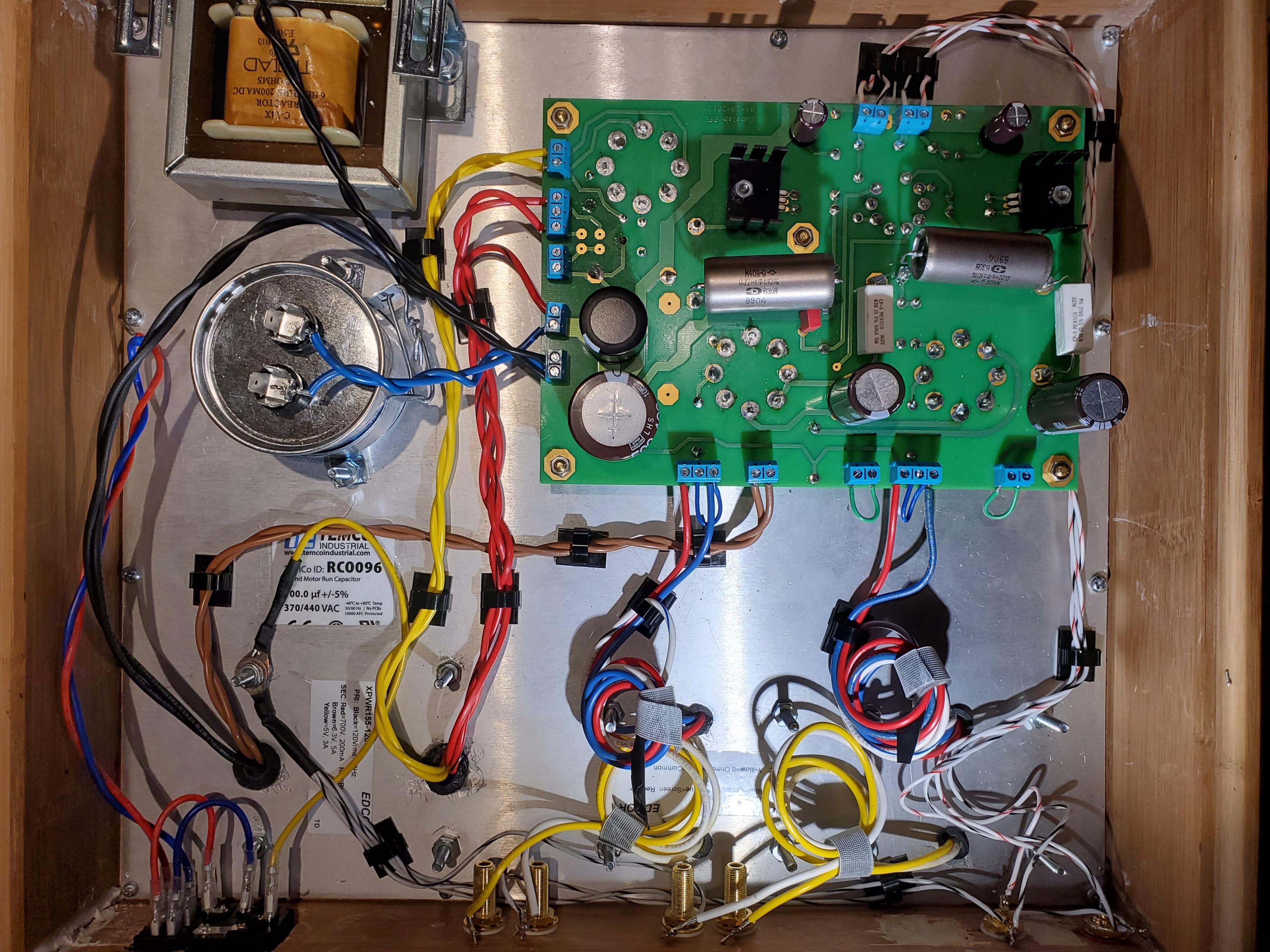

This may or may not help, but here you go. See edit.
I am also using Edcor iron and have the same color codes.
Here is a hi res bottom picture. Triode wired. No feedback.
Input and output grounds are the black/white stiped wires. Grounding is done by George's wiring documentation in the SSE instructions.

In the first picture the mains A/C wiring IS NOT wired in at all. Ignore that aspect completely.

Yep that’s how I had mine wired except my terminals have tabs on the end of the bolts for soldering/tab connectors. As soon as i bypasses them and went to straight wire it worked fine. Not really sure why other than they produced too much resistance.
