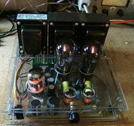

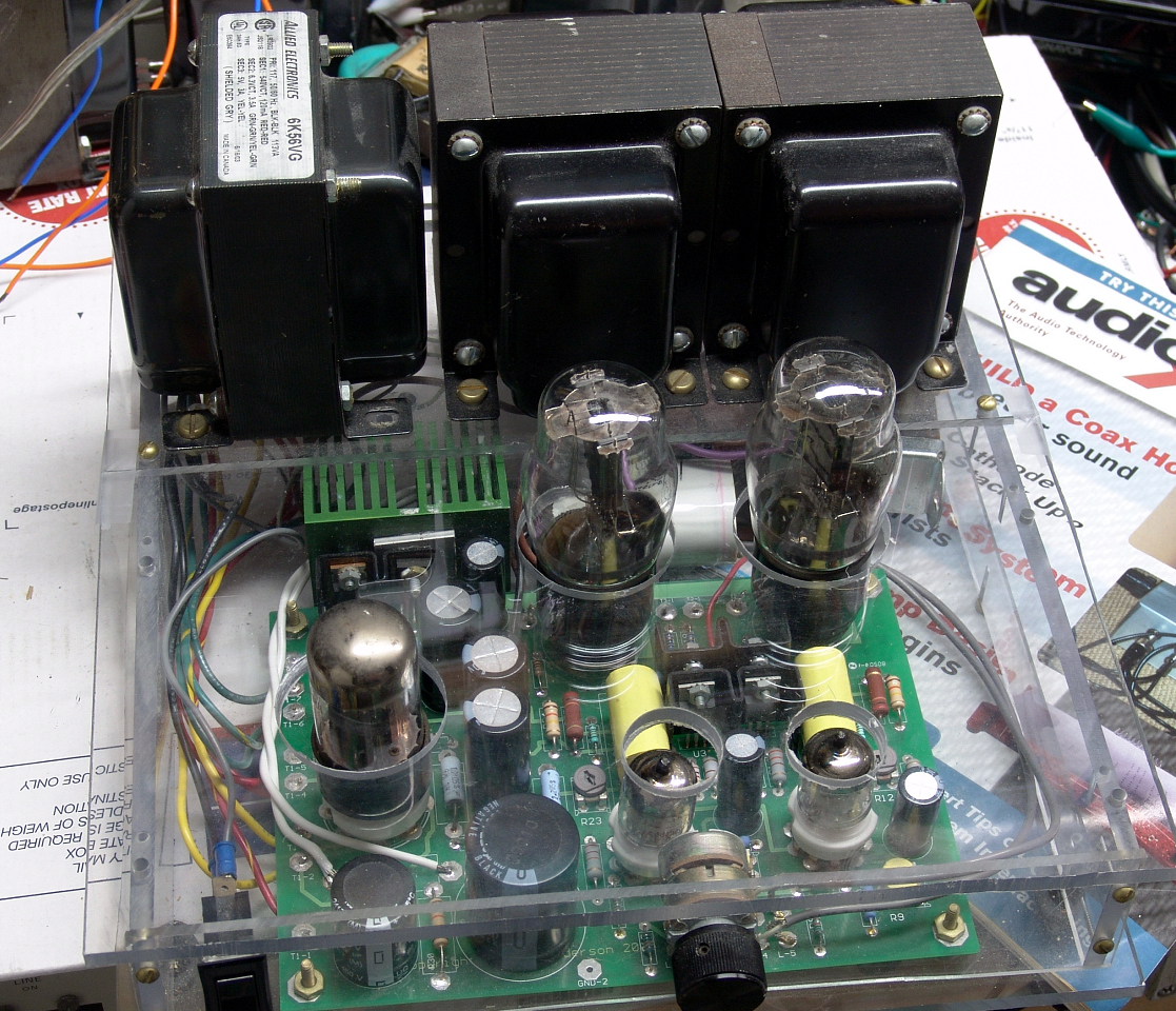

Here is a picture of my Lexan TSE as it was originally built in 2004. Playing all 2 WPC through 88 dB Yamaha NS-10's didn't reveal any hum or other nasties. Note the close and cozy relationship between all the transformers and the general crowded chassis. It still wears it's DIY PC board cooked up on the kitchen stove before the TSE was actually a thing. This board was called SE45-2. The SSE wasn't even a dream then.
I took it over to a friend's house who had some high efficiency Altec Santana speakers, and hum was obvious. The amp hummed through the speakers with NO TUBES in it. There is only one way this can happen. I rotated the power transformer 90 degrees, and the hum was gone.
Some time later the TSE had a date with some 106 dB sensitivity Lowther based horn speakers. Some hum was still evident so I added a choke and supplemental cap to the already crowded amp. The white cap and small choke can be seen stuffed under the OPT's in the second picture. It was taken after the amp got filled full of water during Hurricane Wilma in 2006. I simply drained the water and plugged the amp in to find that it still worked, and sounded just fine. Unfortunately the power transformer fried a few months later. Autopsy revealed it to be all rusty inside. Since I had to change the power transformer, I put a shiny new 2007 vintage TSE board in the amp. I cleaned up the old board with WD-40 and naphtha, and it still works today. It sits unused in a box full of old boards, but I can't bring myself to toss it.
