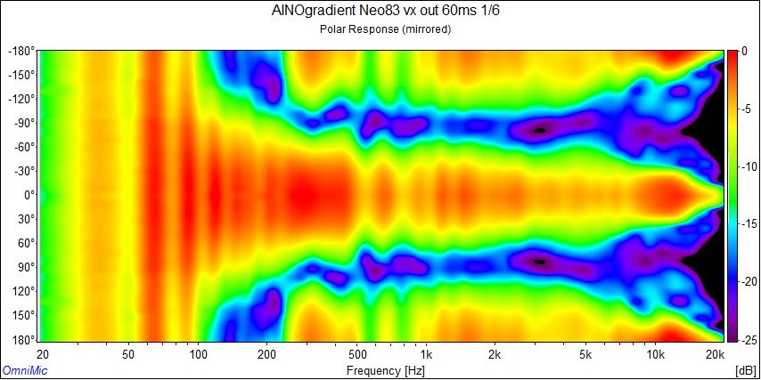

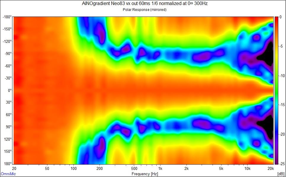

Thanks that’s interesting. Distance from the front wall will be determined by practical considerations but in my experience the dipoles (that these subs will go under) need to be at least 5’ from the front wall and ideally more than that.A bipole (sub)woofer radiates as omnipole (like a pulsating ball), until frequency gets too high for opposing waves to match, typically above 500Hz. And a monopole is actually omni too at low freq, before baffle step starts to happen (but we are more used to thinking of axial spl).
When omni and dipole radiation sum around crossover, the net is cardioid. The wideness of this range depends on type and steepness of the crossover.
Here my outdoor-measured dispersion, with 150Hz LR2 crossover, cardioid range is roughly one octave (-6dB)
View attachment 1214634View attachment 1214635
How does this sound? Pretty good, because sound direction is practically impossible to detect below 300Hz. Major benefit is avoiding front-wall interference, but this happens only if distance and cardioid range match. One can use SBIR calculator to find this correlation. Eg. 500mm distance from the midpoint of the omni to wall gives 172Hz first null.
