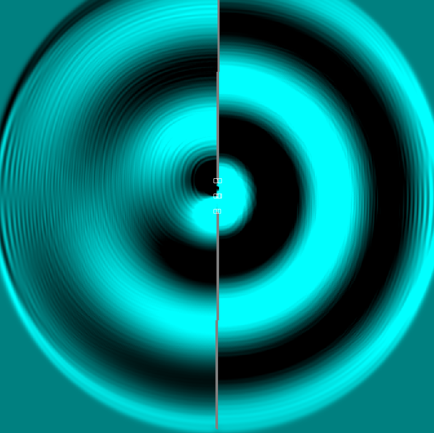

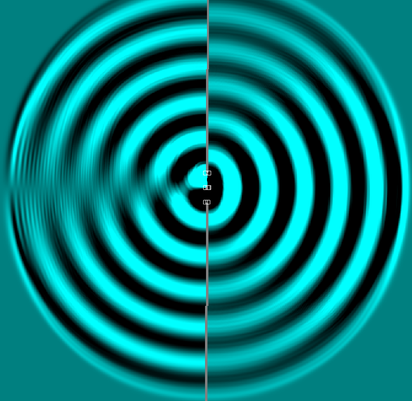

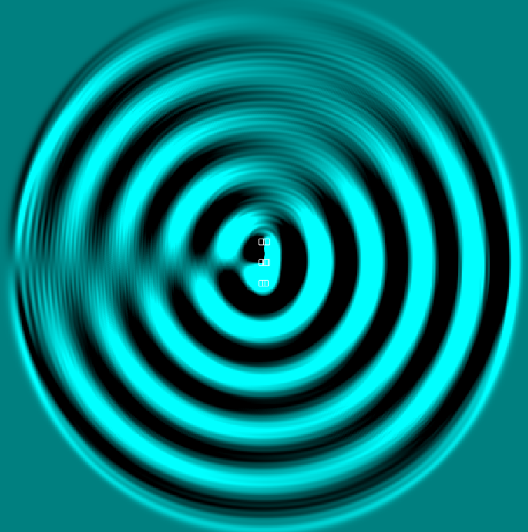

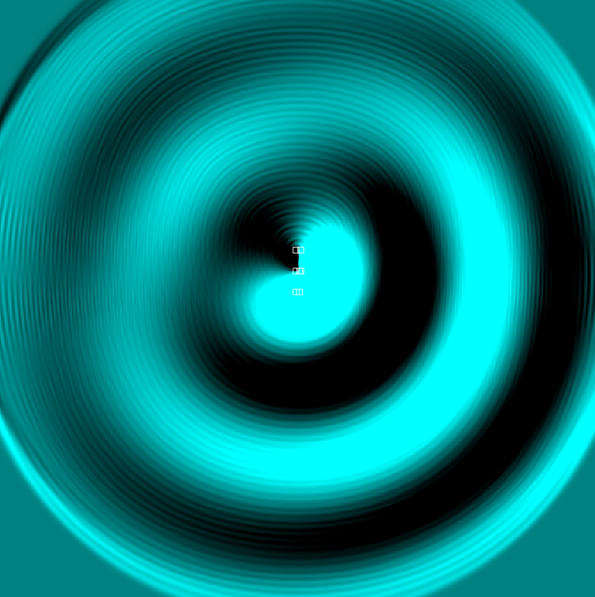

In the ripple tank simulator I've set up four sources, two back to back, upper and lower.
At the start, I've put baffles above and below so you can compare the front and back. Here it is easier to see the way it is configured looking at a higher frequency..
Now, using a lower frequency you can clearly see that the null is becoming significant..
Next, I've removed the baffles so you can see the normal dipole null at the top, and the new null at the left (rear)..
And at lower frequencies..

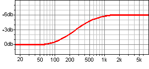

At low frequencies the bipole is no longer bipole but really a monopole, as shown in the lowest pic above.
At the crossover point between a dipole and a monopole the response transitions through a cardioid over a very narrow band when the filter is steeper like LR4, etc. You will not hear this. But the power response will be 4.77dB higher for a monopole compared to a dipole when the on axis SPL is the same, so you might sense that the bass level is that much higher below the crossover point, which should be relatively low, eg. no higher than 100Hz.

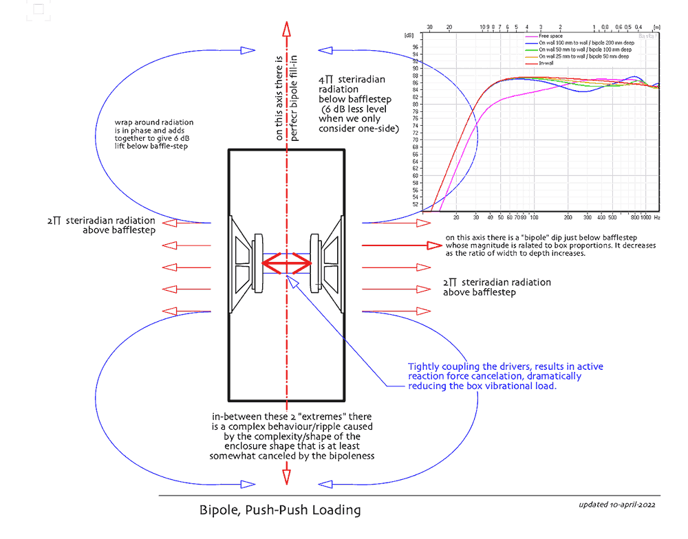

A 2nd driver on the back (sides, top, or bottom) within a quarter-wavelength will act as a single woofer, push-push gives reaction force cancelation greatly reducing vibrational load on the box.

They work mechanically in opposition causing the active force cancelation. They work in harmony acoustically. You get% or more of the potential reaction energy making it to the box.

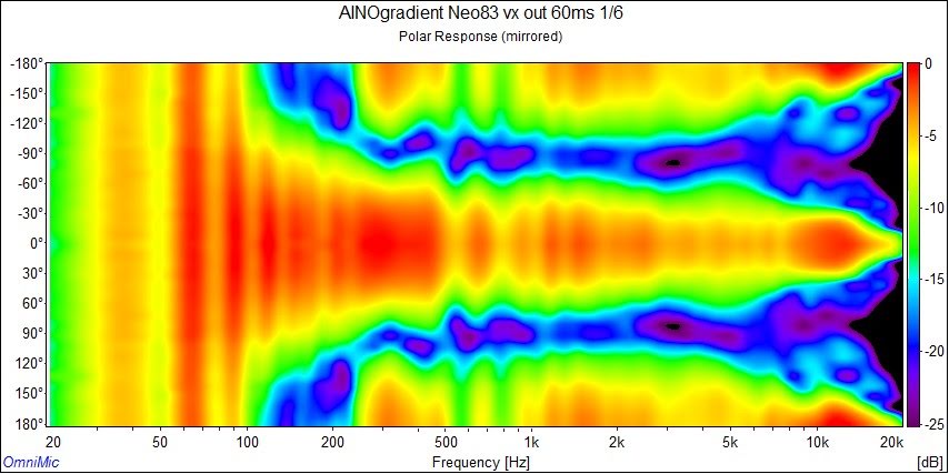

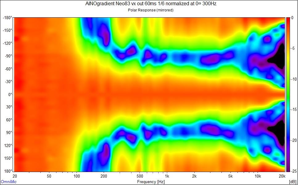

A bipole (sub)woofer radiates as omnipole (like a pulsating ball), until frequency gets too high for opposing waves to match, typically above 500Hz. And a monopole is actually omni too at low freq, before baffle step starts to happen (but we are more used to thinking of axial spl).
When omni and dipole radiation sum around crossover, the net is cardioid. The wideness of this range depends on type and steepness of the crossover.
Here my outdoor-measured dispersion, with 150Hz LR2 crossover, cardioid range is roughly one octave (-6dB)
How does this sound? Pretty good, because sound direction is practically impossible to detect below 300Hz. Major benefit is avoiding front-wall interference, but this happens only if distance and cardioid range match. One can use SBIR calculator to find this correlation. Eg. 500mm distance from the midpoint of the omni to wall gives 172Hz first null.

Like any box. Just that 90% or more (est) of the energy in the box that could cause panel vibration are actively cancelled. It then becomes easy to push anything left way above the bandpass of the woofer. Hence NO box vibration.
Pressure can easily be shown to be only a small source of the energy that can cause panel vibration, and then - because of damping — only at the lowest frequencies where it has its own name — ballooning. Very easily avoided.
Most of the energy loaded into the box material is from the direct connection of the driver to the baffle. In the case of a dipole (OB) that all loads into a falt panel. It is going to be prone to vibrate much more than a wel designed box.
So your argument falls apart since building a vibration free OB is much more difficult than a vibration free box. And in the bass push-push is an easy way to actively eliminate most of energy that would cause box panels to ring.
