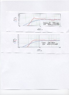

Comments and Additional Modeling of Bipolar MLTL
Much has been written in this thread and I wanted to summarize some recent work that I have done in an attempt to clear any confusion on previous posts. As you recall, I based my bipolar MLTL design on earlier postings by Greg Monfort (GM). Last summer I constructed a set of speakers per his basic design. My speakers and others built per my interpretation of his original design both sound and measure very good. But later questions were raised by Planet 10 (Dave) about the original simulations by GM in Posts #7 and 9 of this thread. The issue revolves around whether GM’s simulations modeled a single driver or two drivers in the enclosure. My goal herein is to report on my findings and modeling of this design with Martin King’s latest spreadsheets. The shortcut takeaway from this recent work is that the design that I built is correct and results in an outstanding speaker for those who wish to build it.
A few words of comments are necessary about modeling bipolar speakers. Martin has not yet released a bipolar worksheet, so some interpretation of bipolar speakers is needed to properly comprehend their resultant performance. Martin’s tools are adequate to predict the performance of a bipolar configuration if the results from a single driver box are appropriately extended to the bipolar configuration. For example, one can build a bipolar speaker with the assumption of two separate single driver speakers enclosures placed back to back. You can extend this assumption by eliminating the back walls of the two single driver boxes so that you have one enclosure which is twice the volume of the single driver box. You also can evolve to one port in this double volume box by using a port which has twice the area as each port in the single driver boxes. Finally, you parallel connect the two drivers, the resultant impedance is half of the original driver’s impedance. Thus the impedance sensitivity change increases the bipolar speaker sensitivity (SPL) by 3 dB vs. the single driver.
As an aside, there is another way to model a bipolar speaker with Martin’s worksheets. This second method is to change the T/S parameters for the driver to create an equivalent driver that has twice the Vas and Sd but half the Re of the single driver. You arrive at the same results with this second methodology once you account for the fact that the bipolar power response SPL increases only 3 dB (the impedance sensitivity change only). Bipoles don’t have the 6 dB SPL increase you would expect from paralleled drivers as their radiation patterns do not overlap—only the 3 dB impedance sensitivity increase results.
For my simulations I used the single driver in the box methodology. All simulations used the same enclosure with changes as noted. The specified FR125S T/S parameters from the CSS website (www.creativesound.ca) were used for this analysis. The enclosure modeled has inside dimensions as follows: line length of 39.5”, the driver located 14” from the top, the port placed at 37” from the top, and a cross sectional area (no taper) of 43.5 sq. in. The port has a radius of 1.5” and a length of 3” while the stuffing density is 0.50 pounds per cubic foot. These dimensions are identical GM’s original design and to the enclosures that I used in the construction of my bipolar MLTL.
For this enclosure the various simulation cases are:
1. Single driver in enclosure volume. This is the design that GM later stated to Planet 10 that he thought he originally modeled. (Again to create a bipolar speaker you would double the cross sectional area (volume of box) and port tube area.) The simulation results for this case yielded a less than ideal SPL response as it exhibited a 5 peak dB (above the baseline SPL) at 50 Hz and 2 dB ripples in the 350-500 Hz area. I have attached a plot (the top plot in the attachment) from Martin’s worksheet to illustrate the SPL vs. frequency performance. Bottom line for this simulation is that the response for one driver in the box does not yield a top notch design. Upon viewing this plot I don’t think these simulation results are what GM really meant to communicate as a suggested design for this MLTL bipolar speaker. Furthermore, for a bipolar version the box volume would need to be doubled to accommodate the second driver.
2. Two drivers in the enclosure volume. To simulate two drivers in the enclosure volume I divided the cross sectional area by half (from 43.5 to 21.75 sq. in. (this halves the enclosure volume) and reduce the port tube area by half (the tube radius reduces to 1.06” from 1.5” to achieve this area reduction) while all of the other parameters remain the same as for the first case. For these values the on axis calculated SPL response is shown in the attachment as the bottom plot. Excellent performance is demonstrated with flatness within +/- 1.5 dB across the band. The low end 3 dB down point is below 45 Hz. The port response shows a dip just below 50 Hz.
The measured data (see my earlier postings in this thread for thumbnails of the measured on-axis response plus near field speaker and port data) match the simulations for the two drivers in the enclosure case. Clearly, the issues raised by Planet 10 were not valid and GM’s recollections of the original design also weren’t correct either. The original design from GM that I used was clearly for two drivers in the enclosure box case and my measurements support this conclusion. Bottom line is that my bipolar design as given on the Planet 10 website as:

Re: Comments and Additional Modeling of Bipolar MLTL
All i did was bring up the point after confirming it with GM... what you built with 2 drivers was his 1st approximation for a single driver, and he expressed some dissapointment that you never contacted him so that he could finish it. That you got lucky & it worked is just a big bonus to the diy community. I feel i have nothing to apologize for -- i was just the messenger -- that you would even take affront i find mysterious.
GM posts hundreds of designs and it is important that people know how to interpret them -- you misinterpreted an unfinished design and that confuses things.

Dave,
I had earlier contact with GM on several different versions of the original design. Viewing his early work it was clear to me that the version that I built was for two drivers in the box based on the CSA of the speaker. I also did a 'resonableness' check by comparing the original design to other MLTL boxes with these same drivers. I don't think luck had anything to do with making the right decisions on this design.
Often people raise a point of contention without valid reasons (modeling, measurements, etc.). That is just idle speculation and not a service to anyone.
I did learn from this experience that it is better to independently verify the design eventhough it may appear that all factors are specified. Both novice and expert builders should measure twice before cutting wood. Bottom line is that this MLTL design is valid and it squeezes the most out of these drivers.
