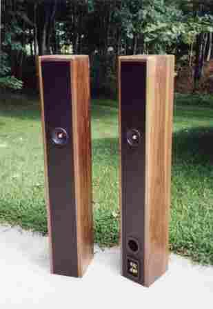

I recently completed a bipolar MLTL using the CSS FR125S as the front driver and the WR125S as the rear driver. The connection of the two drivers in each box is in phase so that a bipolar field (forward and rear radiation) is created.
The box duplicates Greg Monfort's (GM) design that he describes in his posting:
http://www.diyaudio.com/forums/showthread.php?postid=672120#post672120
I built Greg's MLTL design that is the 45 Hz and +/- 1 dB. The drivers are located 14" internally below the top of the box. I lightly stuffed the top of the box (from below the drivers). The port tube is on the rear of the speaker and just above the bottom floor of the MLTL line. The drivers are positioned about 33.25" above the floor. I located the terminal plate in a cavity at the bottom of the enclosure. The cavity spaces the drivers upward to their listening position plus allows room to add mass to stabilize the box. Also any contouring components, if needed, could be located in this cavity.
The enclosure was constructed of 0.75" thick MDF panels for the baffle, rear, and bottom of the box with walnut top and side panels. Internally, three braces are used to stabilize the structure. The outside dimensions of the enclosure are 48" high, 7.5" wide, and 8.75" deep.
The sound of these speakers is very nice indeed with more bass than you would expect from the volume. The four drivers do a nice job in adding low end impact to your music. The frequency response of these drivers is very flat across the band and this design retains this benefit. More important these speakers exhibit the coherent nature that we have come to expect from quality full range drivers without a crossover.
The bipolar drivers in these speakers necessitate that you position them away from the wall--I'm using 3 feet in my room. Their bipolar nature of this speaker does two things that you will notice to your listening. First, you'll notice a little ambiance as sound energy is reflected from the back wall in the room. In this case ambiance is a good thing--more apparent during say a newscast--but with not an issue when you listen to music. Secondly, the soundstage is wider than you'll have with just a single front firing driver. One very minor disadvantage to the bipolar nature of these speakers is that the stereo image is a little more diffuse than with direct firing drivers. In my opinion having a wider sweet spot is an advantage in my book.
The FR125S full range driver does an excellent job across the frequency band and for most music you'll not miss any extra airyness that a separate tweeter might contribute.
Bottom line is that this is a very simple design yet it yields great results. A lot of bang for their cost.
Jim

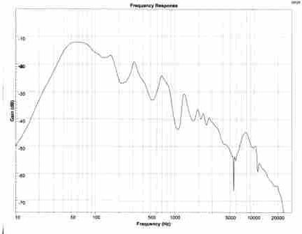

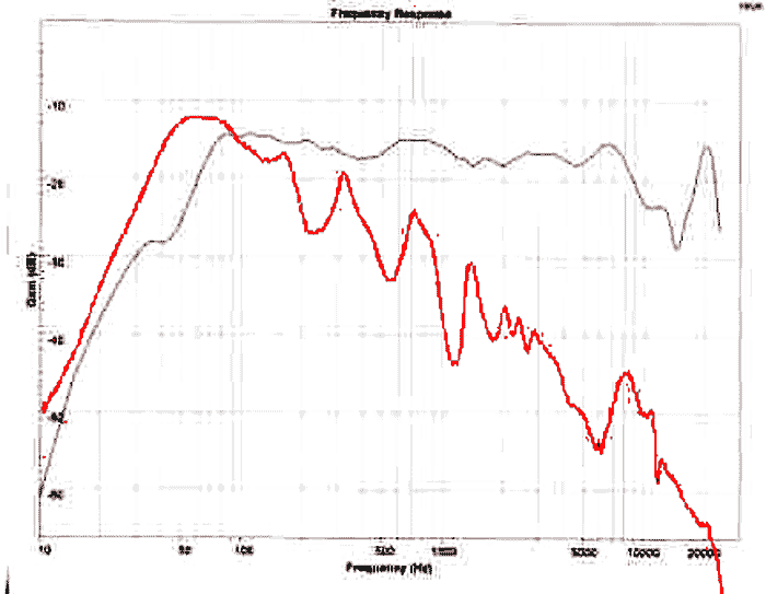

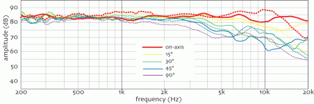

Measurements On Bipolar Speaker (On axis near field plot)
Dave (Planet 10) stated:
"It should be noted that GM's design is for a single driver & Jim has used 2... that Jim's box still turned out well is a testiment to how flexible an ML-TL is."
Let me reply:
From other posts by GM and by comparison to similar designs by others, I believe that GM's cross sectional area and length values are for two drivers. The remaining question is whether his port parameters are for a single or dual driver. Perhaps GM can chime in to clarify his box and port parameters.
Regardless of the above questions, the really question is just how well does this speaker that I built performs and whether the bass response is flat.
I have attached a near field on axis frequency response plot for my speaker. Note that the near field plot is only good up to about 700-1000 Hz so ignore the data above those frequencies. Furthermore, the true low end response of the speaker needs to be combined with near field port data which I will include in the next message in this thread.
The on axis performance plot shows a relatively smooth response within its validity limits. The on-axis data rolls off (starts below 80 Hz) on the low end and shows a dip in its slope below 50 Hz. The near field port data in the next message shows a peak in this same area. The port data will fill-in this on axis dip. Thus, the total response of the speaker is the acoustical combination of the on axis response and port response and it clearly creates performance below 50 Hz.
Bottom line is that this speaker performs very well as built and I would recommend that others would be successful in building it as well.

Jim,
You, me & GM already covered this off by private mail... GM comfirmss that his design is for a single driver. The data you provided at that time shows that it is actually big enuff to support 2 drivers and still give good performance.
dave
One driver or two, I'd call that an excellent response. Looking at it, I don't think you'd get many more benefits from increasing the cross-sectional area. You might get a touch more bass, but the CSS drivers have a relatively high Fs anyway, so I'd be wary about pushing them too hard (though I really do fancy an array with them, or perhaps some similar Tang Bands, rolled off of course).

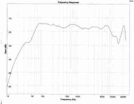

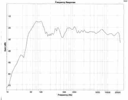

A few comments on the measurements that I posted earlier in this thread. I included a near field on-axis plot which has most validity below 950 Hz for this size driver. This near field data can be combined with the port resonse if a correction based upon the ratio of the port and driver size is made. For the port data from these speakers the correction factor is about -3 dB so the port response should be lowered by this amount before combing with the near field plot.
I have attached a plot of the on-axis in room (actually in my garage) frequency plot measured at 48" distance from one of the speakers. Note that the accuracy of this in-room measurement only extends down to about 300 Hz or so based upon the distance from the speaker and the measurement time window. The near field (corrected with the port data for the very lowest end of the band) and the in-room on-axis data can be spliced in the 300-700 Hz to create a total frequency plot for the speaker. I suspect that the dip about 450 Hz in the on axis room data is due to a bipole cancellation effect (in room interaction between the rear speaker and the front speaker) as it does not show this depth in the near field plot I posted above in this thread. Discounting the dip the overall data from 300 to 20,000 Hz is within a 6 (+/- 3 dB) window. The near field data (accurate below 950 Hz or so) is well within this same 6 dB window.
Overall the data are very impressive for this speaker and supports the listening tests that I have done.
I'll rescan the original measurement plots and send a set to Dave (Planet 10) to review and perhaps post if he sees fit. I regret the poor quality of the attachments but this forum only accepts a small sized file as an attachment.
Jim

Originally posted by Jim Griffin I regret the poor quality of the attachments but this forum only accepts a small sized file as an attachment.
Up to 100k and a 1000 pixels wide. Lots & lots of room for FR plots -- we'll just have to teach you a few photoshop tricks.
Any low colour file such as a FR chart should be saved as a low bit gif (1-4 bits) -- never ever save as a jpg. A jpg is bigger & adds a lot of noise.
For instance the attached file (FR of FR125 & WR125 just to stay on topic) is 5 bits (because of all the colours), is way bigger than most FR plots being posted need be, and is still less than 25k.
dave
