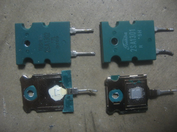

Are there websites, that shows the steps, how I can create/generate accurate SPICE models to verify the values of the manufacturer ?
A second question: Is it possible, that the bad reputation about ON-Semi/Motorola is including because many counterfeits (visual nearly perfect fakes) are on the market (at least by some audio lovers) ?
I have heard about this:
Counterfeit Transistors
and this:
http://www.diyaudio.com/forums/parts/71367-fake-ing-motorola-transistors.html#post810801
and this:
http://www.diyaudio.com/forums/parts/82638-my-transistors-original-copy.html
and I was shocked.
It should be also noted that while some companies make 'copies' - i.e. equivalent devices under license, or near equivalent through joint vo-developement, others make near-equivalents, based in their existing technology and developments thereof. Onsemi MJL parts are precisely this kind of a device, where high beta, low beta droop, and high Ft were attempted to be combined with superior SOA. Those knowledgeable in semi technology will already know that fast devices tend to have worse SOA, so if you want to get the best of all worlds, some things will be optimized - one of them being, what a resonable ft is in audio applications. Of course, one must hope that as a result, you do not get a device which is equally bad in any application, as opposed to equally good 🙂
Very interesting. But it is still hard to say: "Fake or not". Have a look to the various pictures about
http://www.diyaudio.com/forums/solid-state/106919-fakes-toshiba-2n3773-photos.html
and about the weblinks mentioned in my previous post
It gets worse - Toshiba, according to their website, do not make 2SA1302 and complementary... as far as i know, at least 8 years (probably longer). but you can still find them - except that they look a bit odd to anyone who has ever seen the genuine thing. Shops here are very uncritical as to what they order, and fakes are plentiful - some are downright ridiculous. Genuine 2SA1302 have a green plastic case, following the Japanese standard using green plastic for PNP or P-type parts, black for NPN or N-type. This was abandoned for cost savings in the mid to late 80s, which is, amongst other reasons, why Toshiba introduce the 2SA1943/2SC5200, which is essentially the same part with minor tweaks, but both types have a black plastic case.
Regarding the Toshiba 2N3773 - it is HIGHLY improbable Toshiba made them as a part of the regular lineup, but it is possible thay had a remarked version for someone else, that found it's way to the market. It is practically certain that you would not find one with the thick base, and flat cap - Toshiba TO3 never used such a case style, and besides, they have not made anything in TO3 for nearly 2 decades.
That being said, if there is such a thing, as one of the pics suggest, it should have the OLD Toshiba logo (the flowing script letters). It is most likely something like a remarked 2SD555 or similar (hopefully I got the number right...). It should be well over 20 years old, and the TO3 style case they used then invariably had a copper slug on the bottom (can be seen as a roughly mushroom shaped patch inside the circumference of the cap footprint, avoiding the base and emitter pins), and a slightly rounded top surface of the cap.

now, on the technical facts you brought..
first, Ft as a function of current is not useful in the way it is measured
in datasheets, as it s at a FIXED frequency of 1mhz...
one who don t know the thing, would trust that if the Ft is, say
40 mhz at 4A, not only the device will have a beta of 40 at 1Mhz, but also
a gain of unity at 40 mhz..as you know, it s not true, as the MJL dont go over
6 mhz with a gain of unity and a current of 4A , and that s with a 2 R generator impedance , thus reducing to very little the influence of the capacitances..
on the same conditions, the 2SC5200 display 140 MHZ and although, it s
rather optimistic, it s more than an order of magnitude better..
these curves are good for narrow band RF amps designs, not audio design.
what we need as amp designers is also the curve of the bandwith of the device, constant currents and variable frequency, not only the contrary as in these datasheets, wherever they come from...and with realistic impedance source, of course....
reduced DC soa is imho a deliberate choice, as reduction of the silicon
surface reduce stored charges, making the device easier to switch off..
this also can explain why toshiba are way faster..
about the parasistic capacitance, you can expect toshiba devices
to display less values than the typical one displayed on the datasheet..
japanese have not the habit of overstimating their devices ratings...
regards,
wahab
I suspect we have a disagreement about the significance of ft and how it is measured.
BTW, the most important influence on ability to switch off a transistor in a linear application (achievable rate of change of collector current for a given base current being sucked out) is ft. This is why high ft is important in minimizing secondary (dynamic) crossover distortion.
Bob
Bob
i appreciate your patience ,bob, and we re in the process to be fully agree..
what you said is right , and i will add that it s not only the Ft, but
the ability of the device to sustain this Ft at the higher frequency
possible...
what i tried to explain you with my flawed english is that the Ft as
defined by datasheets, is in fact frequency dependent..
for a given current, the bjts have not the same Ft at 1 MHZ and at
5 MHZ....this is where the japanese parts are better than onsemi s :
they sustain their Ft in a wider frequency range....
regards,
wahb
