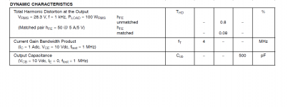

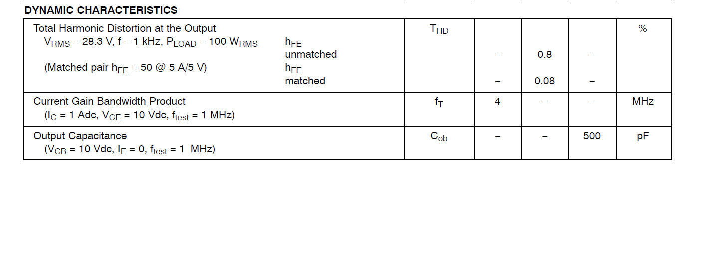

Only the MJL21193/94 specified for THD. 0.08% for 100W/8ohm.
And how about the linearity????
Sajti
Sajti
with no precision about the testing conditions,
this is meaningless...at which quiescent current?...
anyway,onsemi own models doesnt coroborate this..
at this rated output power, wich i presume is
at 1KHZ, toshiba 2SA1943/2SC5200 are clearly better..

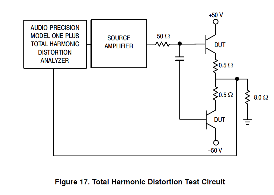

the schematic displayed is pretty unclear...
we know nothing about the quiescent current although it s
a key parameter in output stage THD...
the test is done with a 40 V PP sine, very close to the
supply rail voltage , as the emitter degeneration 0.5r add a
further 2.5 V gap per rail, so the quiescent current you measured
is quite on the range expected for low THD at this level..
with on semi quiet about this parameter, i ll simply check wich current give this figures of distorsion..
so far, the sims i made doesn t agree with on semi unless the current is in the range you measured or even more...the figures are about 0.3% ..
i hadn t had the time to go further for now, but i ll soon check
this deeper...
anyway, although the toshiba 1943/5200 give more odd harmonics, their level
is significantly lower than the ones diplayed by onsemi s 21193/21194...
wahab
