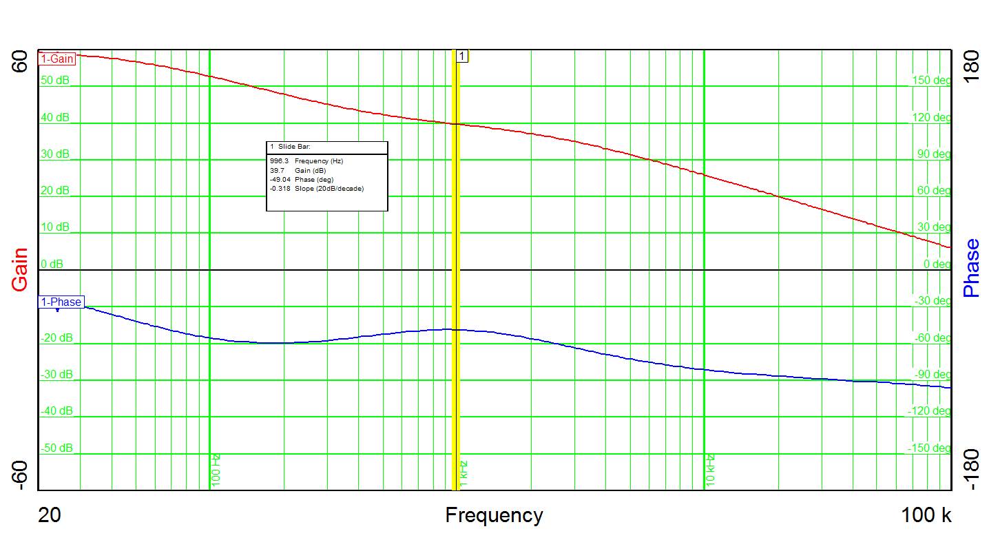

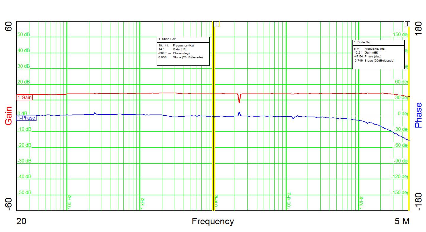

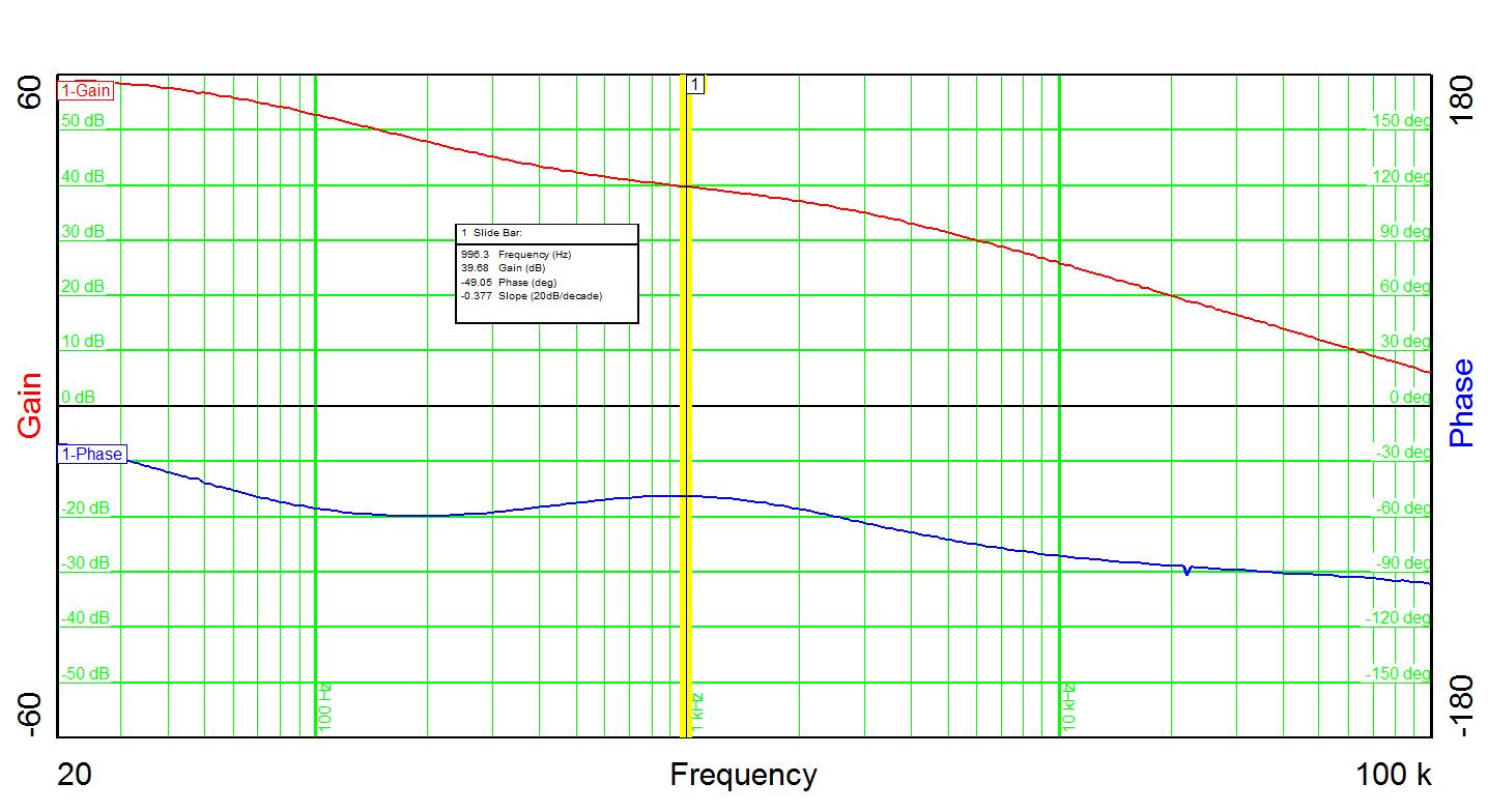

I ran gain-phase scans on the RIAA section this afternoon, and the two channels were well-matched. I tried running the line stages, but got wonky results, probably due to a medium level brain fart. I'll try again next weekend...
Brain fart corrected - will run gain-phase and square wave response on line amp in the near future.

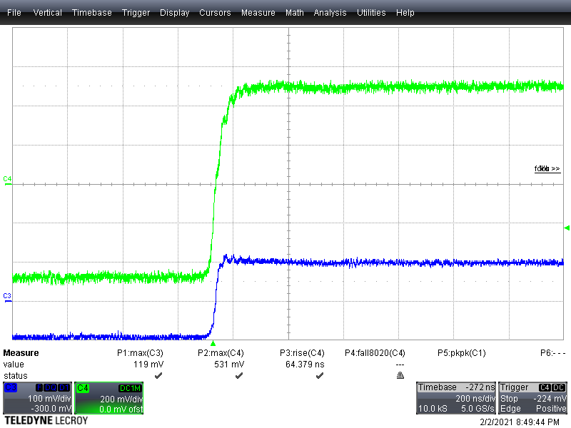

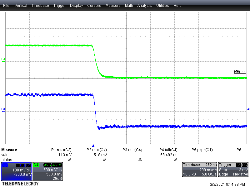

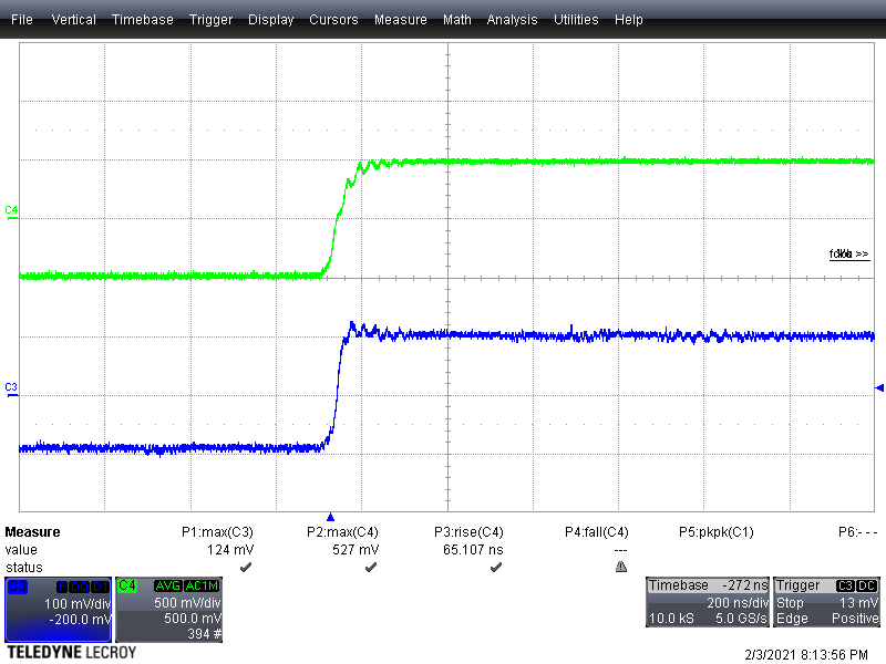

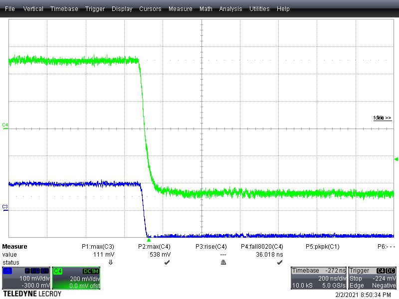

I'm very curious as to how the square wave response of the line amp will look. The simulations show a very fast and well-damped response with minimal compensation, but sims don't necessarily tell the whole story.

I have another layout going that fixes issues with the current one and adds a few other needed touches. One thing I might add is some RF filtering to both the RIAA and line amp inputs, since they are too fast for their own good. I may also adjust compensation to slow things down a bit. The layout also adds the surface mount SOT-223 option for the output Darlington in each gain cell, specifically the FZT/PZTA64.

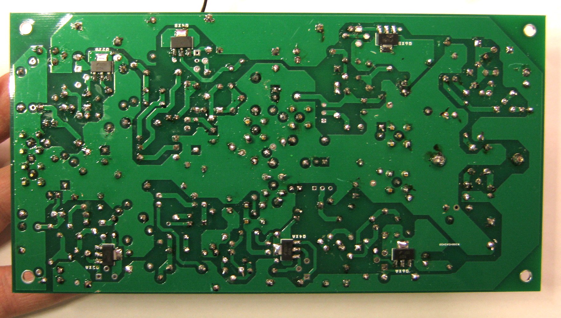

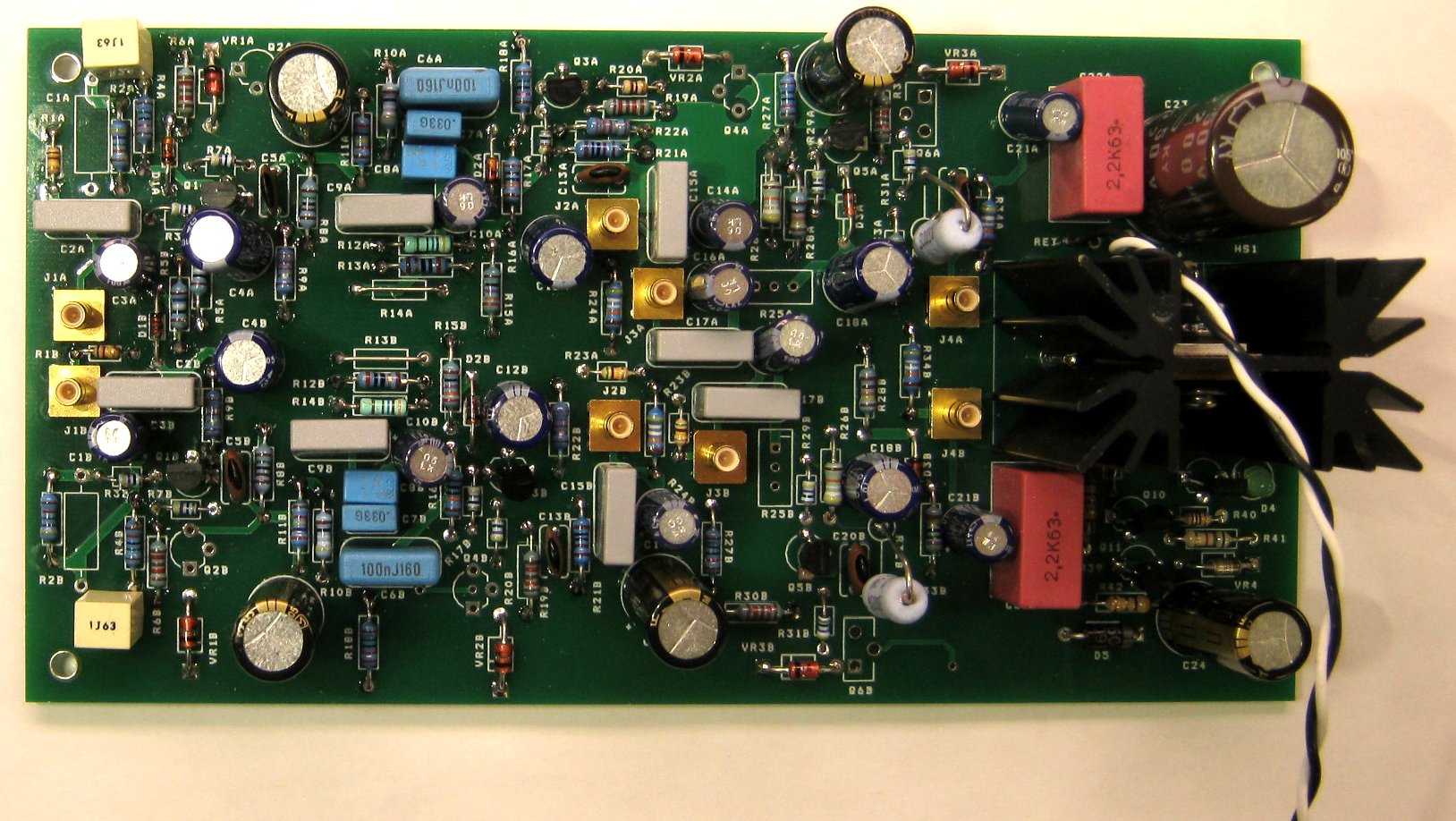

Front and back pictures of the Rev2 board. I chose to populate the back side SMT Darlingtons (FZTA64) to see if there was sufficient copper area for heat sinking. This is especially important with the line amp, which runs with a lot of Class A bias.

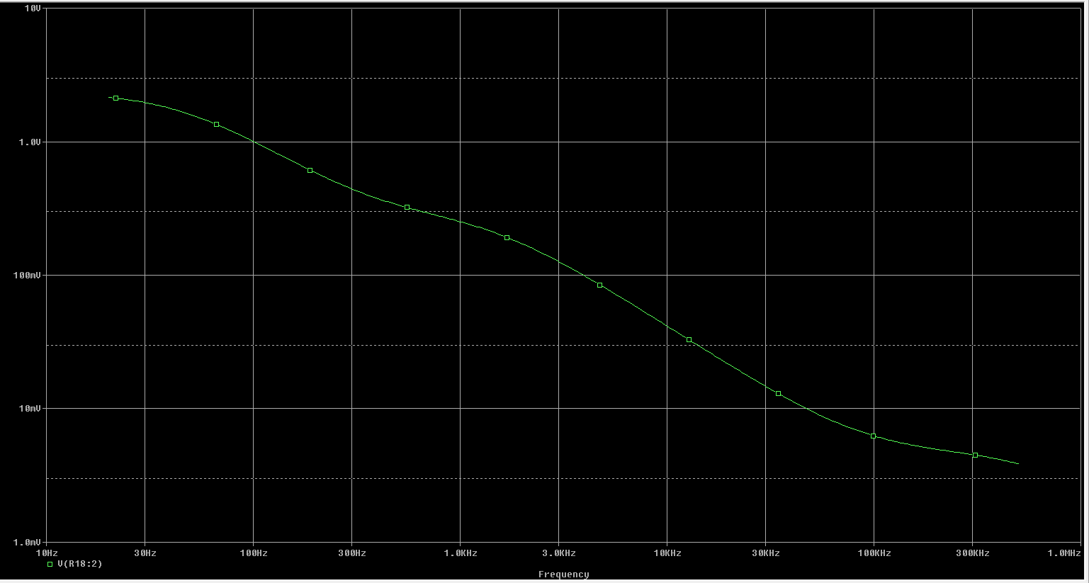

I got results on the gain-phase analyzer that did not look like the standard RIAA curve. This is puzzling, as both gain blocks check out fine in simulation. I'll be looking into the values for the passive filter - a bit non-standard, as I'm using a 100k resistor to bias the 2nd stage, so the first 2 resistors feeding the passive filter need to accommodate this. More later....
One thing I note is that your input stages biasing is sensitive to hfe, I'd check the Q1A/B have the expected base voltage and is actually working in the active region.I got results on the gain-phase analyzer that did not look like the standard RIAA curve. This is puzzling, as both gain blocks check out fine in simulation. I'll be looking into the values for the passive filter - a bit non-standard, as I'm using a 100k resistor to bias the 2nd stage, so the first 2 resistors feeding the passive filter need to accommodate this. More later....
