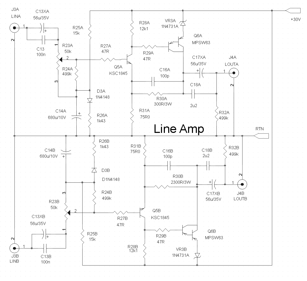

I'm finally going to fire up the finished preamp for some characterization by the gain-phase analyzer over the weekend. One thing I might consider doing is to use a 2nd transistor thermally coupled to the input transistor on each gain block for bias thermal compensation, rather than the separate diode currently used.
I got results on the gain-phase analyzer that did not look like the standard RIAA curve. This is puzzling, as both gain blocks check out fine in simulation. I'll be looking into the values for the passive filter - a bit non-standard, as I'm using a 100k resistor to bias the 2nd stage, so the first 2 resistors feeding the passive filter need to accommodate this. More later....

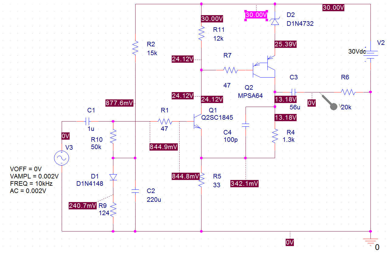

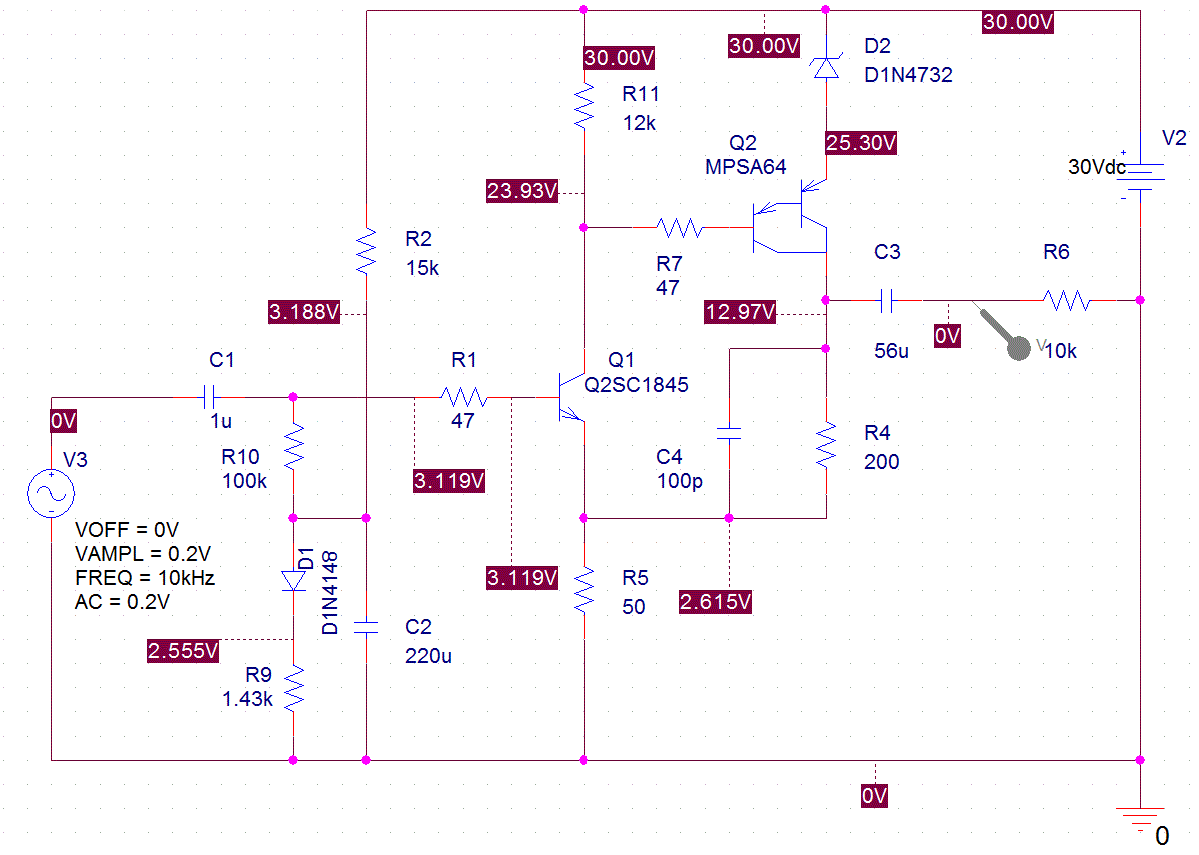

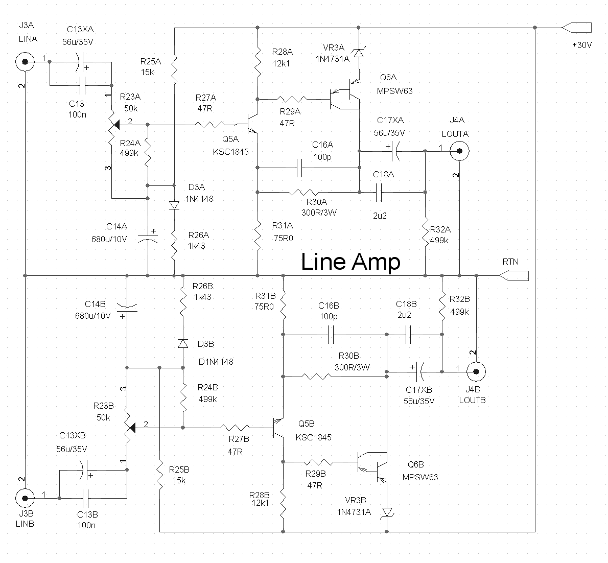

One thing I note is that your input stages biasing is sensitive to hfe, I'd check the Q1A/B have the expected base voltage and is actually working in the active region.
And no decoupling across the zeners D3/D6 worries me - zeners can be extremely noisy. Perhaps a pair of series LEDs might be worth considering.
I have laid out a new board utilizing split feedback-based RIAA EQ, with pots to set the bias levels on the RIAA and line gain blocks. I may change these for a 2-pin header to be able to plug in a pot to set a fixed resistor for bias. I'm also using diode-connected transistors thermally coupled to each input transistor for bias stabilization. Instead of using zeners for level shifting in the Darlington output stage, I'm using two series GaAsP red LEDs. The boards have just finished fab in Shenzen, and I should be getting them in a few days. The split EQ scheme simulates nicely - I'd like to see similar behavior for the actual circuit.
