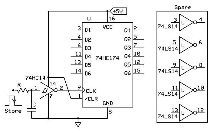

I think I found a better solution for my needs. Attached is the basic ADC circuit which can directly drive R-2R attenuator through its parallel outputs. Just hook up the wiper of a linear pot to Vin pin while connecting the pot between supply and GND and you are good to go. The advantages are circuit simplicity, no need for expensive switch, and volume knob would actually indicate the volume setting which is not so trivial to achieve with rotary encoder. Internal clock can be made slow enough not to contaminate the system with EMI. I would need to provide a reset pulse after power on instead of the switch for automatic ADC start. I guess a simple flip-flop fed by RC delay networks on its inputs with slightly different delay times would provide a reset pulse. Or maybe I can just use a timer IC like 555 for this.
Oleg
