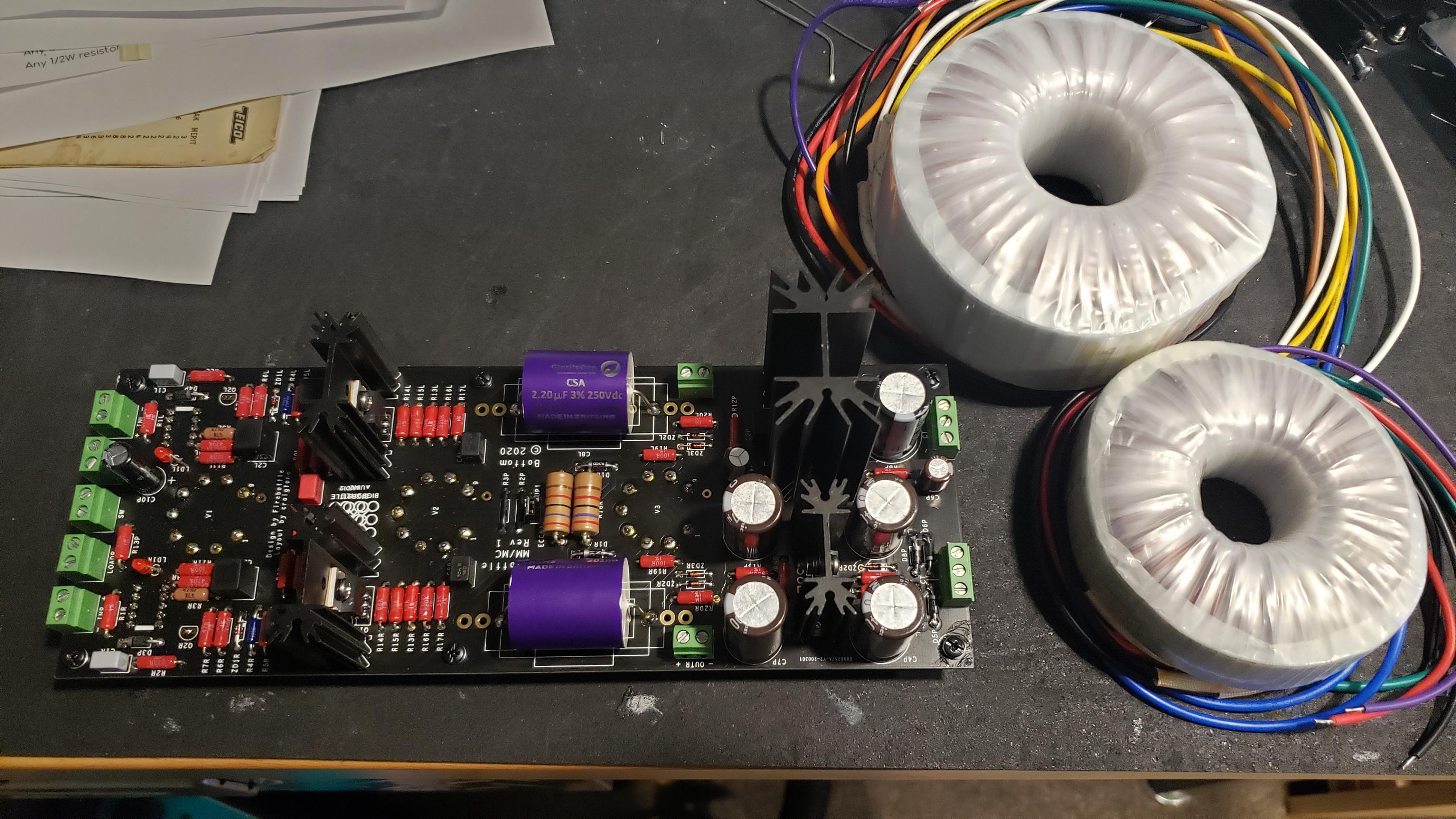

Crap.. I seem to be missing one of the 47uF caps I ordered. I have some 150uF / 350V caps though. Would it be a bad idea to use one of these in place of one of the 47uF caps? If it's okay to use, would it be better to use in C7P or C8P location?
I assume also we need to use isolating washers and mica between IC's and heatsinks? I don't think I saw that info anywhere.
Found the 47uF cap.. Anyways, it's all soldered now. I did end up soldering in the components for MC operation after all.
I also used larger heatsinks just to help with cooling. I'm putting it in a chassis that can accommodate the extra height of the really tall one.
I've also wired it with the 2 1N4148 diodes (reverse to zener polarity) and wire jumpers on R2P & R3P as was instructed earlier in the thread for use with 6DJ8 tubes.
I went with some relatively cheap ClarityCap CSA caps, PRP resistors, and all 10,000 hour 105C Nichicon electrolytics.
You can also see the hilariously oversized Antek transformers I plan to use.

No problem. Once built measure the voltage on the first HT capacitor, anything up to 250V DC is OK. If higher let me know and I'll calculate the required resistor.
Alright, fired it up for the first time. My heater voltages seem good (6.4V).
But I guess I'm high on the HT. I measured 257.5V at the first HT cap.
I measured everything else as well, and I think the voltages might be a bit high as well..
Also, the LED's don't light up when I power things up.
V1:
1 - 111.5V
3 - 2.7V
6 - 113V
8 - 2.8V
V2:
1 - 152V
3 - 0.8V
6 - 142V
8 - 0.88V
V3:
1 - 244V
3 - 155V
6 - 244V
8 - 145V

Leds will only light up if you switch it into MM mode.
