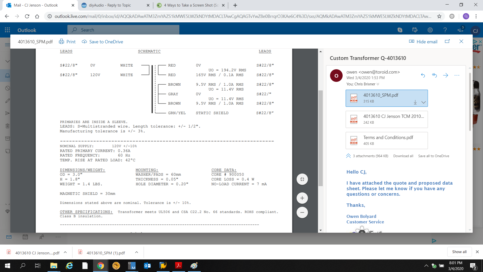

Hey thanks for the reply, I didn't really think it was needed but figured I would inquire. Ill more then likely just get an filtered IEC socket with a switch and fuse to simplify things.

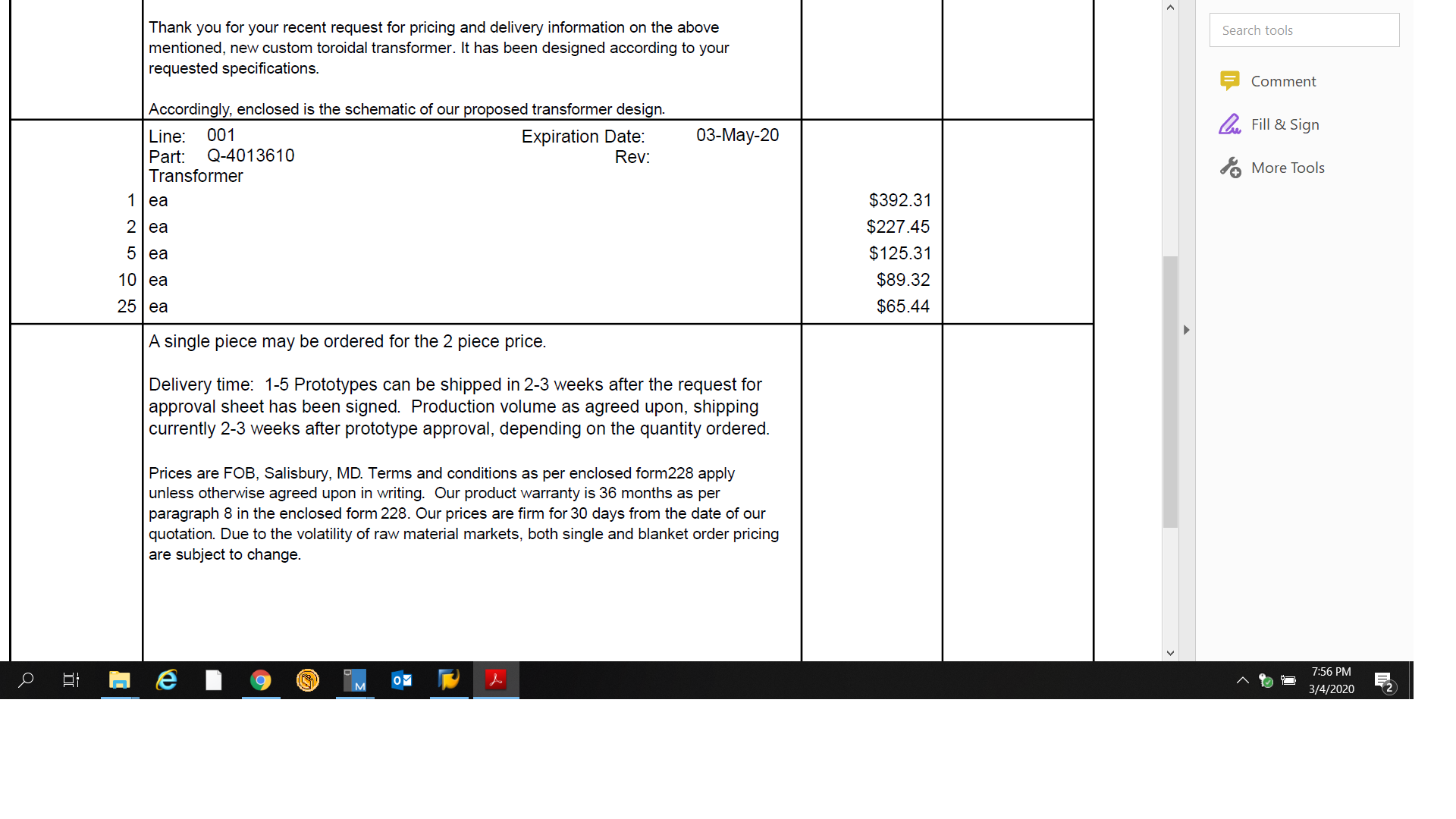

I just got a quote from Toroid Transformers in the US, pretty pricey for just one trans, Ill keep hunting!
I have attached the quote from them and also the trans info they gave me from the specs provided in the thread, all seem correct? I always like to get a second set of eyes to go over something like this.
Also if someone has an alternative for transformers in the US let me know, I did see a few mentioned a couple of pages back but was trying to find something state side.

The first quote is totally crazy. I can have the correct toroid custom wound here in South Africa for R600 ($40.) They are smoking their socks. What is the part number for the Newark trafo and what is the asking price, AAMOI?

Give Heyboer a call. Not toroid but will build to spec and cost less than off-the-shelf Hammonds. I just had them make me a custom PT and choke for a 2A3 amp designed in Japan with Tango iron. IIRC, the PT was $120 and the choke $40 ... now granted that was for a quantity of 2 each! 😛

Yeah that price for one is crazy, gets better the more you buy. They seemed like a promising trans. Nothing from Newark just got a message back from them stating they dont offer that style/type. $40 or so is what I am hoping to spend on one.
I will do that thanks!
