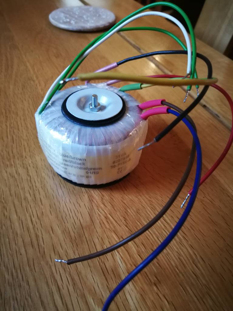

Hi chaps , found you! 🙂 Where did you get your tranny from Oliver?
Cheers Andy
Hi Andy!
Audiophonics have a custom transformer service. Be aware that it took them nearly 6 weeks to deliver mine.
