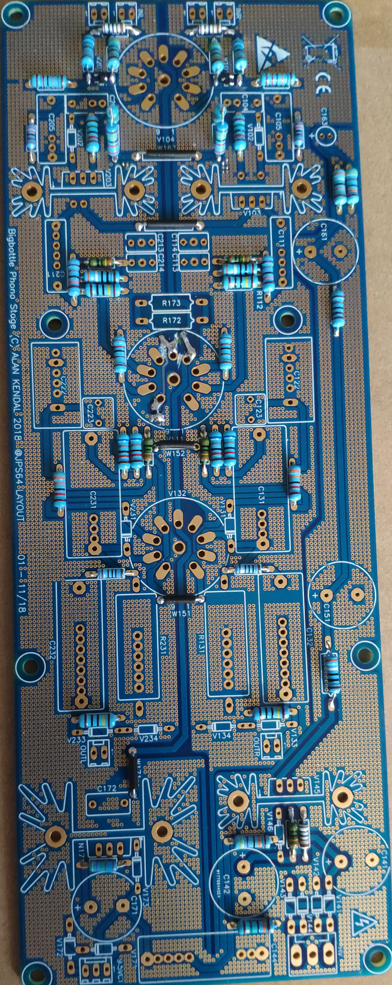

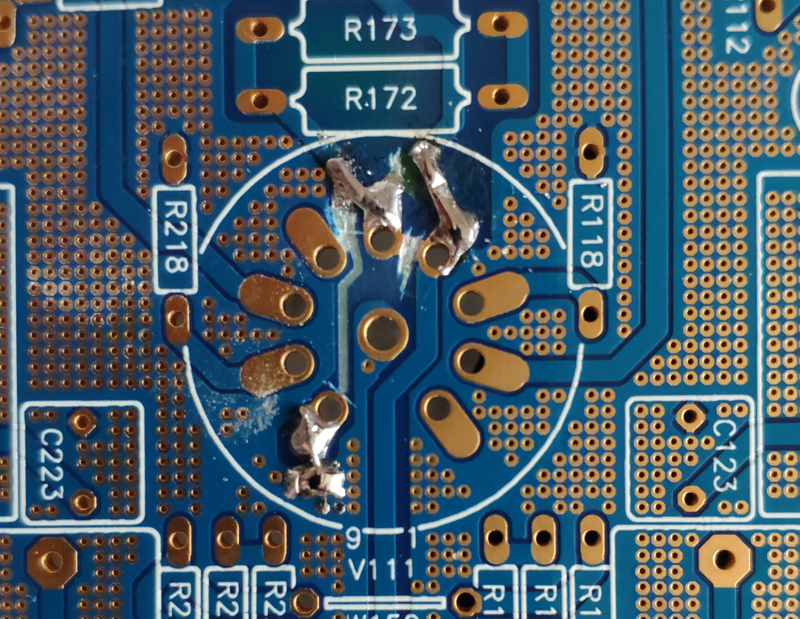

First thing is to get the board to fit your supply of tubes🙂
Cut a few traces and resoldered nw connections, to get V-111 to accept filament 6.3 volts between pin 4 & 5.

After you mount the tube sockets, one will hardly notice 😀

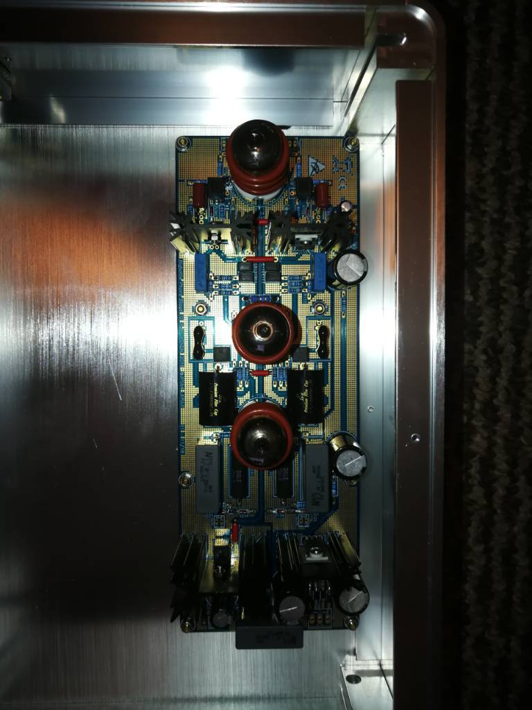

I´m going to use 2 NIB/NOS Matsushita-National 7DJ8 and 1 Tesla 6N2P-EV (just because I have a box with close to 50 pcs of the Tesla´s)😎

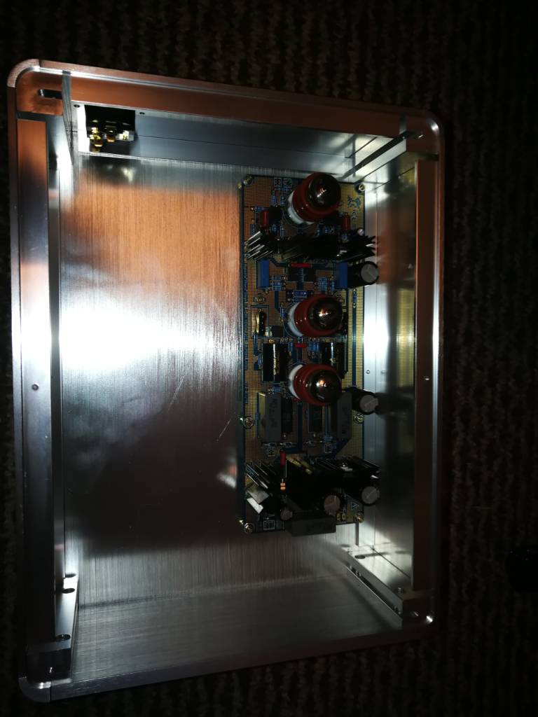

BF862´s, wirelinks & most resistors done 🙂
Lovely! It's nice to see this. Thank you for the pics!
