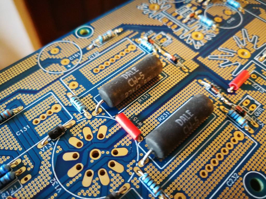

Managed to get a bit more done but now I am out of parts!!
Really nice quality bits on the BOM but I have gone for Dale in the 27K 5W position.
I am also going to change the capacitor to a JB in the C131/231 position. The one in the BOM is possibly still too big for the allocated space. I will need to re-measure the space or try and find a better sized capacitor.
Some pics!
Some pics!
BTW, if any of those guys building this have any suggestions for alternative components, let us all know.
I am happy to improve the quality!!
