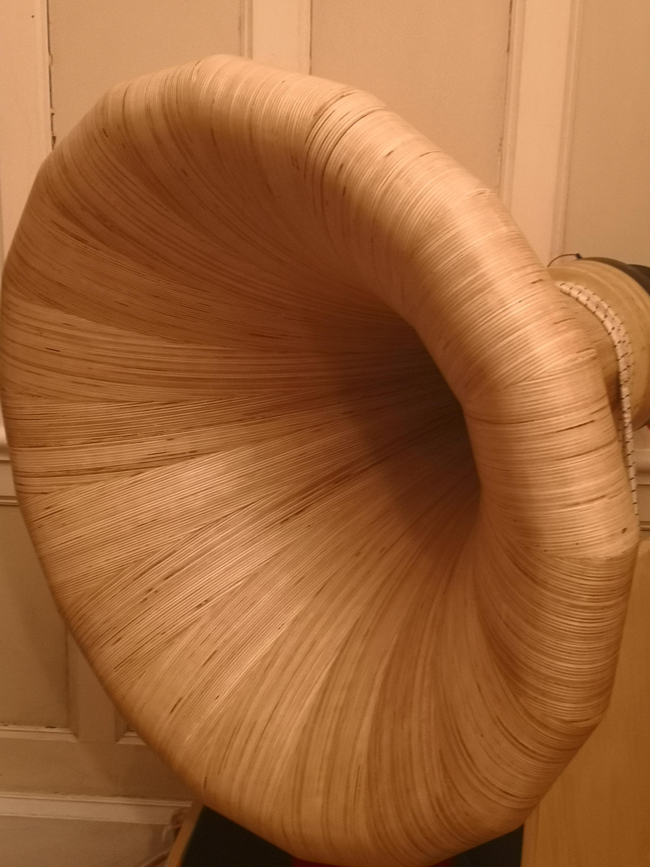

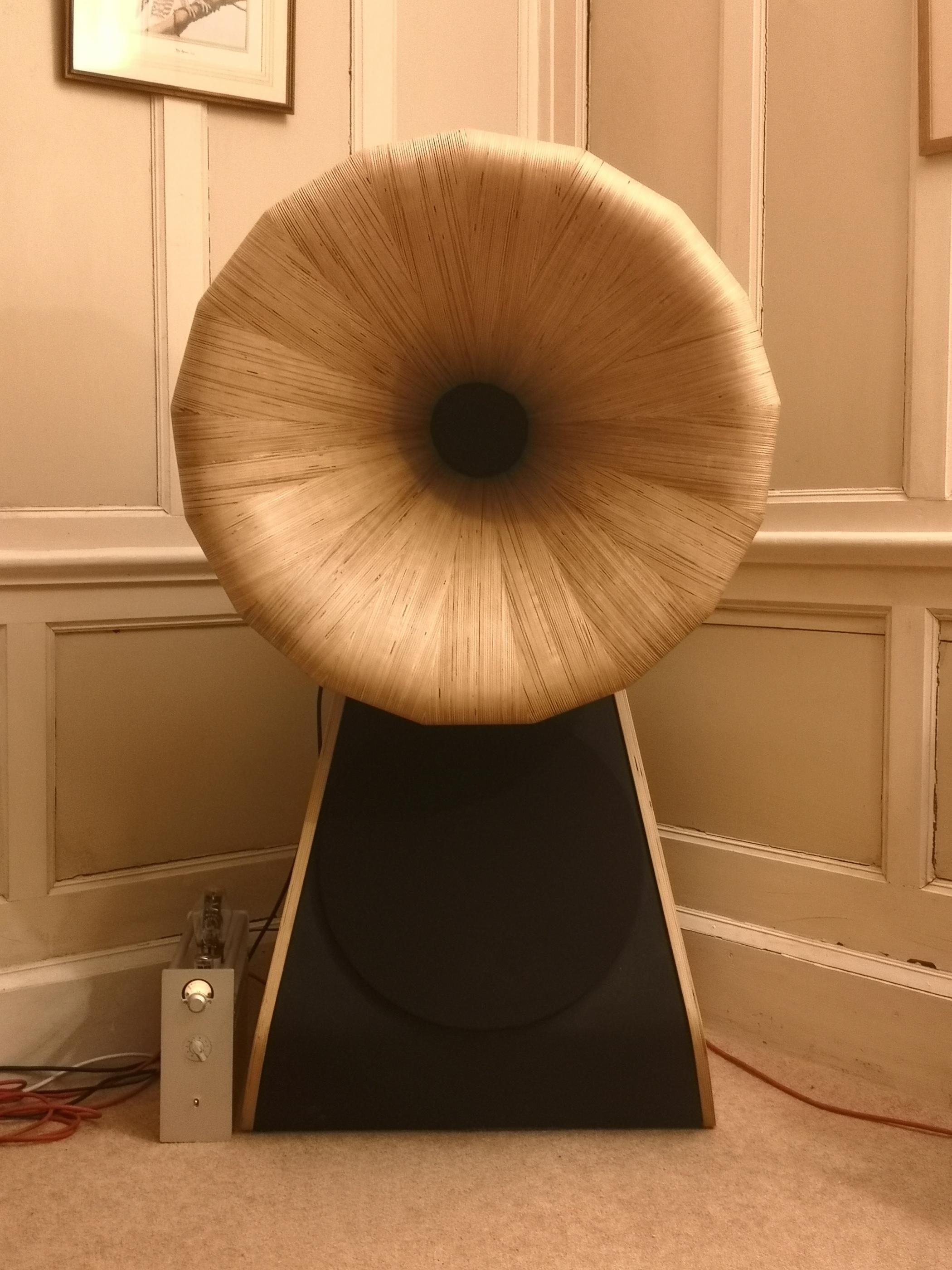

After realising that 90% of my listening if of pre-1930's recordings I made up this - which gives lots of pleasure!
142hz hybrid-horn with Axi2050 and a sealed bass 18FH500.
The horn driven by a 300b amp with Nickel OPT and is loaded from 200hz and is pretty flat to about 15khz. I use a WARM tube EQ and adjust freely for each recording. The bass is driven by a Behringer NX3000D which adds the delay to meet the treble horn.
This also functions as a centre speaker in a 3 way stereo system.

That's a great horn system. I've heard wonderful things about the Axi2050 driver. How do you like it?
Well, it's going to take a while to explore what it's capable of - there aren't not many drivers around that can go as low. My hunch is that the 200-800 range is really fantastic. But I'll need to try them on different horns etc.
There are very few that I know of certainly. I'm excited to hear your thoughts on the Axi250, I didn't even realize it was publicly available.

That is a very beautiful hornspeaker. In my limited experience of building horns, the bigger the better. Even in mono they can sound very three dimensional. I have found that not pushing them too much with excessive eq gives a sound which is less tireless on the ear.
