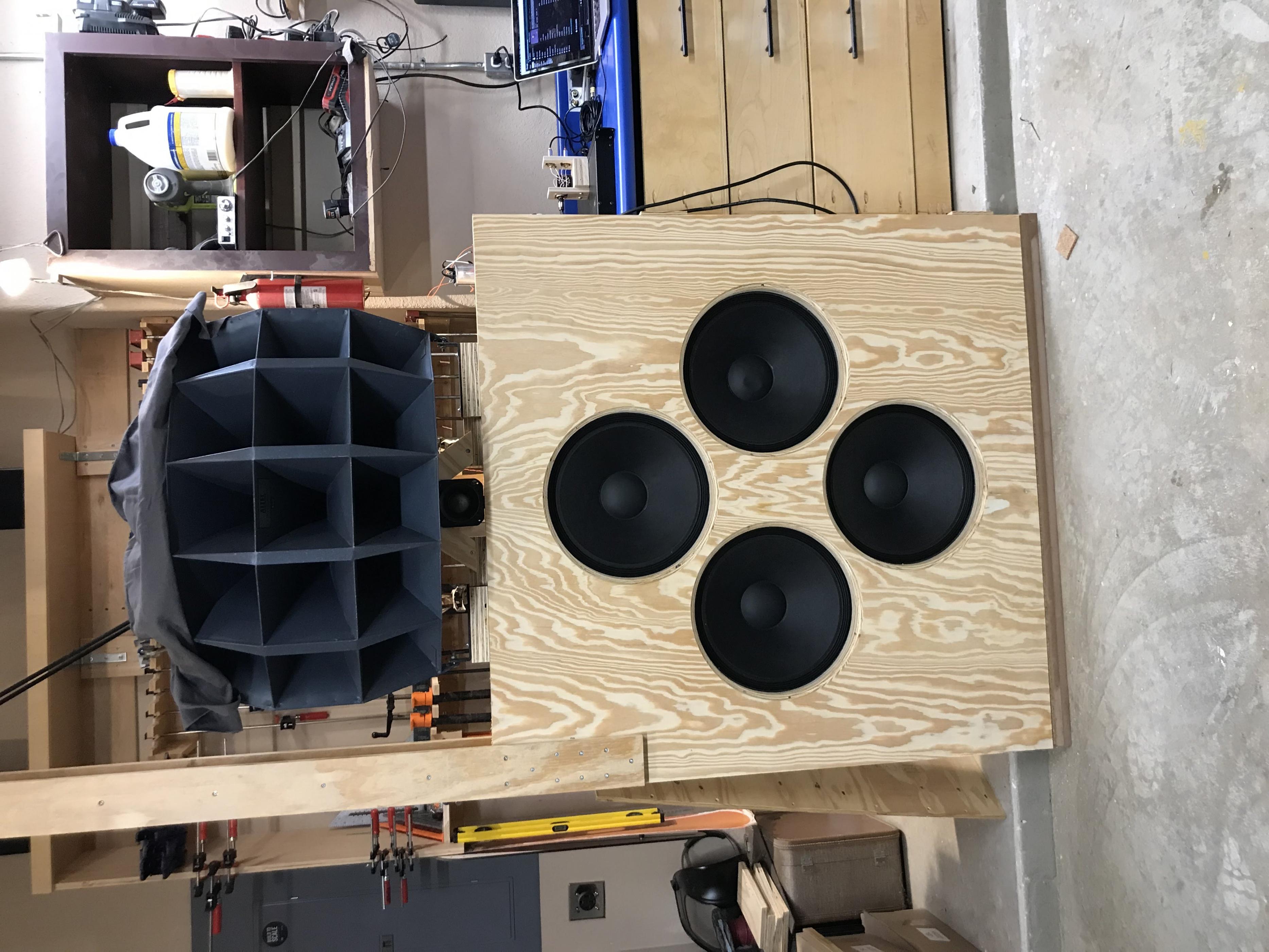

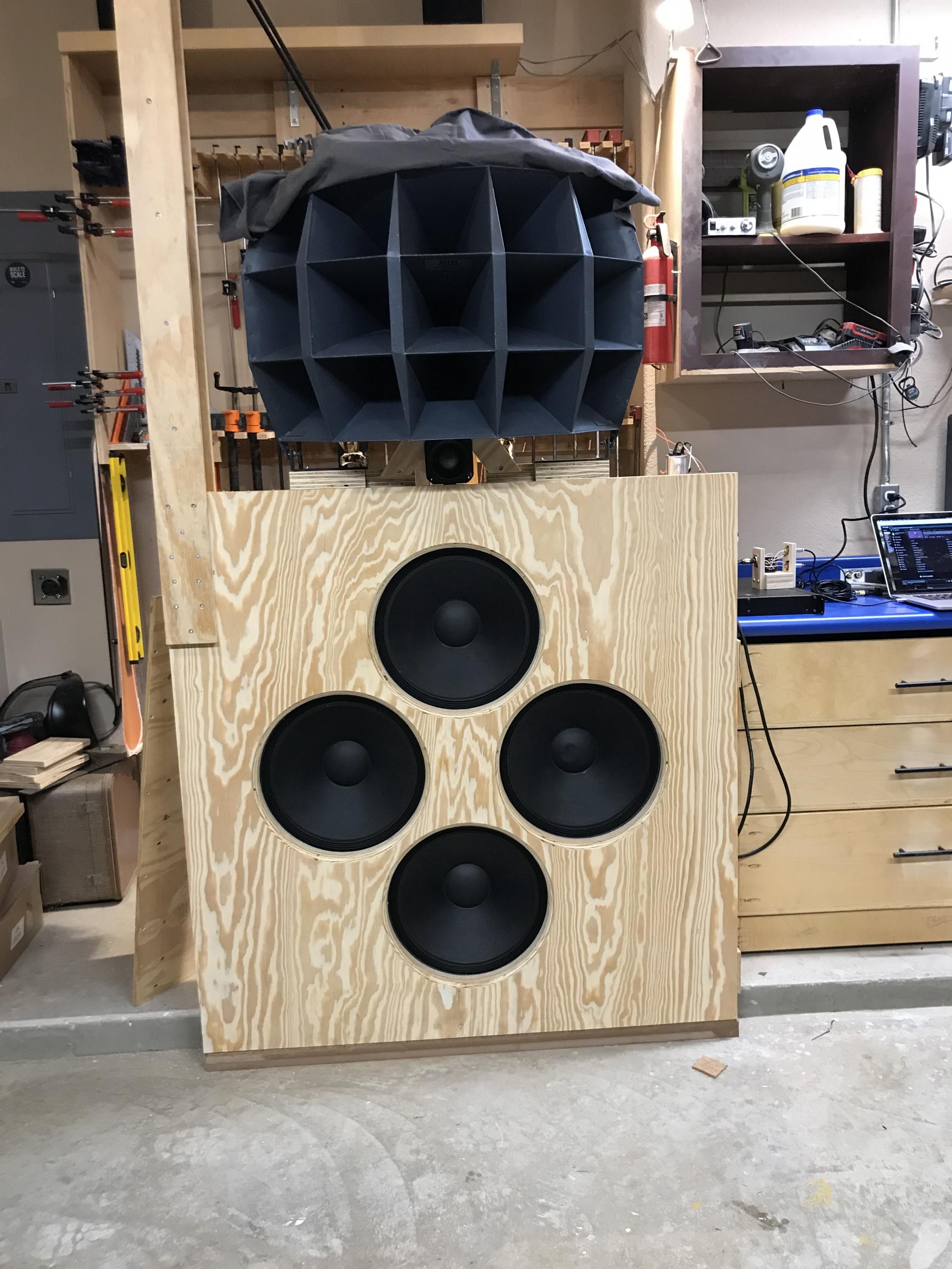

Something like you're using: horn/bass bin 2-way (1505s, though, wow!) or something in the corner is what I'm gravitating to now.

After realising that 90% of my listening if of pre-1930's recordings I made up this - which gives lots of pleasure!
142hz hybrid-horn with Axi2050 and a sealed bass 18FH500.
The horn driven by a 300b amp with Nickel OPT and is loaded from 200hz and is pretty flat to about 15khz. I use a WARM tube EQ and adjust freely for each recording. The bass is driven by a Behringer NX3000D which adds the delay to meet the treble horn.
This also functions as a centre speaker in a 3 way stereo system.

That's a great horn system. I've heard wonderful things about the Axi2050 driver. How do you like it?
Well, it's going to take a while to explore what it's capable of - there aren't not many drivers around that can go as low. My hunch is that the 200-800 range is really fantastic. But I'll need to try them on different horns etc.
There are very few that I know of certainly. I'm excited to hear your thoughts on the Axi250, I didn't even realize it was publicly available.
